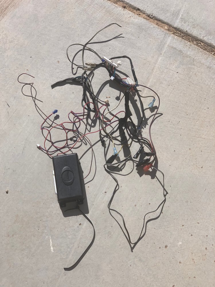

I already had the lower section of the steering column removed to get rid of this disaster of an alarm system uninstalled:

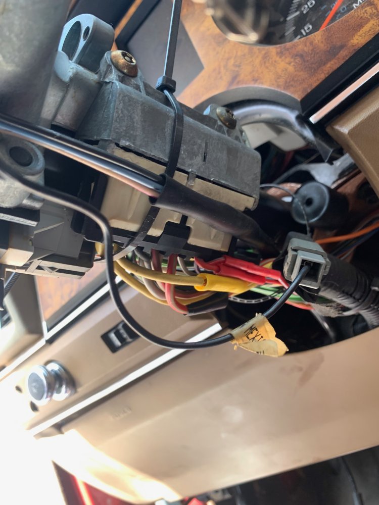

Apparently it was grounding out and killing the battery, and had been zip tied at the base of the steering column and actually prevented the lower molding from fully seating.
Borderline exasperated at the failure to start (which has been an ongoing issue, just inconsistent) I was sitting side-saddle on the floor (since the interior is gutted) and when I got up to check for leaks, my hand hit the steering column and the car stalled out...
Looking underneath the steering column there was clearly a number of previously spliced/butted wire connections, no doubt from the alarm install. For laughs, I squeezed the wires and tried to start it again...it started right up on the first crank.
It reminded me of a previous test drive when I took it through the desert for a quick rip and noticed the dash warning lights flashing before it stalled out. It took a number of attempts before it finally started. I discovered the battery ground was loose and ASSumed it was the culprit.
Upon further inspection it wasn't individual wire(s) that were loose/shorting; it was the actually harness that was rocking out of the terminal end. Clamping the the harness together with the terminal end bolted to the steering wheel (with the two Torx security screws in the picture) I started and stopped the engine a half dozen on so times before assuming that was the solution, and it clearly was. I didn't have rugged zip ties available, but once I zipped tied it together the intermittent failure to start...stopped. Checkmate!

Good catch on the ignition switch coming apart. It's actually a common problem on older Rangers.
@RobbieD well even the sun shines on a dog's backside some days! I was just lucky that I still had the steering column trim pieces removed and I mistakenly hit it when getting out of the vehicle, otherwise I'd still be chasing my tail!
My '84 did that, too. Temporary fixed it with a tie-strap. Later, when I went to "replace" or "fix" it, I pushed the plastic terminal block back fully into the pot metal housing, and re-bent the retaining "fingers" on the end of the housing back in place. I added a new tie-strap as a backup, and it's worked fine going on 13 years now.
