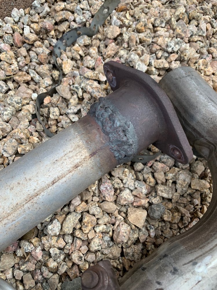

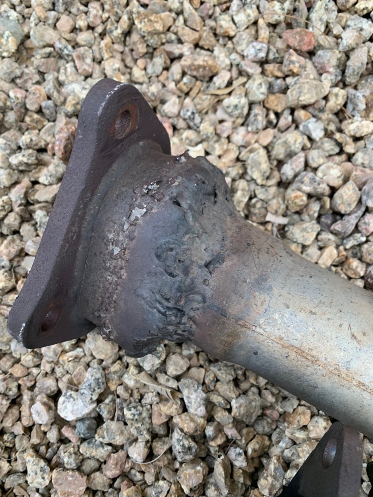

Decided to tackle the exhaust on Saturday and get rid of the janky azz cat delete and Cherry Bomb muffler which looked, sounded and smelled like HAWT garbage:

Anyone's whose done this knows where the cat goes into the down pipe is the most challenging part of the install, and it was just a matter of contorting and getting the right size tools in there to get the hardware in/out. The 11 o'clock bolt is a lil tough, the 1 o'clock bolt is a pain in the arse...especially when ALL of the hardware (3 bolts on the cat to downpipe flange and 2 bolts to the muffler) were different...! Standard instead of flanged bolts made it even more trying and a total of 3 trips were required to O'Reilly's to get the right size/length bolts. The only other issue was the muffler side of the converter had a 1/4-inch of of pipe sticking out past the flange and it was identical in size (2 1/4) to the inlet of the muffler so it didn't nest inside of it like the downpipe did...so I had to Sawz-all that off and smooth it out with the grinder before I got in position under the truck:
I also decided to put in a new O2 sensor while I was at it, which was pretty easy with everything removed. While I had previously noted the rubber hangers for the front of the tailpipe I did NOT see that the rearmost one was not so another trip to O'Reilly's was in order, fortunately it's both (1) right around the corner from my house and (2) they've given me my own parking spot I've been there so much lately!
So it ended up being a solid half day to get the exhaust knocked out, slowed down by the 3 trips to the parts store and having to cut the proud outlet end of the converter. Not bad and as close to bolt on as I think you're gonna get. The moment of truth was realized immediately after it's first startup after the installation was done. It was DEAD quiet with NO smell and although I didn't have the rearmost hanger on yet, it was rattle free. Still idling nicely right around 850 RPM with little to no surging, etc. The wife (and I'm sure my neighbors!) was very pleased as we both agreed it was mandatory. Best of all I was all in for this for under $400...you can't beat that for an entire exhaust system including a brand new converter!

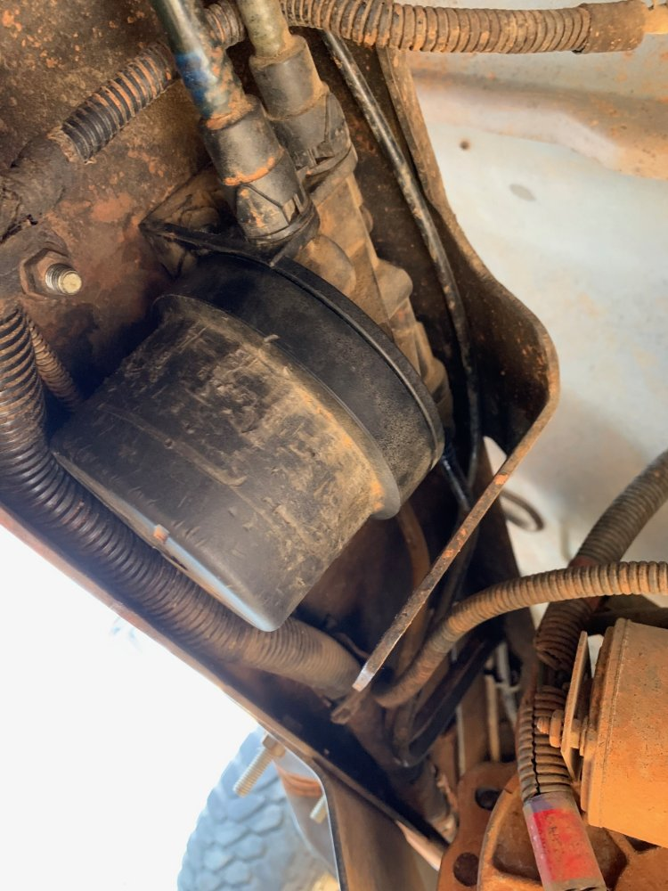

Today was supposed to be the fuel system and for some Gawd forsaken reason, when I saw this on my frame rail I just HAD to futz with it...
I hadn't seen this discussed anywhere and was rather perplexed quite frankly as to exactly what the hell it was doing on my truck...and there HAD to be a filter in there too of course.
This is aft of the frame rail mounted high pressure pump and I apparently had a Ford diesel flashback and decided to wrench the obvious filter housing off...
*cue long, awkward silence...
HUGE mistake...at least temporarily. It was VERY difficult to get off, which should have been my first clue. My second clue was that when I got it off...there was no filter in it...? WTF?! I end up going down a Google search deep dive, including one related picture and linked thread to the FTE that was titled along the lines of "what's this black plastic filter looking thingy". From what I was able to determine it was used in mid/late 80s and early 90s E/F/Broncos...earlier ones with filters, later ones without and that it was a fuel reservoir. Unless I REALLY missed something (which wouldn't surprise me) I hadn't seen this mentioned in any of the Bronco II fuel related threads I looked at with the exception of a Russian gentleman with an '88 Bronco II like myself who was likewise questioning what the heck he was looking at. Now I was pooping chickens, reading that it should not be serviced/disassembled, it's fragile, breaks, leaks, etc.
I didn't have to check my pulse to know it was getting elevated; first step was to undo what I did and it was almost as difficult to get it back on as off. I snugged it up with a filter wrench and held my breath as I started the motor. It started up but I didn't even have to looked underneath to see that it immediately started leaking. I thought I had tightened it up pretty good and double checked and got another fraction of an inch tighter. Tested it again and it was still leaking.
DEEP breath. I decided to take it off and troubleshoot it. Reading several applicable threads from FTE I noted one gentleman specifically mentioned the O-ring and leaking. Checked the filter/reservoir housing...no O-ring; checked where it screwed into the fitting to see if it was stuck...no O-ring. I knew, or at least hoped I knew it was going to be before I looked...and there it was, sitting on top of drain pan. I place the O-ring into its recess and it was definitely a lil stretched/out of round but some grease there and on the threads (making sure NOT to get any in the actual reservoir/housing) and it goes on quite a bit easier and I could feel it snug down on the O-ring and felt it was good to go before starting it again and checking for leaks...
SUCCESS! Now at this point I'm more than halfway through my day and haven't made any progress outside of installing the last exhaust hanger and getting the system aligned, which is chapping my backside, so I decided to change the frame mounted fuel filter as that would be "easiest"...
My use of quotes denotes sarcasm of course, and while my new filter had two new fuel line clips, I definitely struggled to get them off my old one, despite having the right tool(s) and watching a couple of YouTube videos of course. My sleeve caught more fuel than my drain pain did but I finally managed to get the clips off and the filter off after what seemed like an hour of fighting with it. Having the benefit of removing the old one now under my belt, the new one went in in literally minutes.
Now for a moment of truth; small as it may be. As I was still cranking the motor which wouldn't turn over I looked over to the passenger foot well and saw that I hadn't plugged the fuel pump inertia switch back in. I laughed at myself, plugged it in and fired it up. It settled into a nice idle quickly and I took entirely too much time to insure there were no leaks in either the "fuel bowl reservoir" (or whatever the hell it is!) and the filter. Good to go, pick/clean up and dinner time!

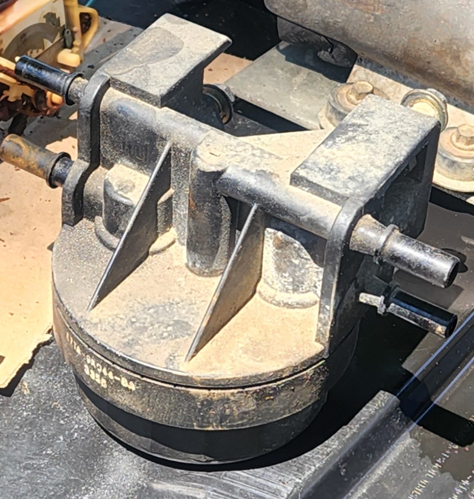

Something just hit me with the differences in these fuel reservoirs... on whether they have a filter inside or not. I think the first clue is if they have a high pressure in line filter between the high pressure frame rail pump and the fuel rail... there probably isn't a filter in the reservoir. I'm not sure that is always 100% the case.
What I did notice is there appears there are some differences in the reservoir itself. Below is @Peter Griffin photo of his reservoir... it looks deeper then the one I took off my 86 Bronco II... it also has a smooth outer surface around the bottom.
This is the one I took off mine. It appears shorter in depth and also has some finger well holds around the bottom.
@lil_Blue_Ford maybe you can find that part I gave you and do a better picture and maybe you both can measure the well depth. Then perhaps we can do a tech article to better describe the differences.
Interesting, I didn’t catch that. I’ll have to dig out that one I got from you. I know there’s one on my 88, I’ll have to take a closer look at that too, think it might be the deeper style. Might take me a little bit to get to, so someone may have to remind me. Looking like we are going to get 3-4 decent days here before it drops below 40* again so I’m thinking I want to work like crazy on the Ranger and see if I can get it on its wheels and running before the temps drop again, trying not to get into any side quests until the Ranger is done right now. I’m not afraid to take the one in the 88 apart at some point if indeed it is the deeper style. Could even probably shoot some video. Just take me a bit to get to that, maybe a couple weeks and a warm enough day that I don’t have to worry about how cold the plastic is while I wrench on it.
