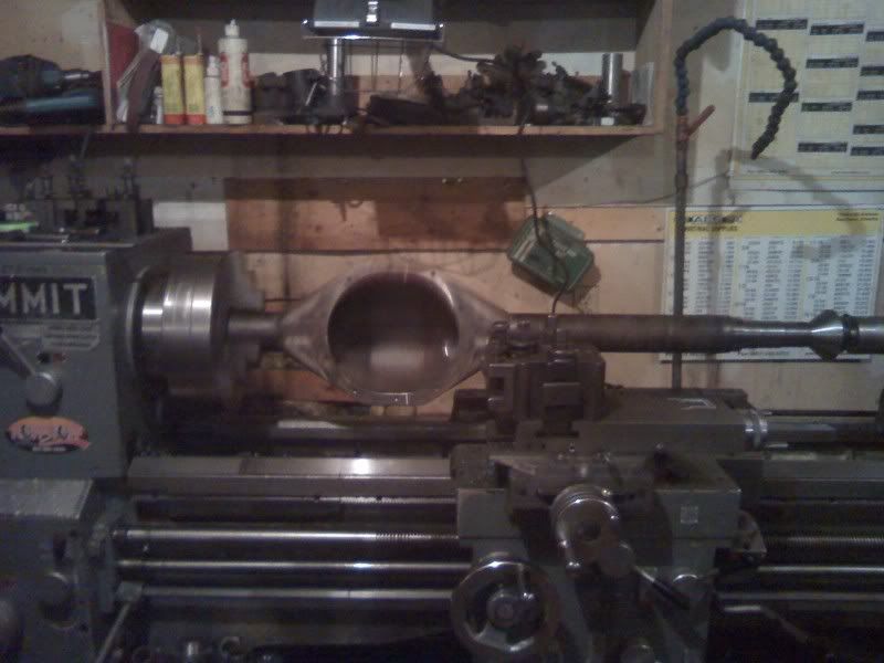

Finally getting somewhere....
Spidertrax 9" housings, THESE are the ones I have.
Rear is done, just gotta tack it down to the bench and start workin on the truss....
Front should be done by next weekend! Damn 3 1/8" D60 tubes causing me grief!

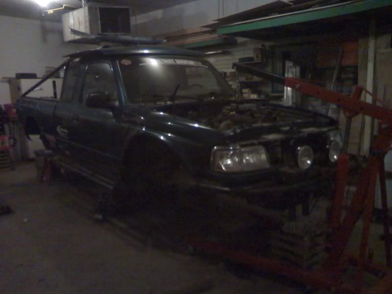

Pulling the tranny with 25" under the frame rails.... EASY!
Pulling the engine with the hood at 5'.... Not so much!
I had to use the engine hoist to lower the front of the truck down enough to get the engine out, then it'll go back up to ride height to get the suspension fabbed.
And yes... the shop needs more light.... I usually have 2 big dual 500watt work lights goin.
