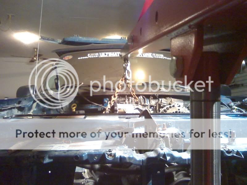

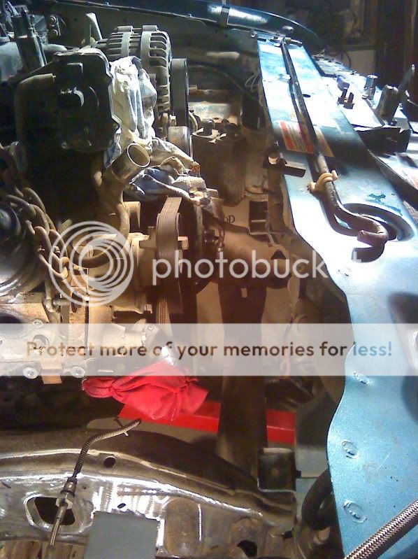

Hood Clearance - LQ4 intake and pan.... goin with car pan to get room in tranny tunnel

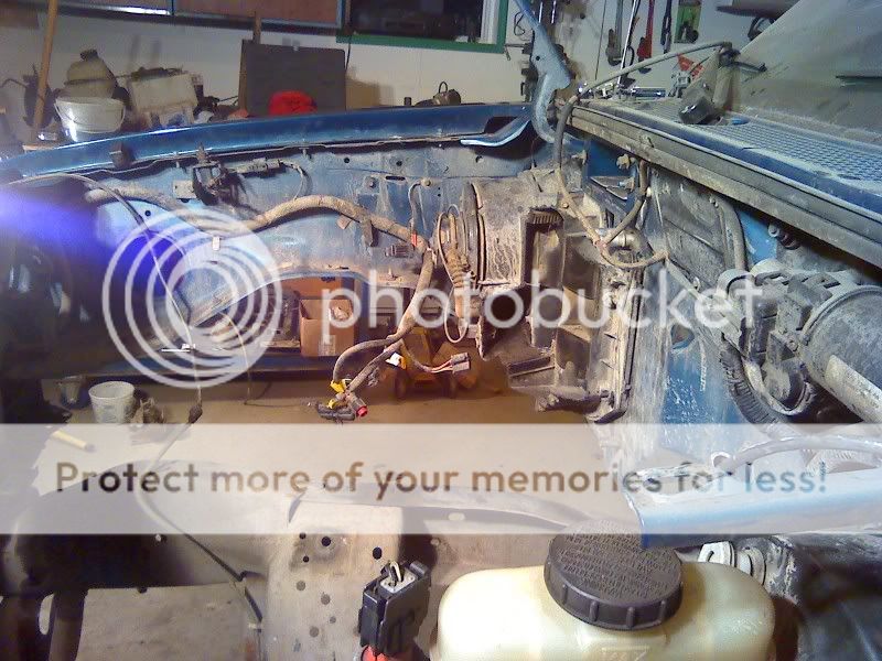

Heater Box trimming.... gotta glass/plastic weld it in

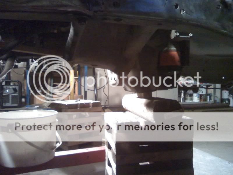

LQ4 oilpan with 1" between pan and crossmember

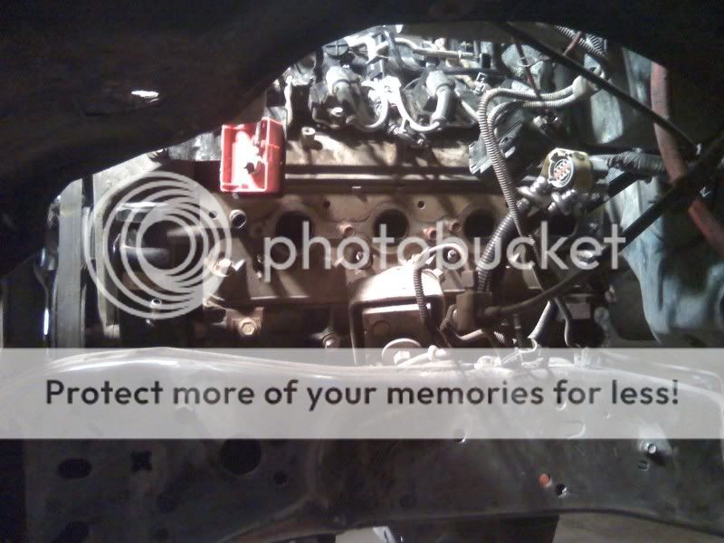

Driver side engine view

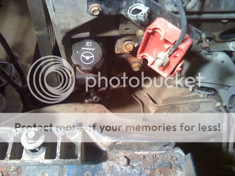

LACK of steering box room....
Firewall clearance, smaller pan and notched upper intake should gimme all the room I need!

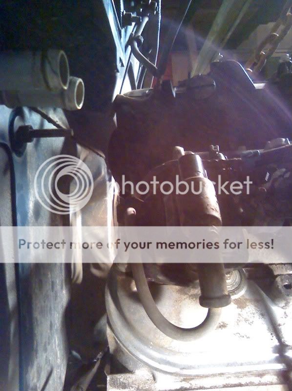

Passenger side frame rail view
Clearance to header panel
After I get the frame all cleaned up/plated and drop the engine back in I'll grab my video camera and do a walk around for you guys to give a better idea of the clearances and how it fits.
thanks for the pics bud.
What made you want to stick with the LQ4 intake over the LS1/6 intake? Its a shit ton shorter.
Looks like we are going to have to move the radiator towards the header panel more. Are you going to use a stock radiator or go custom? I take it you are going dual electric fans as well?
Also, are you building your own crossmember or keeping the Ranger one?
Swapping a car intake would involve swapping all the front accessories ($$$) and parts would be a lot less common. Griffin makes wicked custom sized aluminum rads and a buddy just got one for his buggy with dual elec. fans for $550 shipped to his door so thats the route I'll probably take.
So far I have the stock crossmember, with no reason to change it unless I can't get an oil pan to fit nicer (lower) in which case I may have to take a little bit out of the center and drop it enough to get the tranny to clear the tunnel nicely. Even right now it's only a few hits with a sledge away from fitting, so lowering it an inch via. oil pan should give me all the clearance I need.

Cost is a factor... I'm still under 2k on this build from where it was before! Cheapest vette setup I could find was over $700, and with the truck stuff parts are everywhere. There's also no guarentee I can fit the stock steering box with the vette stuff so toyota steering box it is!
Tight fit but doable. I had to hack the heater box like you to fit the SOHC engine. The Griffin rad is an awesome choice. Buddy at work ordered a Griffin for his '32 Ford. Thing is almost a work of art.
