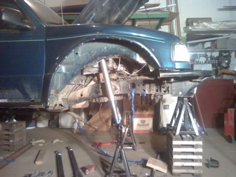

Not huge.... just reliable, and with a lot more umph. I plan on making it no taller then when you saw it on U.A. and have it runnin 40" rubber. Airshocks should be around next week, just gotta pick up some DOM for the hoops.
I will be VERY interested in what the street manners and your tuning issues are with your air shocks. I just put a set on the front of my dune buggy and found that they can be a bit difficult to tune and wonder how they would react on road.
My airshocks are wrestling with my coolant and washer fluid resevoir for space..... oh, and the hood too.....
Just a loose mockup where they fit for now....
ill put $5 on the airshocks lol
random idea.... relocating the resevoirs to the outside of the inner fender, under the prerunner fender and running hoses with caps through the inner fender....we'll see how it goes.
Second plan, getting a car pan for the 6.0L.... it's fighting the hood too, and I still need an engine cage in there! Shoulda done a B/L years ago....
