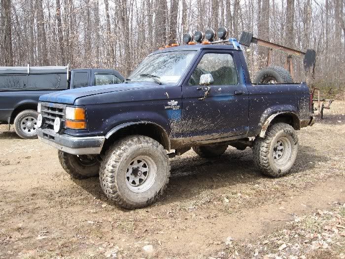

Then dad gave me some old bias-ply tires he had for winter tires for his F-150. Since they were in good shape with no evident dry rot and the size worked out to be a 33x12.50.....
I also did a custom rear leaf pack since one of the spring eyes were cracked on the original springs. I modified a set of Explorer leafs by cutting the spring eyes off a main leaf and placing it below the main on the Explorer pack plus fitting in another leaf.
But that didn't last long at all, probably my shortest-lived modification....
Belltech drop shackles and F-150 spring perches came along.... I also got a member (RedneckWelder) to fab me up some extended radius arms and mounts.
So now I had around 5" of lift and 33's....

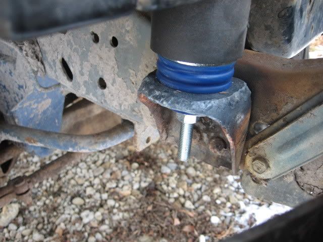

Since the body mount bushings were pretty well toasted.... I bought new poly ones from Duff. And at the time I did, they had their body lifts on sale (a pretty good deal too), so I figured that it was worth the money for the bolts. I don't care much for body lifts, so I went with the 2" kit. After putting it on, I was happy I did, it made things much easier to reach to work on, but I'm not sure that I'd do a 3" body lift unless I absolutely had to. 1-2" is enough to make life easier.
A good buddy of mine who lived up around the one college I went to came down for a weekend to help me with the body lift as well.
First time welding - old school oxy-acet work, and yes, I used the proper welding rod.

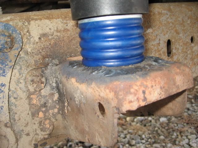

Second weld. Yea, I had to patch two of the frame mounts since they were rusted through.
And done.

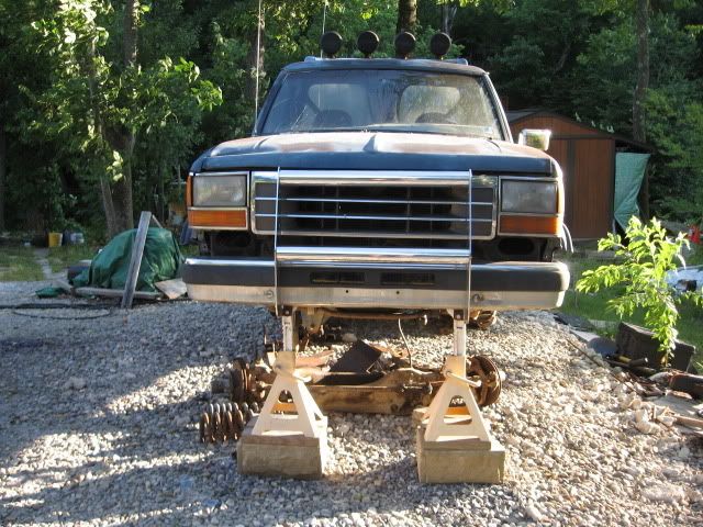

I had picked up a D-35 for really cheap awhile back out of a 93 Explorer. It sat around and collected rust till I tracked down a 4.10 geared center chunk for it. Then it sat some more till I collected the parts to do this right.
Once I'm done with my D-35 upgrade, I'm going to jump right into fitting a roll cage in it since it needs a new windshield and I figure while the windshield is out, that would be the time for the cage....
And it's getting bigger tires....

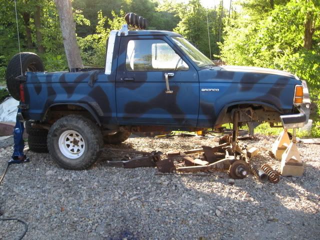

And I have another change that I picked up parts for, but that is going to be delayed because I would really like to drive this thing again before winter gets here, I've been wasting enough warm weather time working on the D-35 swap and cage.
New goodies....
Hmm.... looks like I got some repair work to do....
Looks kind of silly like that....

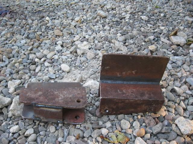

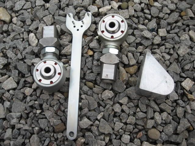

New frame brackets for the extended arms...

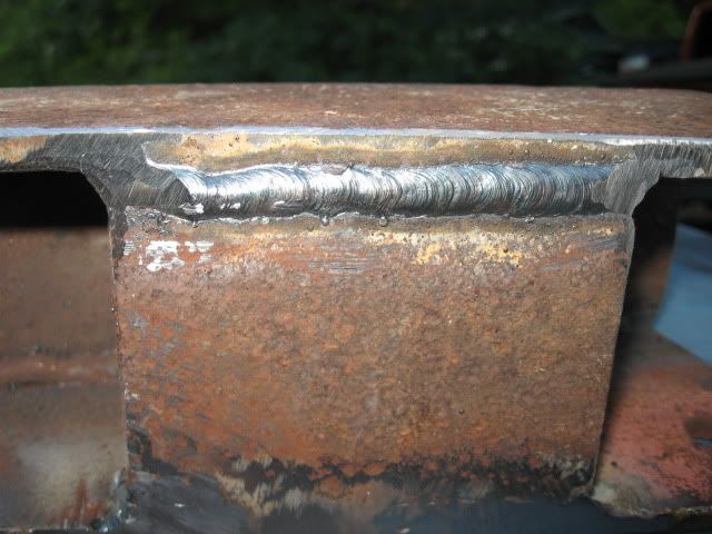

Showing off one of my stick welds. They're not always that pretty, but they're getting there. Most of my welds have been ground or are not really going to be seen, but I decided to leave one mostly untouched. I've been grinding a number of them for fit or finish (I know, everyone says you shouldn't grind them), but I have faith that even ground the welds are good and solid (and most of the more critical welds have an untouched weld on the backside where it's not really seen).

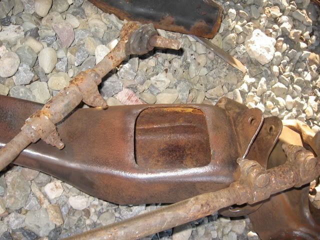

Cleaned up the D-35 beam while I was at it and squirted some fresh paint on it. I also added a drain plug (although after doing it I came up with a better idea, but decided I wasn't really interested in spending more time on the project right now, so it may be a future modification).
I also welded up around the pivot hole and added a short brace.

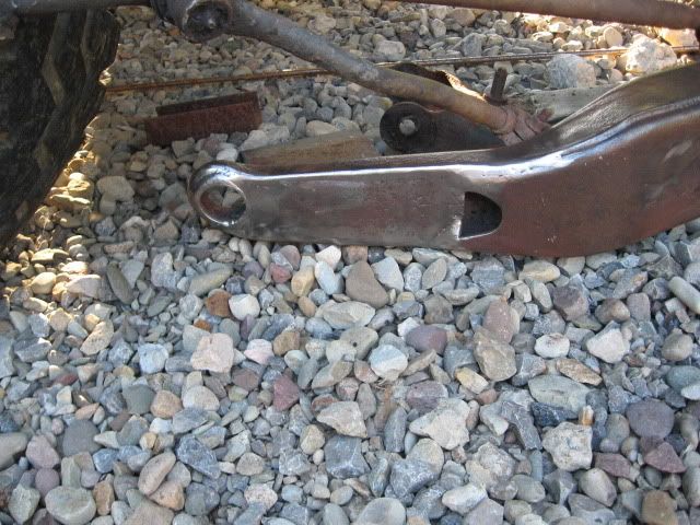

Opened up the window for the passenger side axle shaft.
And plated the passenger side axle shaft near the pivot.

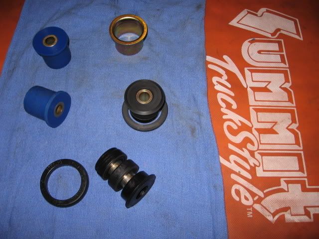

I had bought some replacement axle pivot bushings from James Duff, but when I punched out the old rubber ones, I discovered that the pivot bushing sleeves were shot. So after some debate, I decided maybe it would be best just to replace the sleeves. I was going to buy a new set of bushings until realized that I had a set complete with sleeves that I had picked up for my F-150. As luck would have it, they use the same bushing size.
Only thing is, I can't decide which bushing to stick in there now. The Duff ones are one piece blue poly and the Energy Suspension (box says something about hyperflex bushings) come in four pieces plus the metal inner sleeve and the outer sleeve. Anybody have any recommendations?

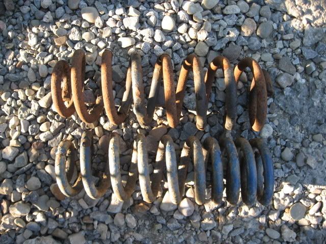

And then while I was messing with things today, I had this crazy thought trip through my mind so I dug into my scrap pile and yanked out one of the worn-out coils I took off my F-150. For the F-150, it was worn out, the front end sat about 2.5" lower than it was supposed to. I set the coil with my 3" Duff lift coils and it is surprisingly similar.... hard to tell pressing on it, but it feels like both coils have similar give....
So should I stick with the Duff coils or should I give the worn F-150 coils a try?
Sweet b2 on the coils id keep the duff I tried 150 coils in my old ranger and it made the ride unbaribly rough
sweet....i'll have to check this thing out when we come up to butler in august
Thanks for the props!
I was trying to decide on the coils, I figured that maybe since they were softened up a lil bit by being on my F-150 since 1995 they might not be any stiffer than my Duff coils but I dunno...
