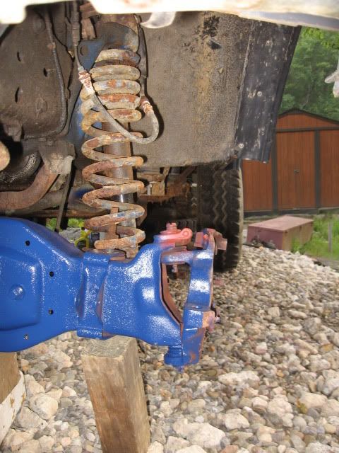

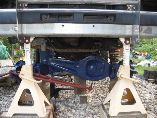

Gettin there, got the D-35 beams under the truck, now I need to work on the radius arms...

Looks like I'll have to fix the camber.... just mocked up at an estimated ride height

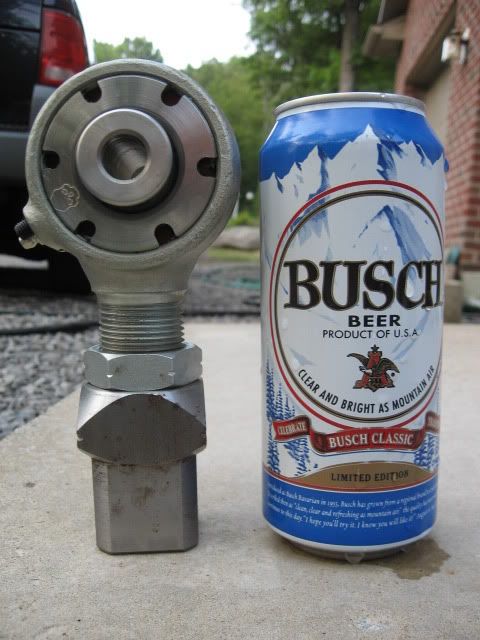

In order to give a better idea of the size of the joints I'm using for the radius arms.... and yes, that's a 16oz can
