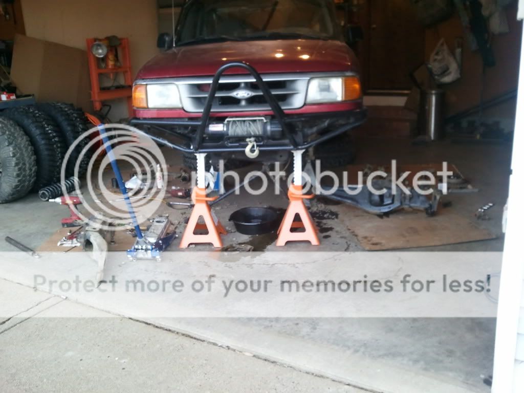

Finally got the 35 out . Hope to have it back together by this weekend so I can go wheelin .
My 44 Knuckle Swap 35/44 Hybrid
I see you found some big jack stands.
Those are some mighty large jackstands. May I inquire where you obtained them?
Killer build by the way.
:icon_thumby:

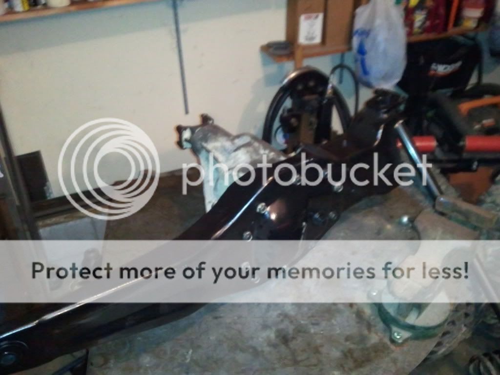

Got the Aussie locker put in and the 3rd bolt to the beam . Doing gears and lockers suck I think I would rather stick to fab work lol .
I wanted to be done friday night but might be saturday now .
How did you get the ball joint clearance cut out like that?
Also, what's that "window" for?
Did you make any other cuts for clearance?
