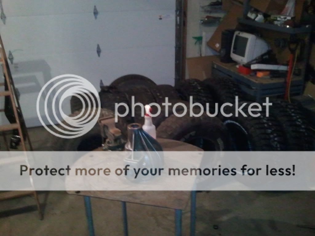

I got 2 Wild Country RVT 35/12.50r15's tonight with about 3/16 tread for $10 . So I should be good on the spares .
ive got two of those in the 31" flavor...not a bad tire really
Yeah Ive got of them also, but they are 32s. One is my spare.
Got 4 more Wild Country tires , 2 with really good tread for $35 .

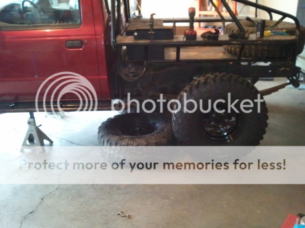

I know it's been awhile . Been waiting on parts and getting rear end ready .
Installed 4.56 gears , axle seals , and new shoes in the rear axle .

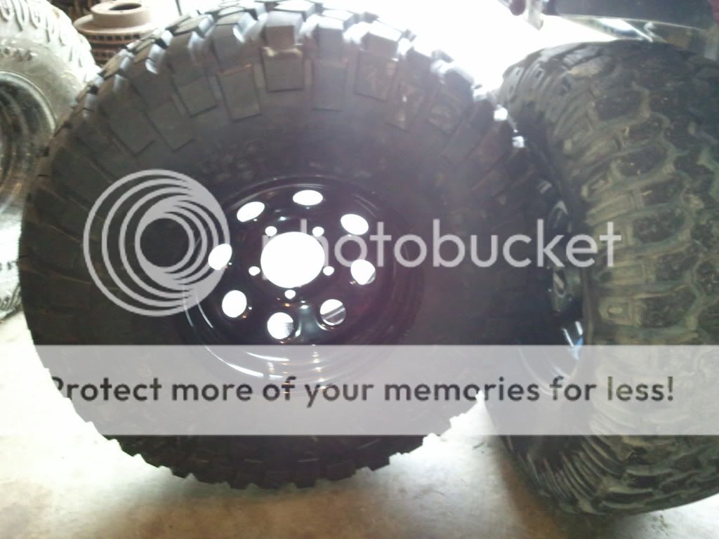

Got tired of waiting on the wheels that I ordered so I canceled them and ordered 5 15x8 crager soft 8's with 5x5.5 pattern and 4" backspacing .
Mounted the km2's on the wheels by hand and added 8 ounces of .25g airsoft pellets .
My 44 Knuckle Swap 35/44 Hybrid
The 1.5" thick 4.5-5.5 adapters came in the mail today . The 4.25" hole in the center of the wheel left a lot of the adapter showing but some black paint took care of that .

Going to start pulling the 35 out today .
If I wasn't in the middle of trying to get the B2 driveable, I'd come help you out.
1st off I need to see some better pics of your flat bed because I have been looking for some inspiration for my 94. Any info or pics you could provide me I would greatly appreciate it.
But your doing some awesome work on this project, I cant wait to see the outcome.
