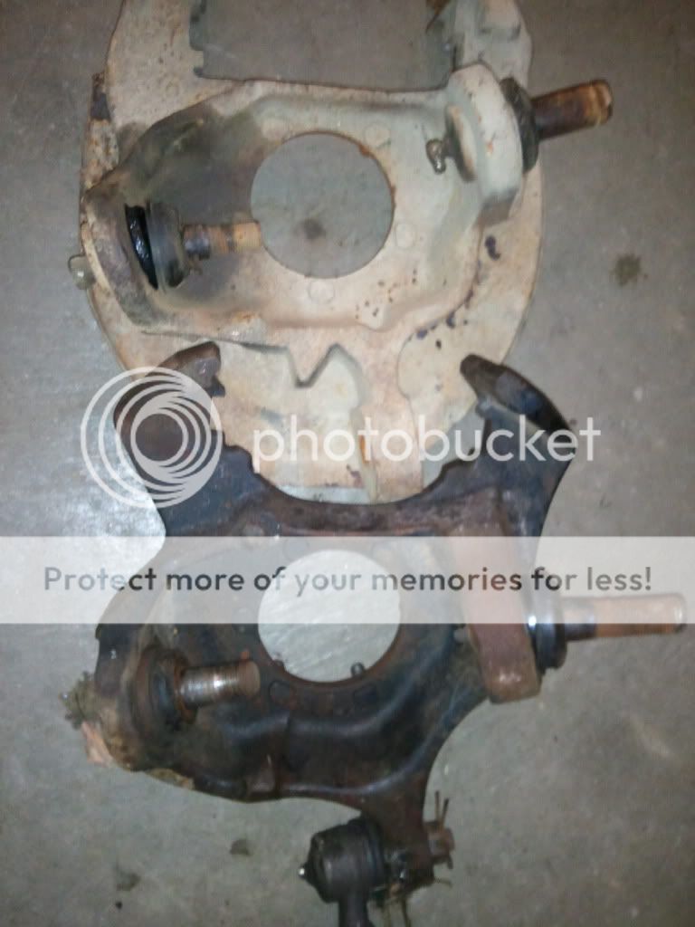

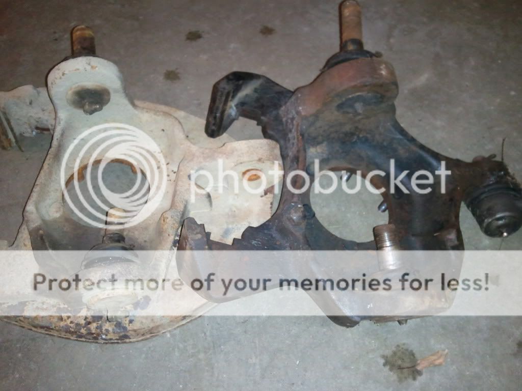

What is wrong with the 44 knuckles![]()
those knuckles are just salty looking. certain knuckles have different deck dimensions etc...which makes for more or less modding with the reamer and the knuckles on the 35 beam. just make sure the centerline of the shaft is close on the drivers beam and you wont have seal or side gears issues. i would rather be low then hi for centerline pass thru.
actual ride ht varies the camber setup and fitting of the knuckle lock to lock on the steering.
