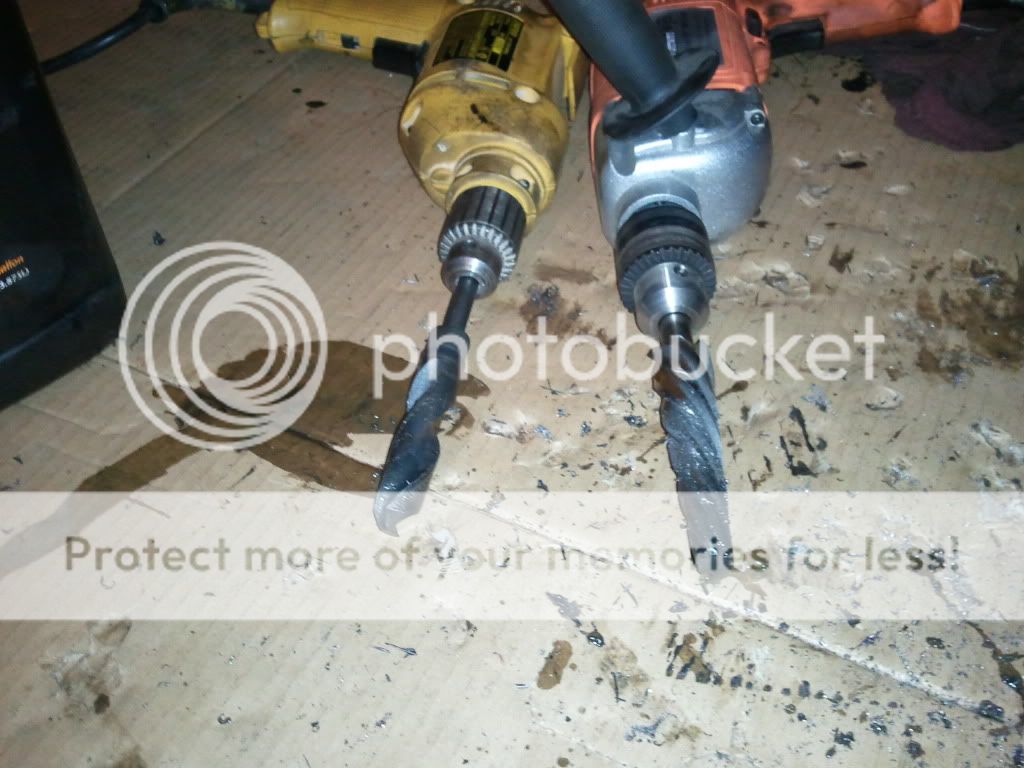

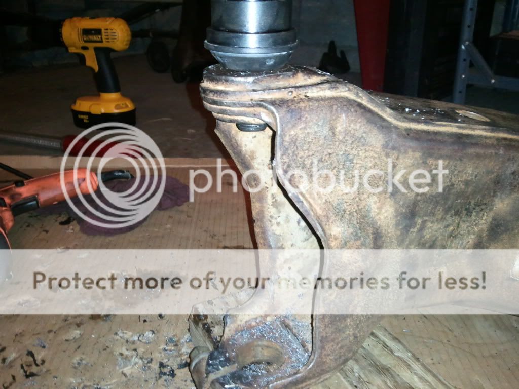

Reamed the beams . Reamed one side for 15 minutes before finding a quicker way . The treaded part of the ball joint is 3/4" so I drilled the beams 3/4" . Then the reaming went VERY quick .

how many damn drills do you have? lol i spotted 3...
where did you get the 3/4 bit? i need one.

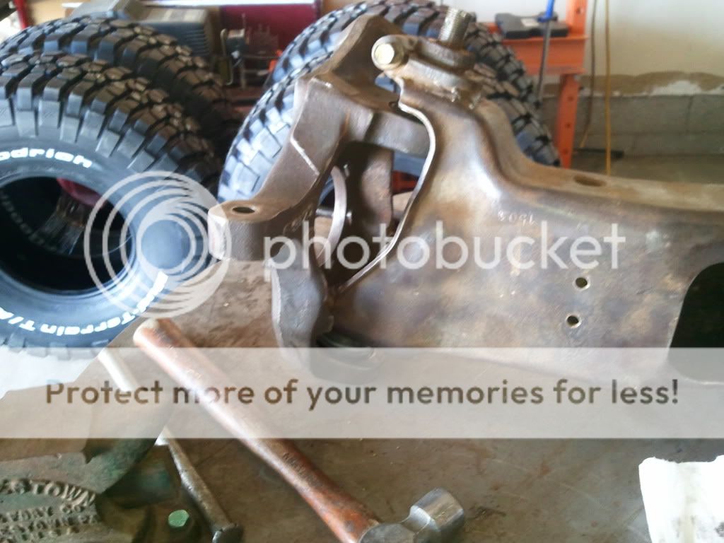

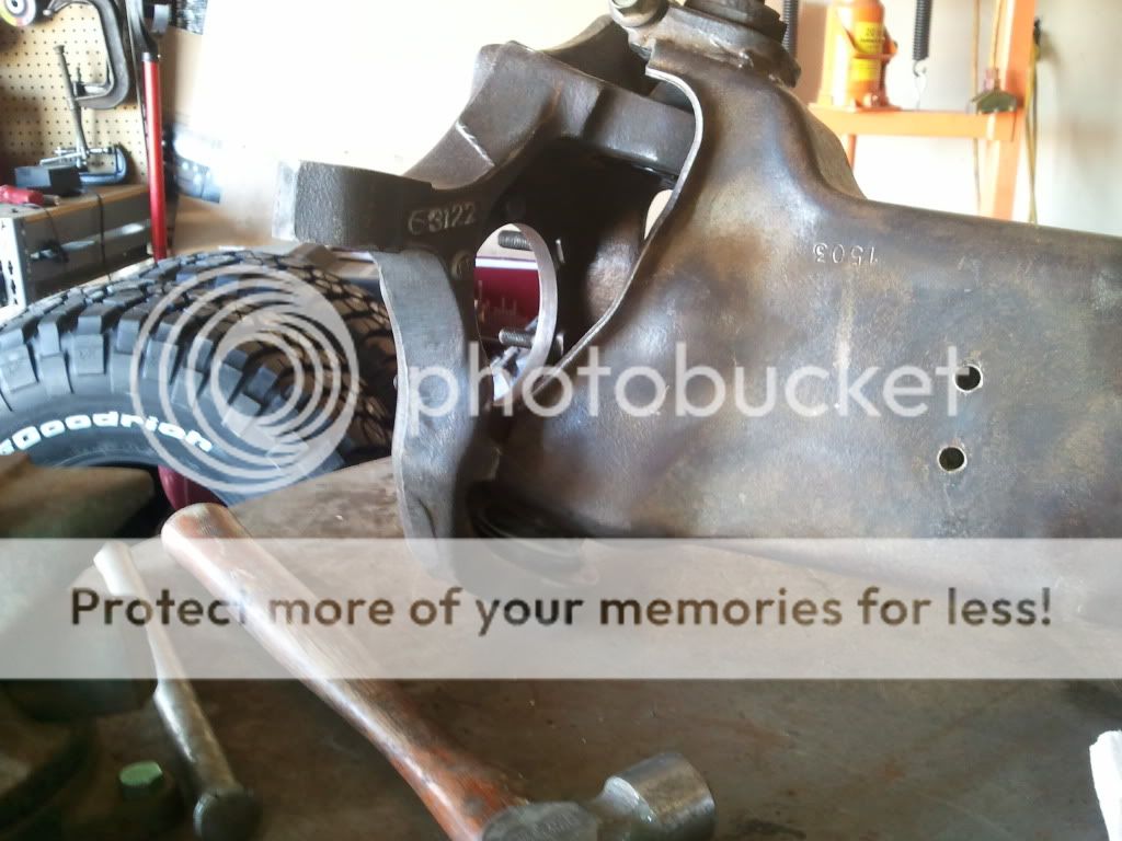

Test fit the right side knuckle to the beam .
My plan is to start the swap on the 21st so should be more updates coming .
