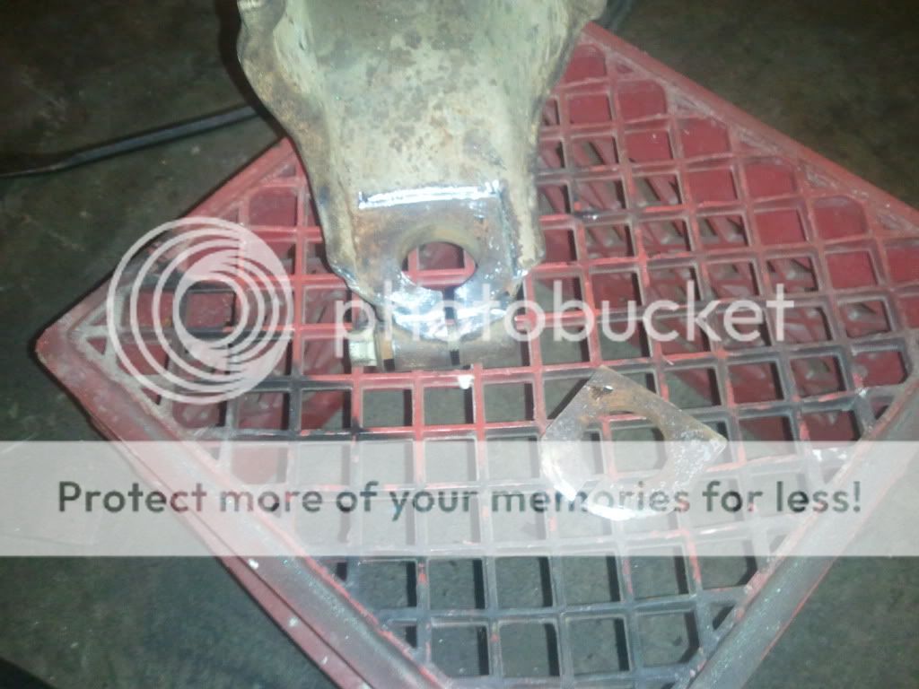

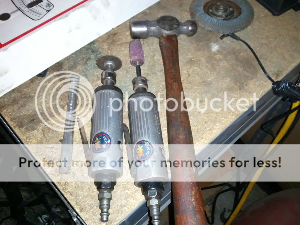

How did you get the ball joint clearance cut out like that?
Also, what's that "window" for?
Did you make any other cuts for clearance?
Used a reamer for the balljoint . The window is for the right side axle shaft to go through .

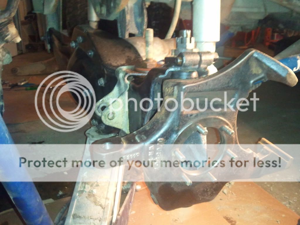

First pic of 44 knuckle on the 35 beam .

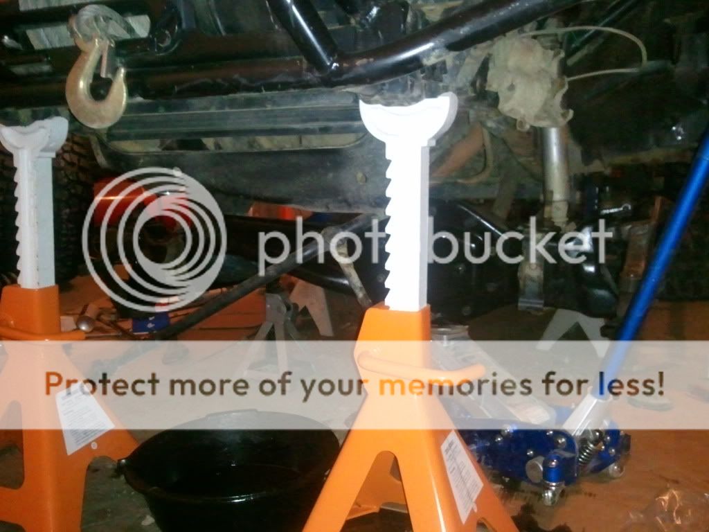

Both beams and knuckles are in . I'm done for the night .

The torque sequence I used for the ball joints is .
Lower balljoint 80
Upper balljoint 100 while holding 44 camber caster bushing with pipe wrench
Lower balljoint 100
Tighten camp on 35 beam

I meant how did you cut this chunk out?
