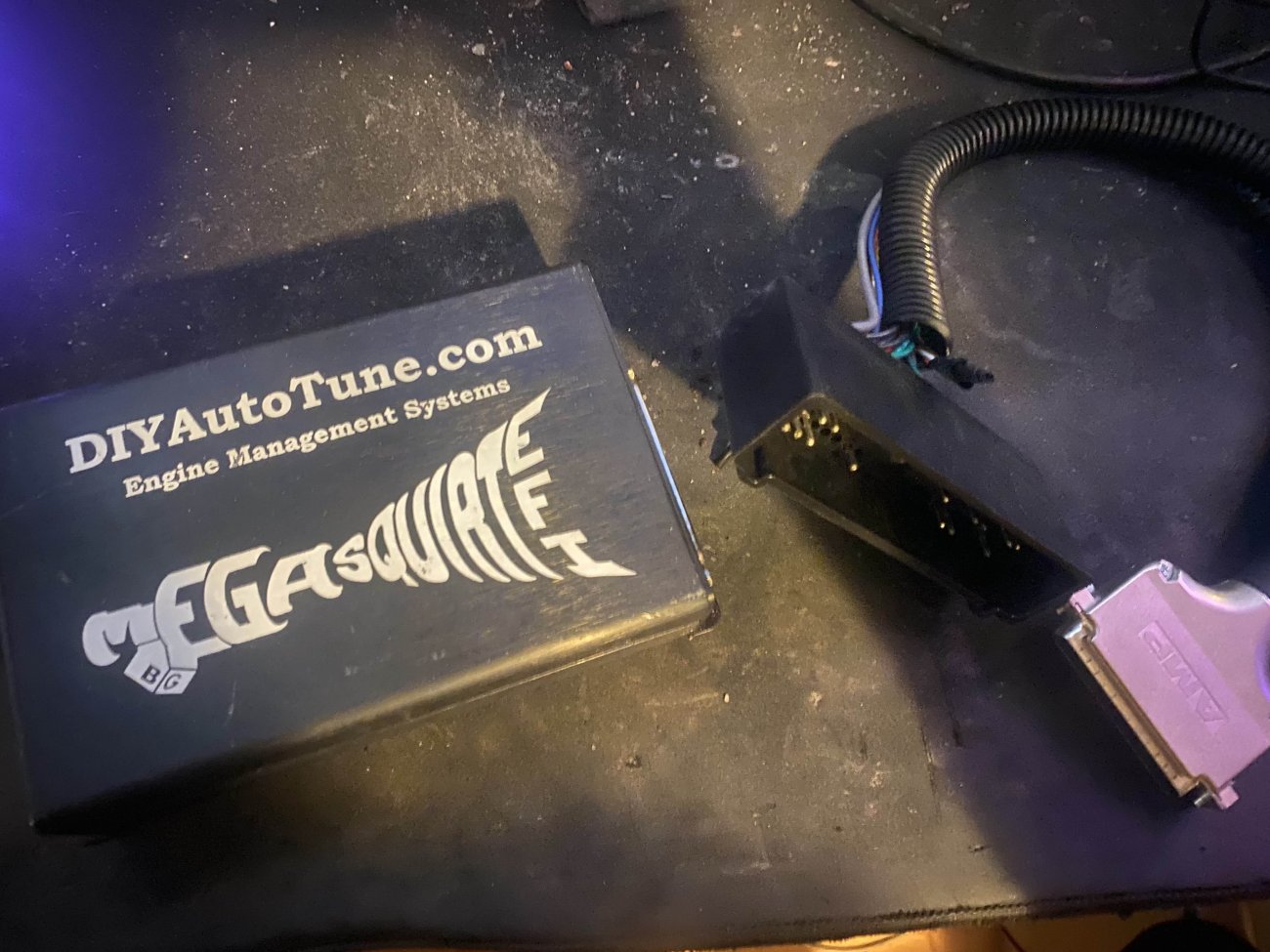

just picked up this sweet mega squirt 2 ecu with the 60 pin eec-iv connector was wondering if any one has any ideas on how to wire everything pin location wise and stuff like that. the guy i bought it off of was using it on a mustang so not sure what is backwards compatible probably nothing.

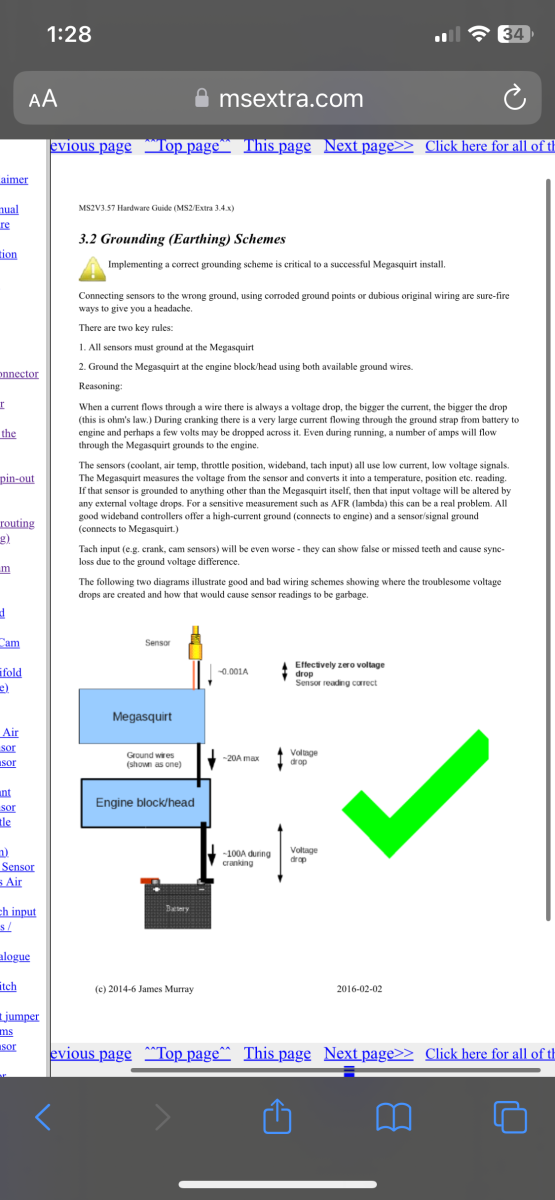

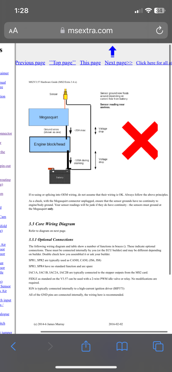

Not really finding anything on the actual wiring up maybe I’m just dumb and don’t know were to look I’ve check petroleum junkies stuff but he doesn’t mention the wiring up process but I have been reading the manual for the ms2 and says I need to use one ground to the engine block now if I ignore that and just use factory grounds would all be ok? Or should I just gather all the grounds from all the sensors grounding them to the block so I can with have them still run to the connector, I pmd him not sure if he’s gonna respond. I may just send it and go for it why not right can’t be that hard with an actual days of research
I don't know anything about anything, but don't you just want to look up the MS2 pinout, look up your truck's ECU pinout, and match like to like for everything you're using? Signal ground already goes to the ECU.

Ohh I see didn’t know he had one there thanks. this is what I was talking about with the sensor though just gonna see what happens if everything works out with the stock wiring.
