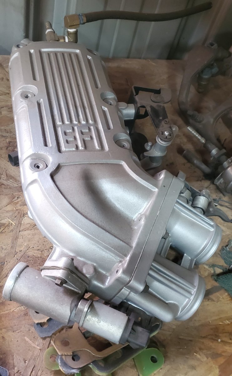

I also got the dual throttle body’s too just need to put it on they look so sick, eBay seller didn’t even include any of the linkages because why not you know. So I gotta figure something out for that

Can send photos of linkage. It's a door style system. There's a merkur graveyard in the states that has some left... I may, too. Merkur guys ebay name was 'blugg' if memory serves. 'Capriroadracer' on ebay is helpful as well - he has sources for import parts.
Ask as many questions as you'd like. I'm not an expert, but have tried a lot of crap.
Dual intake will cause loss of some low end torque, but excels at higher rpm. Intake runner length stuff. Garrolite spacers help a little due to getting IAT away from radiant heat from lower intake. But you can control IAT tables now, so no big deal. Megasquirt changes your thinking now that everything is under your control.

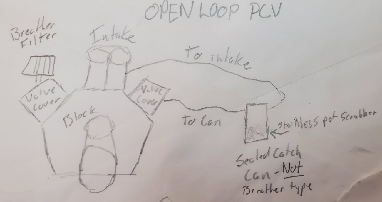

Open loop pcv is big one. Like $40 in parts and difference in response and knock is very noticeable. If I find time will draw up
Both linkage and spacers visible in pic.
There is a euro aluminum fuel rail... never tried it.

Here. Open loop setup.

Put can somewhere cool in engine bay to condense oil vapors. Be careful of freezing in winter if you drive in cold weather, they can ice over with combustion water vapor. You'll need to empty can once a week or so.
Set it up and use IAC control to trim your idle back down. Advantage is your pcv now is independent system and has ability to freely breathe. Pcv works on vac and on pressure both if left to own devices... there is a slight in-out pulse on the crankcase as pistons roll around. Doing it this way you ensure good hard vacuum that purges crankcase when at idle. Only upgrade beyond this one is aerospace engineering crankcase purge system, and they're $$$$, and for drag racing. They pull hard vacuum on piston rings at WOT to make them seat harder and will give power bump. Not noticeable on sub 600-800 hp engines tho.
I did not use "pcv valve" if memory serves... just ran hard vacuum at idle, then lesser vacuum as manifold pressure lost. If it needs to purge itself with no manifold vacuum, it can due to open side. Remote relocation of breather filter will keep goo away, but not necessary.
You will get slight oil drip on breather side occasionally... maybe. I never cared, It's a 2.9... they occasionally drip anyways.

I am definitely going to make that though was thinking of mounting right were the clutch reservoir is heat doesn’t really get trapped over there I don’t think, should be a good enough spot may look a little ugly we’ll see how it goes
