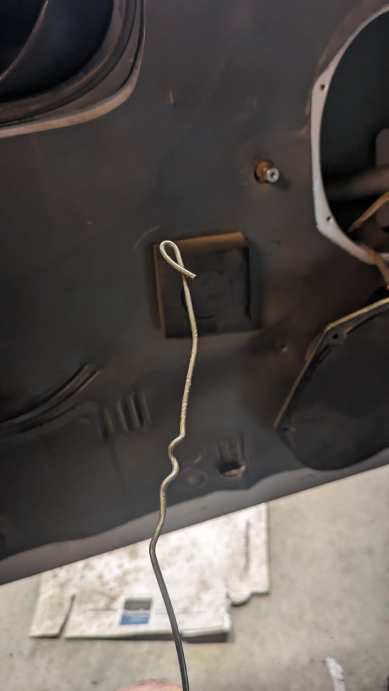

One, how to get wires through into the door specifically on the driver's side, given that at the exit of wire pass through, the emergency brake pedal mechanism is in the way. Two, where to find an easy, constant, 12 volt power source. Short of passing a wire through the firewall. Which is annoying.
The first problem was easily solved by my favorite tool, the wire coat hanger. I bent it into this shape:
Removed the speaker, and started shoving it through here carefully:
This is approximately where it will come out:
From there I just wrapped the wires up, added some extra tape to make sure the coat hanger wouldn't rip the rubber through, or damage other wires on the way back.
Voila! Wires!

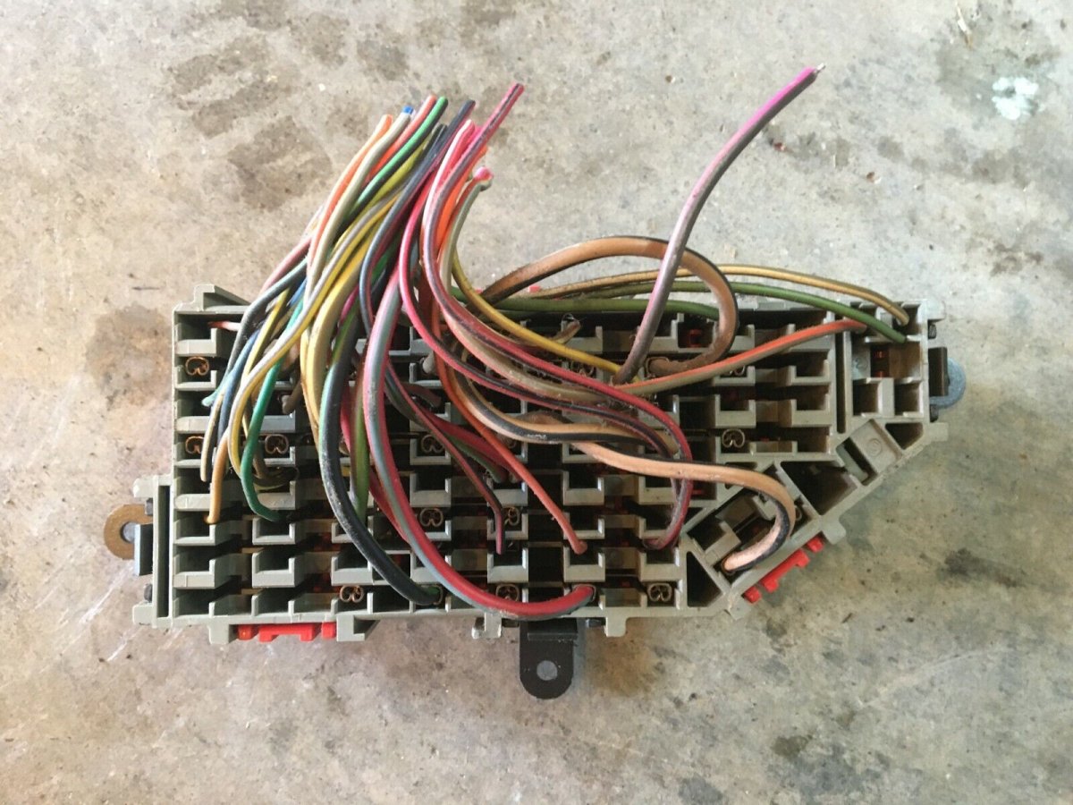

Check the fuse diagram for your year, and you should be able to find a fuse slot that's hopefully constant, and not being used.
I pulled the fuse box out by removing the 3 bolts holding it in, pulled the whole fuse box out as much as possible. I made sure to route the power wire from the unit over and out of the way of the parking brake mechanism.
I then stuffed power wire into the back of the slot, sorta did a crimp to hold it down, and slotted in a 10 Amp fuse I know it's supposed to be 5 amp fuse for the power mirror switch, but there is already a 10 amp in line fuse from the kit, and I doubt it's gonna matter. I used the OBD2 port bolts to ground the unit.
Bingo Bango Bongo, route some wires here, a zip tie there. The thing's in!

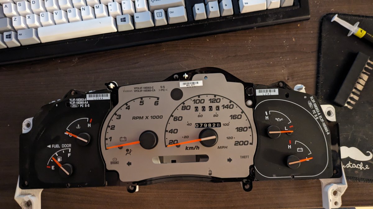

The locking system, new airbags, and newish dash cluster are buttoned up and working great! I didn't end up installing the sound deadening in the doors due to the weather being simply too cold, I really don't want to have to crack open my doors again because some Kilmat detached and is now sticking to my window.
I swapped my odometer, and two side gauge units onto a cluster that was in better condition (someone ripped the airbag light out of the original one damaging the traces, I wonder why...) I went for this mix and match approach mainly because it's unique, and the new cluster was from a 4x4 equipped vehicle. So the lettering on the sides for Low Range and 4x4 would have just been out of place.
