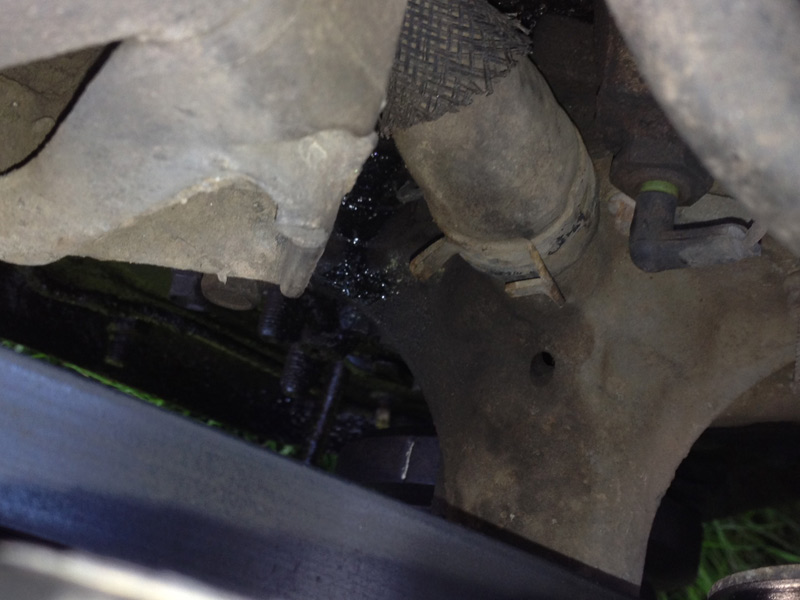

Here are some pictures of the leak. The best pics I could get. That seems to be the highest point it drips down from.
Doesn't really help unless someone else can pin point location. You'd be best to get a pressure test where the leak would identify itself. Maybe one of the parts stores will do it for free.
