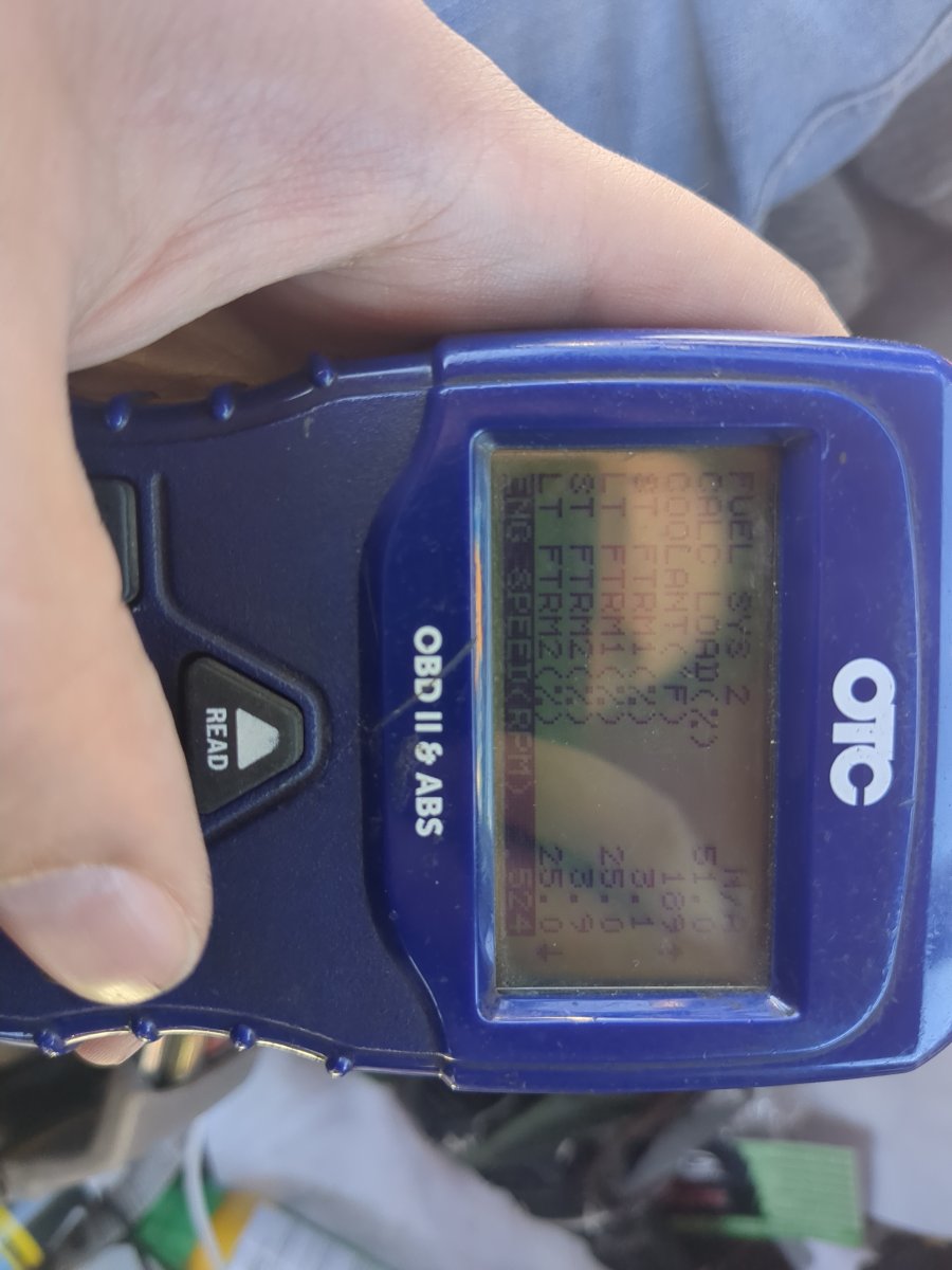

Also threw a bank 1 too lean code with breather hose plugged. Here's the data on hot idle ...idling about 600.

LT fuel trims are way off. Since the ecm is trying to give it more fuel but out of range to be able to it is throwing the lean code.
This could be caused by unmerered air entering the engine or fuel delivery issues. Most commonly it is unmetered air due to the intake tube being cracked. Did you check the tube I mentioned before?
Sometimes intake gaskets go bad and allow unmetered air in that way. Safest way to check that is use propane around the intake gaskets to see if the idle speed changes. If it does then there is a leak there.
Have you changed the fuel filter since purchasing? Could be clogged from bad fuel. Also do you have a fuel pressure tester? What does it have for fuel pressure with key on engine off, engine idle and lowest it dips to when cracking the throttle/reving the engine?
A bad O2 sensors can cause this also but it is far more likely unmetered air is the issue.

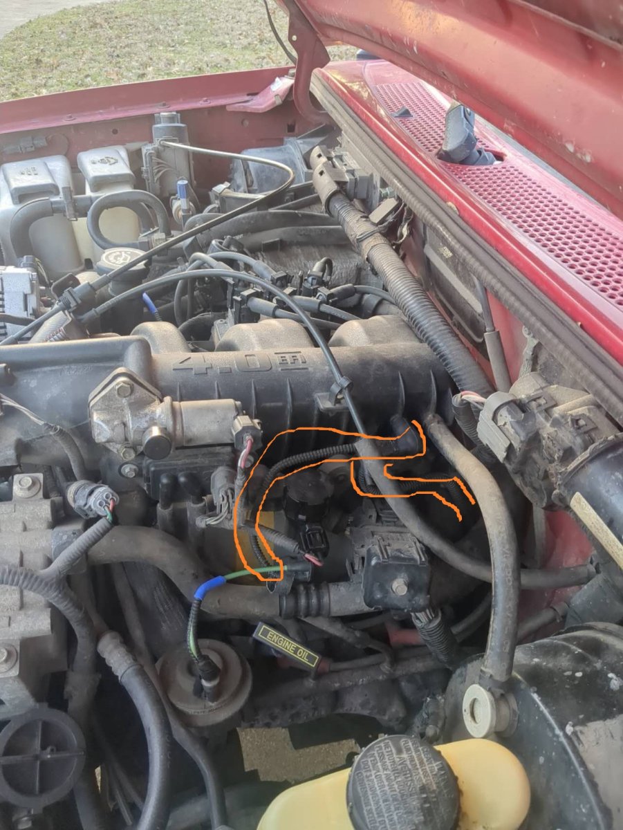

Hello folks, what is this line called circled in yellow-orange? I have a leak somewhere on this line, I suspect the 90 degree rubber boot is faulty. Anyone know a fix or where I can find a new boot? Unplugging and blocking this makes the engine without a visible bad idle (you can still see it bouncing on the OBD scanner). Previously the line to the EGR broke and threw a EGR insufficent flow error on the GREEN line, I patched it with sillicone hose as you can see.
You should be able to get an assortment of the little rubber fittings and even the plastic line at any parts store in the HELP section.
No luck on those fittings in my area (neither advanced, O Riley, Autozone, NAPAetc), there are two lines that run from them. I tested the boots for leaks and pressure test the vacumn lines and patched the lines.
