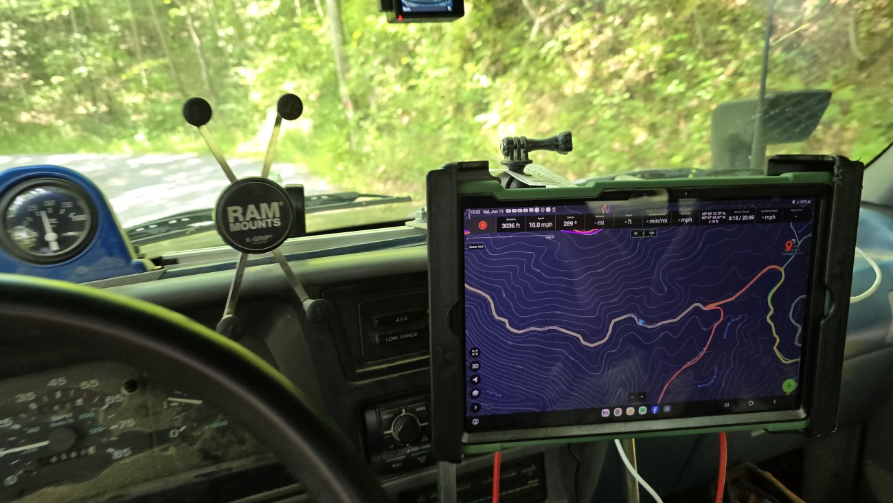

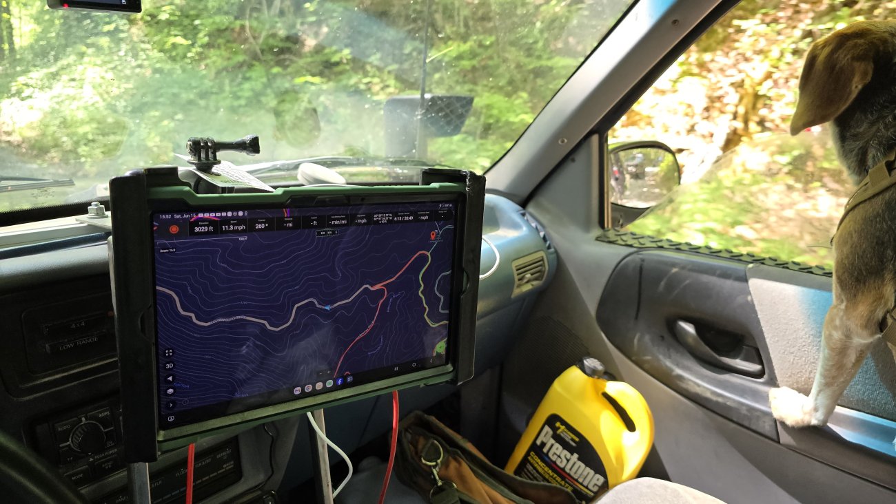

Other options would be to install additional cigarette lighter style power ports and/or USB charging ports to power your stand-alone device. In my 93 Ranger, I use Ram Mount brand brackets to hold my phone and a tablet. The tablet gives me a nice sized navigation screen. The phone links to my stereo for hands-free operation. I do not have a backup camera. In my last F150(1997 year model) I did what I outlined above. I installed an aftermarket stereo with screen. I had a backup camera hardwired to it and my phone linked by USB or Bluetooth for habds-free operation. It displayed Google maps from my phone via Android Auto.
My setup in the Ranger. Phone not in it's holder because I used it to take the photo. The phone and tablet plug into USB ports I installed below the dash.
