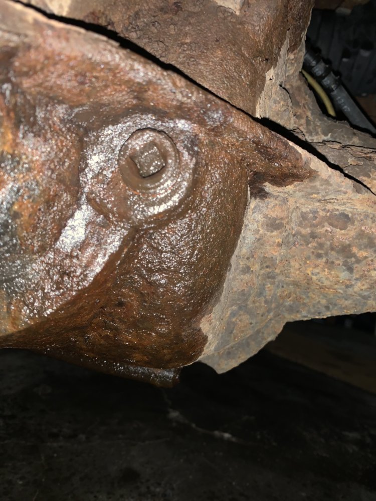

If you put anti-seize on the outer half of the threads of the new plug, you won’t have to worry about it next time. Easy peasy.

well yes, but if you get your truck 10+ years after it was built and no one else had ever had that plug out, and especially if your in the salt belt, not so easy.
