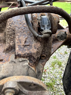

Mystery Electrical Plug above rear diff.
A few more pics of the mystery rear differential, to go with the mystery plug :P
looks like a b2 axle.
just non rabs.

Yup. I plugged a 97/98 Explorer rear axle into my 2000 Ranger and the 8.8 out of the 00 Ranger went in my 89 Bronco II and plugged right in. The 00 Ranger not only uses that sensor for ABS/RABS data, but it’s also your speedometer. In the 89 it’s just a dumb RABS sensor and just plugged in to keep things tidy.
