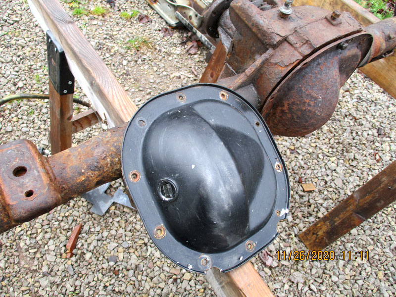

I'm also a fan of adding a fill hole to the cover, I'v did a couple of them using the small bung from a 55 gal oil drum, there's always a few laying around where I work. (in the pic., I wish I'd pit it about an inch lower.)

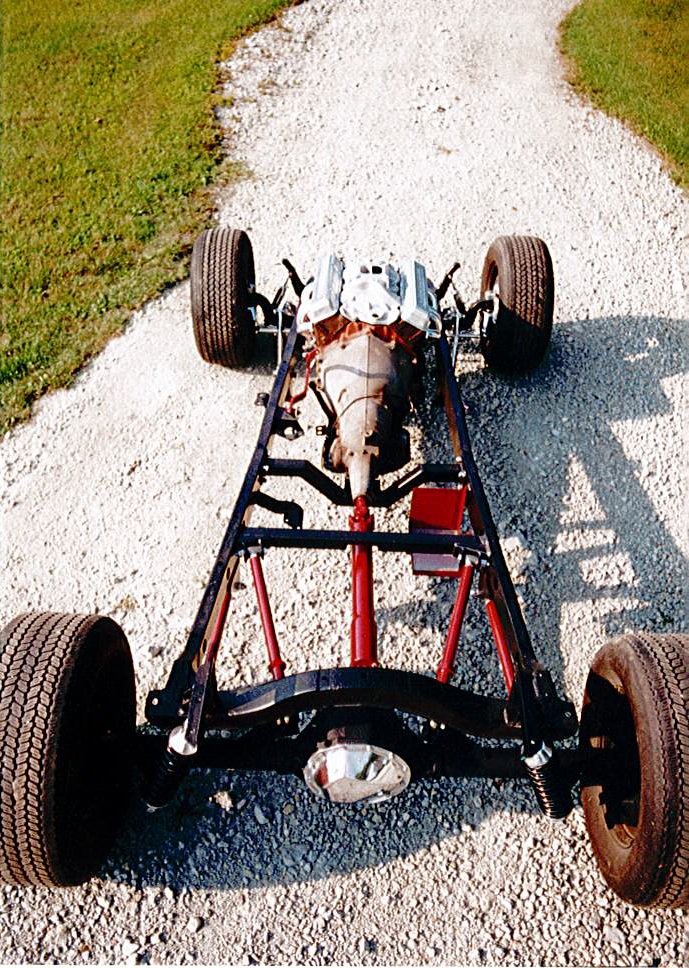

Ugh.. Those castings sure do get attacked by road salt. When I lived in Ohio I used a posi out of a '68 Impala for my '31 Ford Model A Sedan. I bet I spent 20 hours air chiseling and sandblasting it to get it down to sound metal.

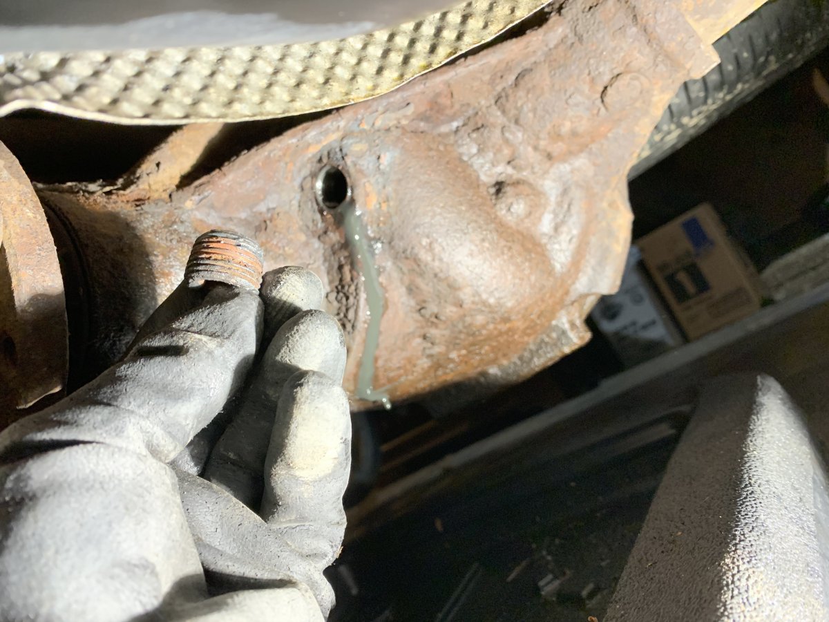

Awesome... well except for the look of that gear oil.
Its yucky.
Looks like maybe some water got in there with the gear oil.... I had it come out of my early bronco front diff, looking like jelly, with water at the bottom. No telling how long it had been like that.
Anyway, congrats on a step in the right direction ;)
