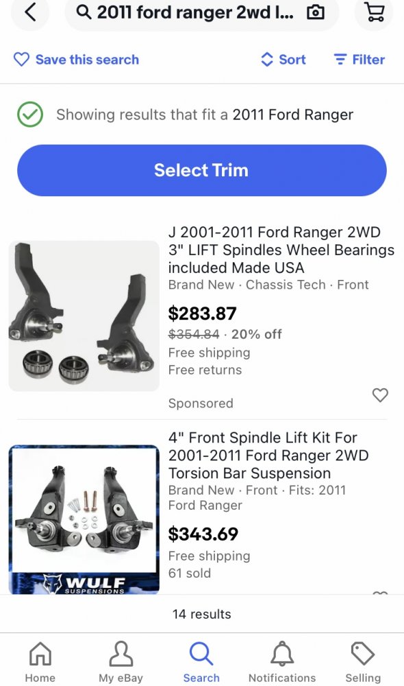

I think they make a lift spindle that would give you some front height increase, smallest I think is 2” which might be about the difference between front/rear wheelwell opening heights.
EDIT- 3”, from the quick lookup I just did:
