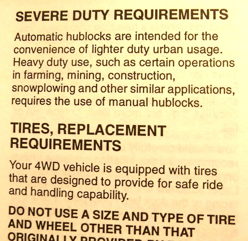

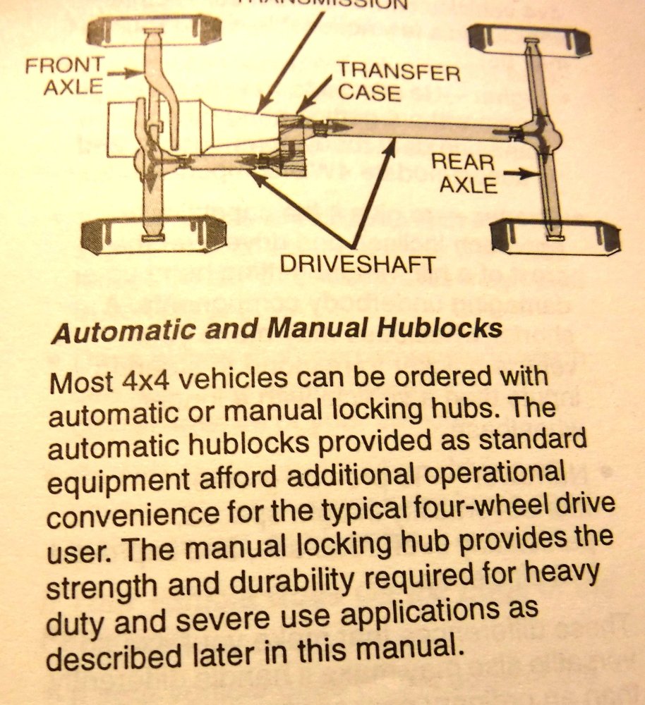

So, here it is, straight from the horses mouth :)
I had never noticed this before. Happy hill climbing :D
darn, I should have ordered the manual hubs!
I'll look to see if my 4x4 booklet says the same, probably does
On what truck the 91?
yep just replaced my auto hubs with manuals after breaking one trying to help pull someone out. Lol

With the auto hubs since they have the plastic cam and how they work, just don't rock back and forth quickly, if you ease into things a little it should help...
That same book goes in all the 4WD James. I didn't get one with the Ranger, someone likely misplaced it and I only saw one with the Explorer and happened across it a couple days ago
Yeah mine says the same. I do want to put in manual hubs sometime, I wouldn't mind getting my hands on a set of Warn or Ford manual hubs but I might have to go with Mile Maker which I guess would be fine.
