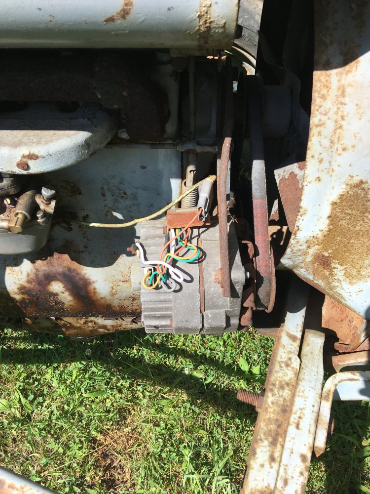

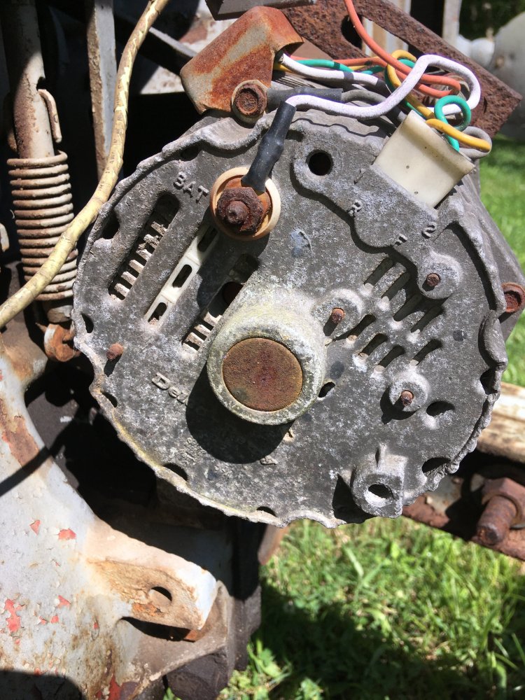

I’ll have to get a pic. Looks like someone tried to half rig an external voltage regulator on it and I’m pretty sure none of it is right or works.
Tie the large white wire and the smaller green wire going to terminal 2 together and run them to the battery +.(the tractor should be wired negative ground).
Take the yellow wire and tie it to a new wire that goes all the way to the dash to a light in a plastic socket. Tie this new wire from terminal 1 to one side of the light. Take the other side of the light and hook it to the ignition switch where it has power when the ignition is on.
