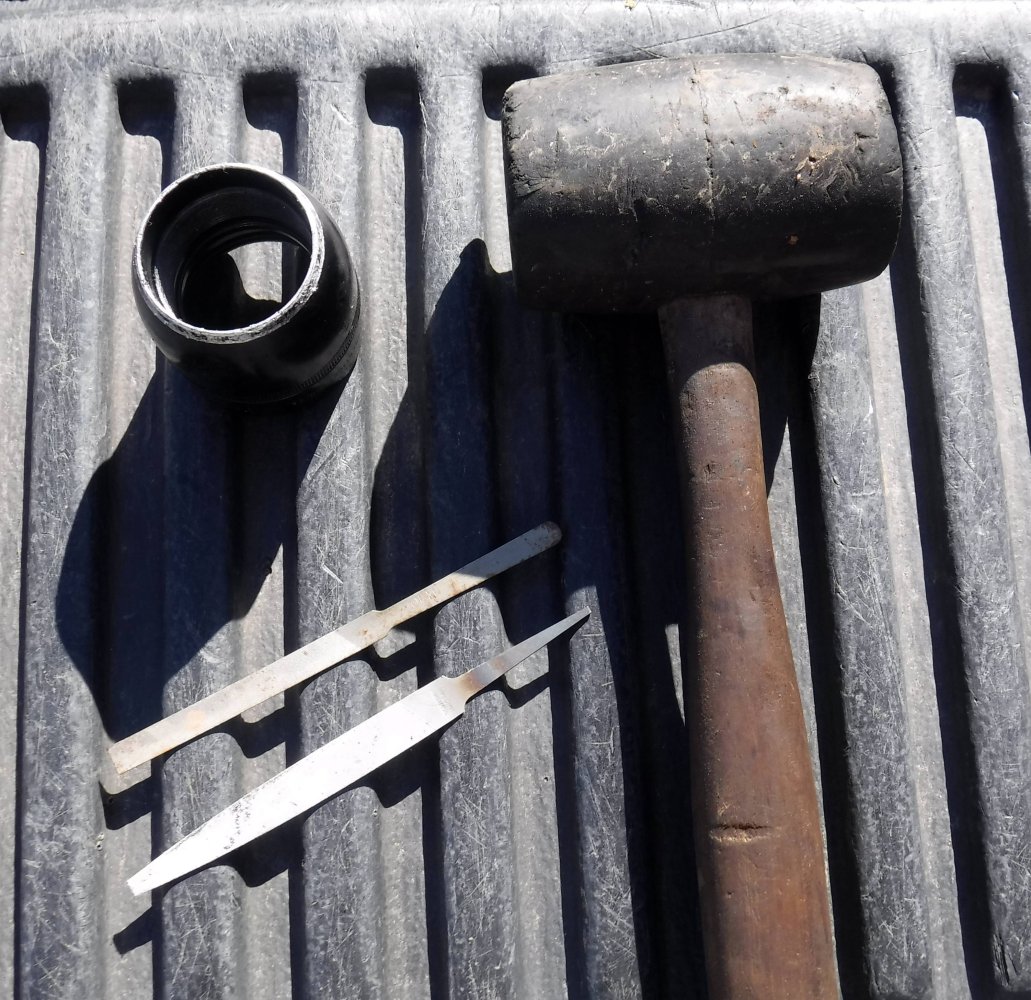

My concern is busting that cam when going back together with it, and I've done it far too many times already.
I use a rubber mallet and an old Mag light flashlight end that was as close as I could find to tap it back together, and sometimes it takes a lot of taps.
If the cog or the groove it goes in gets flattened I shape it up with a small file
