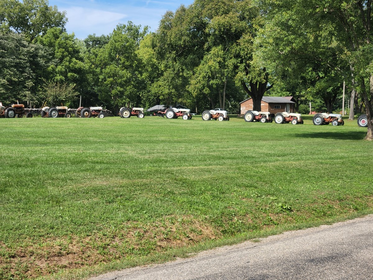

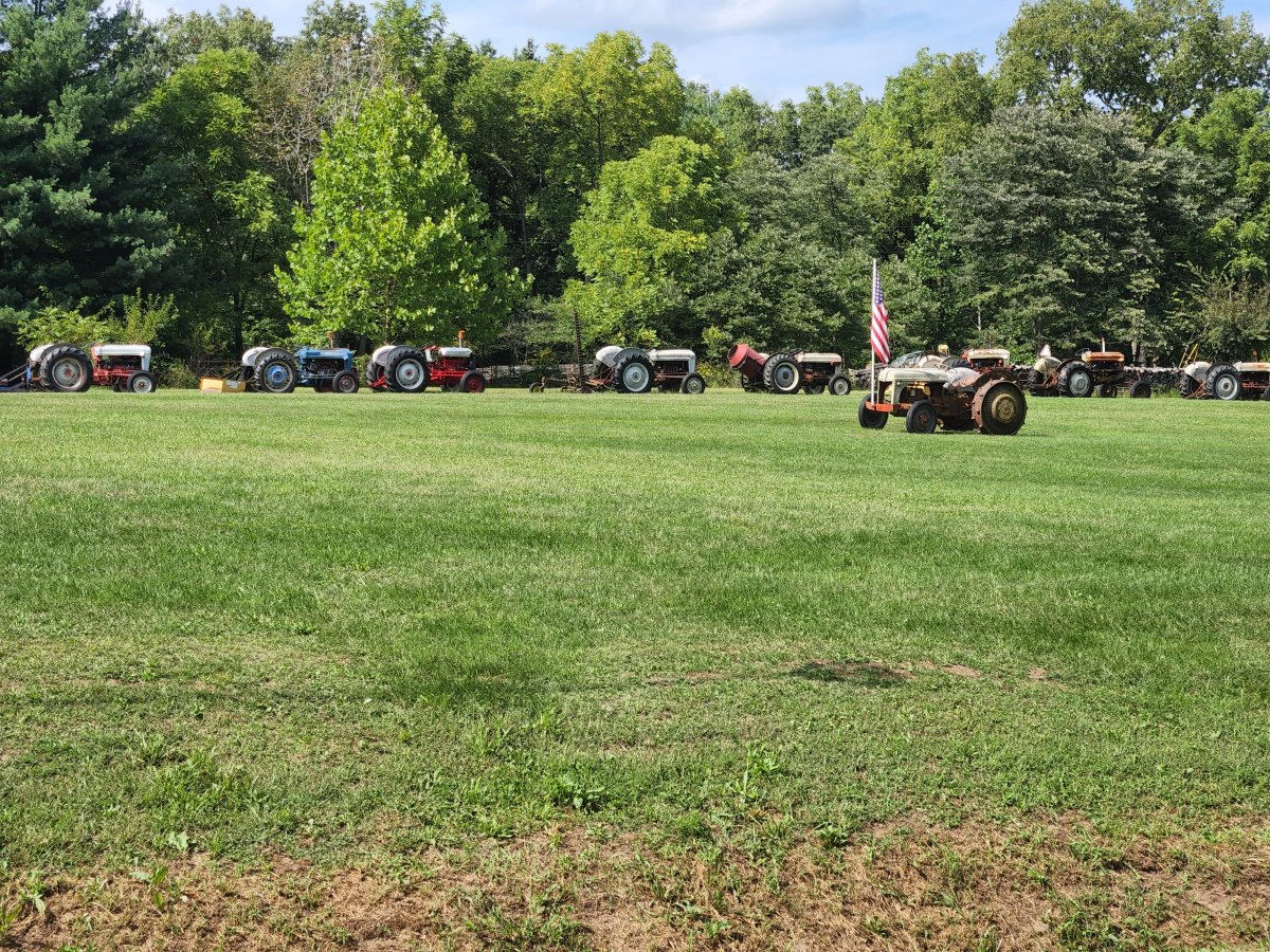

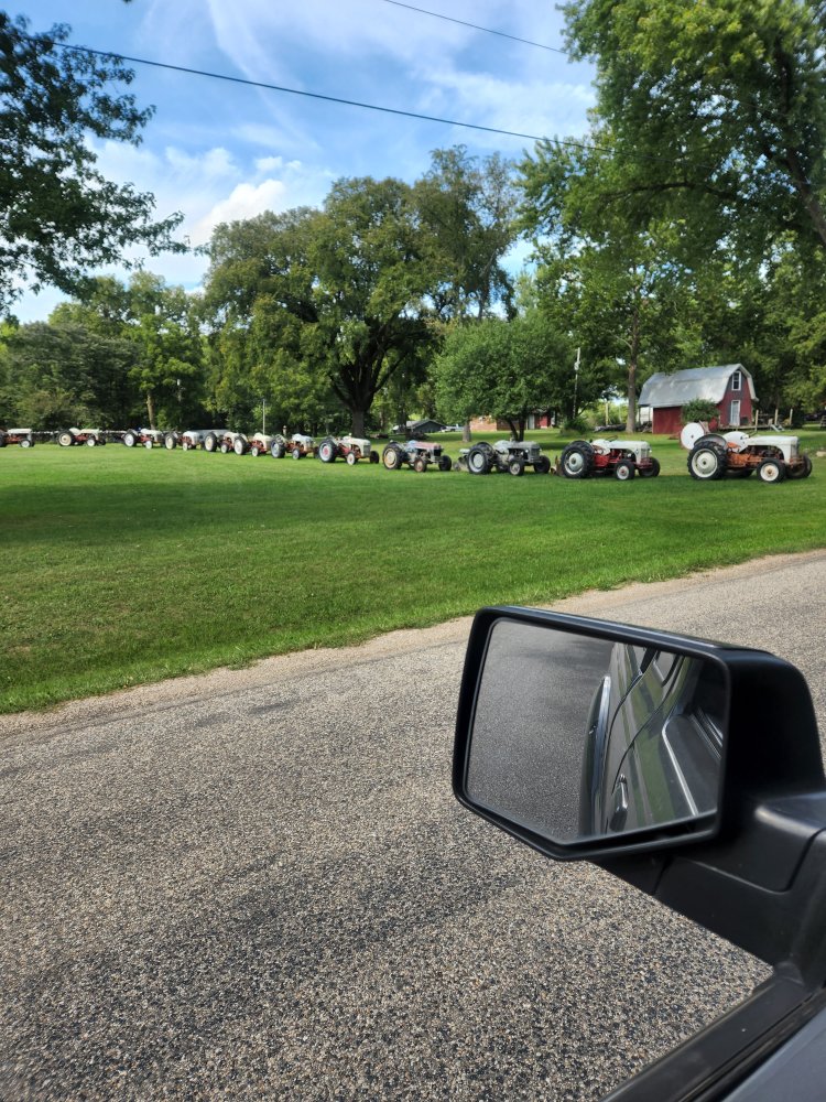

Who has a photo of all those 8N tractors sitting in a yard in Attica, Indiana just outside of the Badlands Offroad Park?
