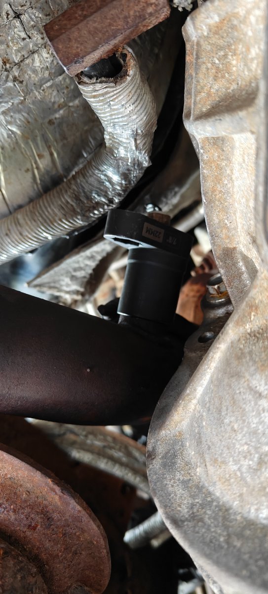

I can get the socket on it.
I can get a ratchet or a breaker bar in the socket.
But there is ZERO room to turn said ratchet or breaker bar.
Any ideas?

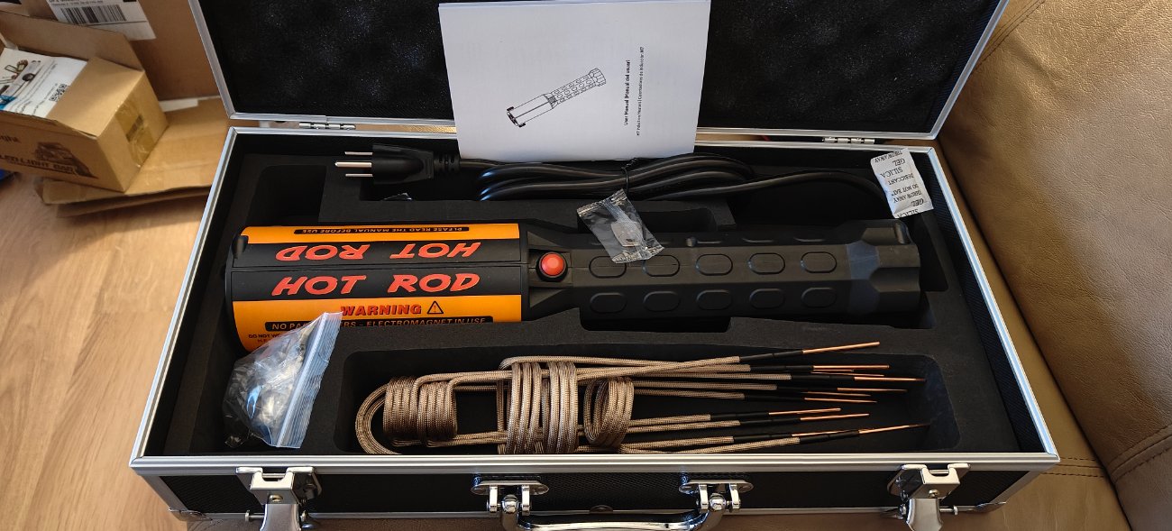

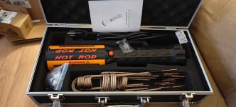

Gonna give my new toy a shot now...

I should probably get one of those

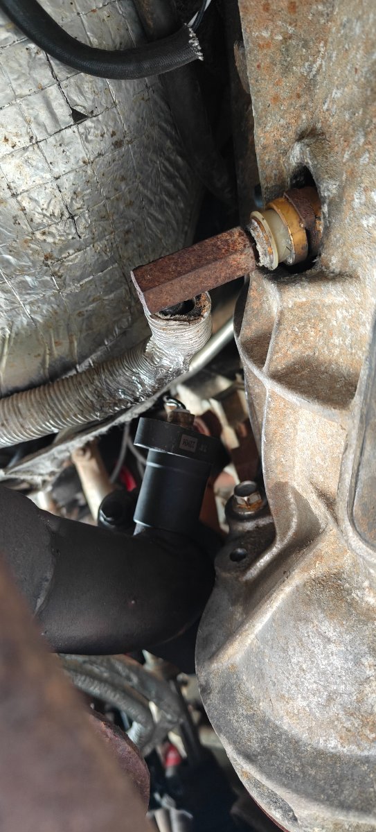

What is this sensor that plugs into the side of the transmission?
It looks like it is held together by a c clip.
If I could get that wire out of the way I would have a little room.

Vacuum line maybe? Vent line? Not really sure offhand. Hopefully someone else knows, I can’t really go poke at anything at the moment and try to figure out what it is.
This is my first time using it! šŸ¤·ā€ā™‚ļø
I’ve been using an oxy/acetylene or oxy/propane torch for the last like 20 years, but I’ve seen people use those induction heaters and I know that sometimes a torch either doesn’t really fit or there is lots of stuff that can be inadvertently melted nearby where you need to use it where that wouldn’t be as much of an issue with the induction heater

I've heard that they aren't necessarily all they're cracked up to be apart from some rather niche situations where using flame is an absolute no-go.
Let us know how hot she can get things cookin.
I've always wondered about the effectiveness of getting reeeeeeeally stubborn crap broke free by getting it ripping hot and then immideately hitting it with some 'bolt-freeze' or whatever it's called. Id imagine going from hot AF to cold AF within a second or two would help stuff crack itself loose rather well..

That does work too. I’ve tried it. One thing I do love about a torch is if heat and/or heat to cold doesn’t do the job, there’s a handy little magic lever on a torch that reduces metal to liquid. Can’t be tight if it’s a liquid.

The limitations showed themselves.
In theory the "coil" should go around the fastener that needs to be removed. The magnetic field is strongest inside the coil and that's what heats the metal.
Well, where the problem fastener is in this use case prevents me from getting the coil "around" it.
(See above photos... The crow foot socket is around the sensor in them... No way to get the coil around it.)
