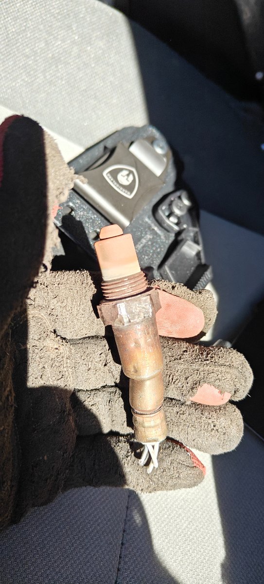

Another hour and one broken gear wrench later...
Left Upstream O2 Sensor Removal
I put the wrench on it, wedged a 2' breaker bar between the jaws of the wrench and the exhaust pipe, and leaned on it until I heard something crack, then leaned a little more...
It broke free, and the pawl inside the ratcheting end of the wrench broke too.
It was the "Husky" brand from Home Depot and they warranty replaced it so it's better now.

Normally I use a 12 point box end wrench with a cheater pipe on it. Cut the wire off, pop it off with a wrench. They wear out so no big deal to replace them.

And ya, I didn't have a 22mm regular box end, the only 22mm I had was the gear wrench type. No biggie. HD is 5 minutes from my house. I rolled in asked if they would replace it, customer service said "No problem. Go grab one." šŸ‘
I had cut the wire already when fighting with the socket. 😁
