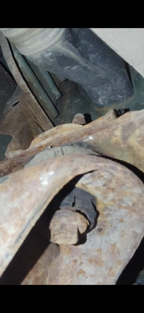

ive got coils & leafs both on the back. no sway bar. Did it mostly for load capacity since my stock rear suspension was a single fiberglass leaf. The coil helpers I put on are a 2,500# rated spring. Yes it rides a little stiffer but not bad with a load.
View attachment 57887View attachment 57888
I'm so confused by that...
