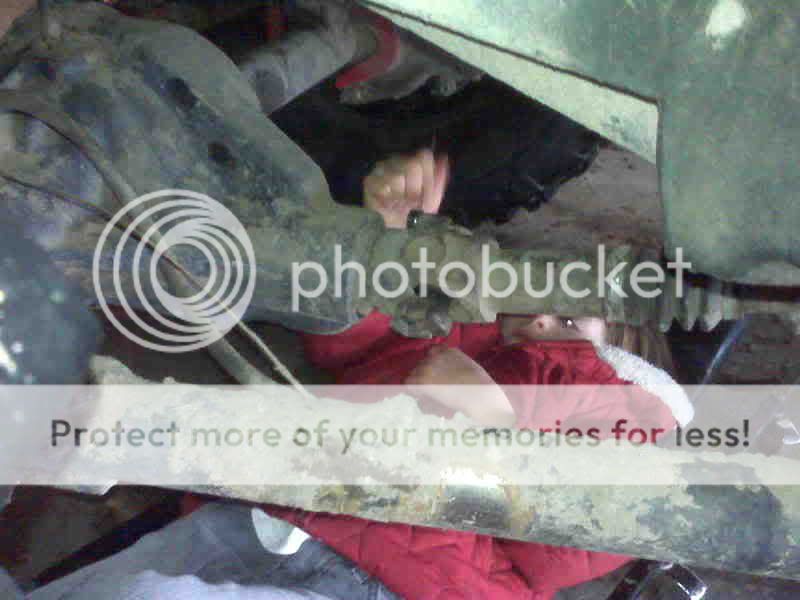

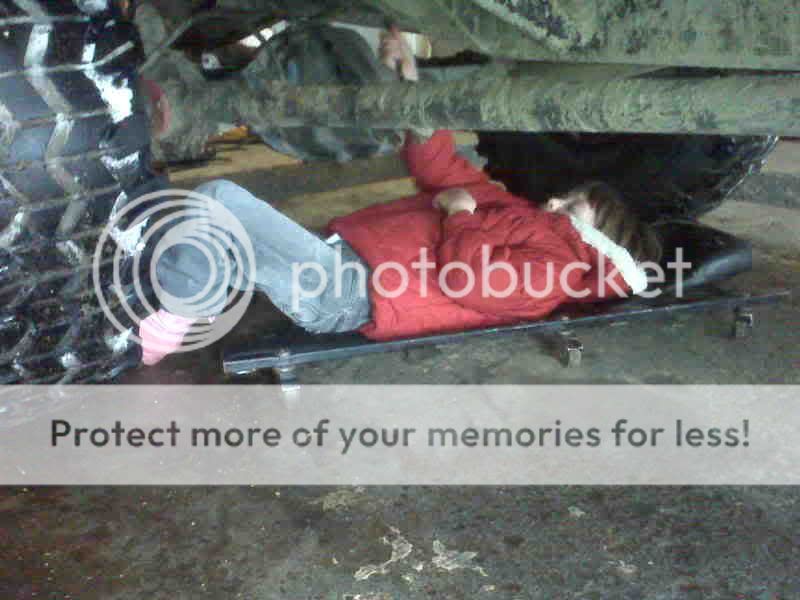

My daughter came out and wanted to do something, so I gave her a 1/2" wrench and said take those bolt off.....she removed my front drive shaft for me, kinda nice! Then she helped me press in a new U joint, she had fun!
Pictures of the help, I will get more of the truck when it is done.

"Show me a girl with a wrench in her hand and I will show you a future wheeler!" Lol, glad she is into wrenchin and wheeling, you two will have a fun and close relationship!! Congrats man :icon_thumby:
