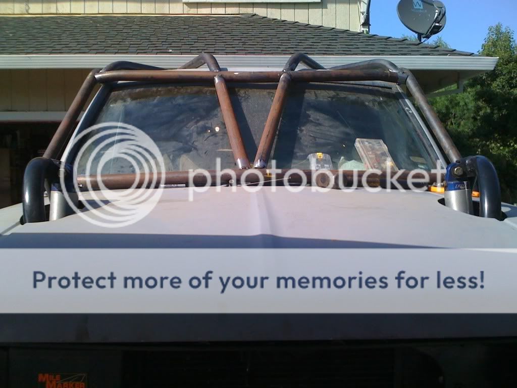

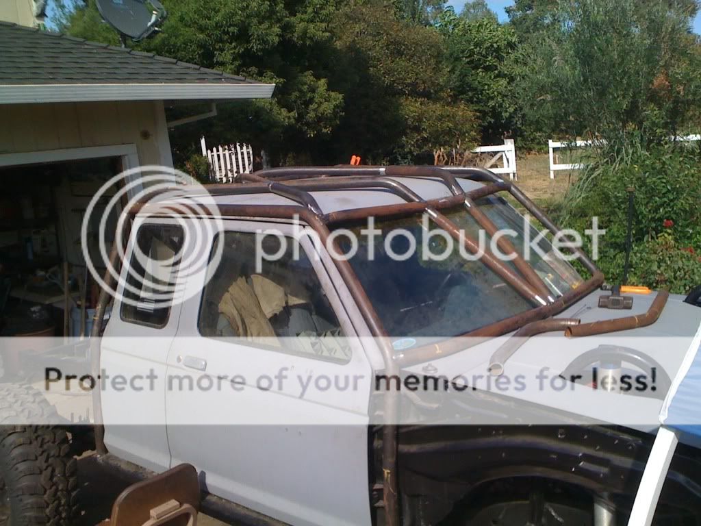

I am gonna be ordering up some 1.750 bending mandrels to do an exo. A buddy of mine is gonna split em with me for use of my welder and bender, then we are bothing doing exo's, just need to pick a design.

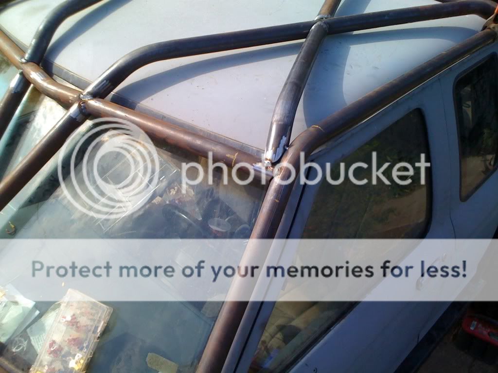

I kinds like how simple this is, but with more gusseting and Xing...

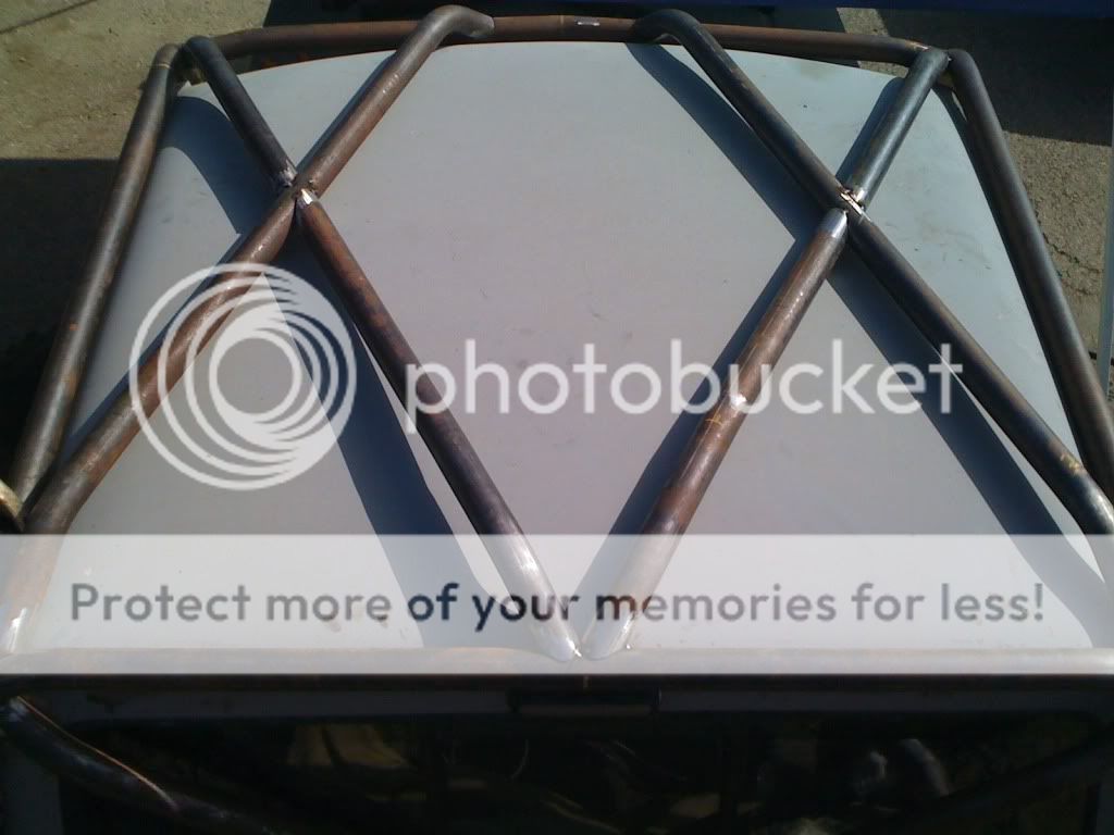

then I like this one too
But maybe only one X on the roof, and the v on the winsheild upside down
How bout some other ideas...
i like the first one, but i think the second one is too much
i like the second one but like you said with 1 x on the roof and the v upside down. u gonna extend it to cover your fenders as well?
second for sure....it looks way over the top because simply its done right
the first one just looks unfinished and one good flop on the corner and its just going to fold over
i say take it along the front fenders and down the bed

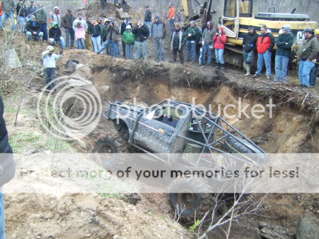

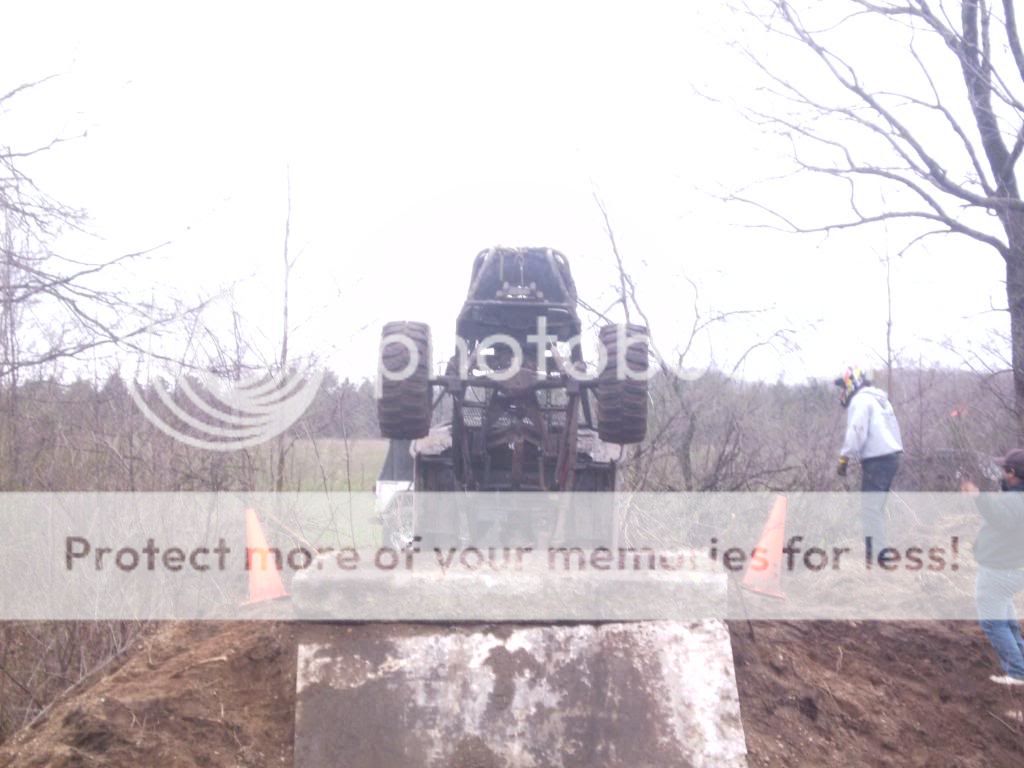

I watched this one flop the day that pic was taken, held up fwiw.
And the stinger FTW, he stood it up on end then bumped throttle foward and dropped it back onto the wheels, no stinger, def front endo.

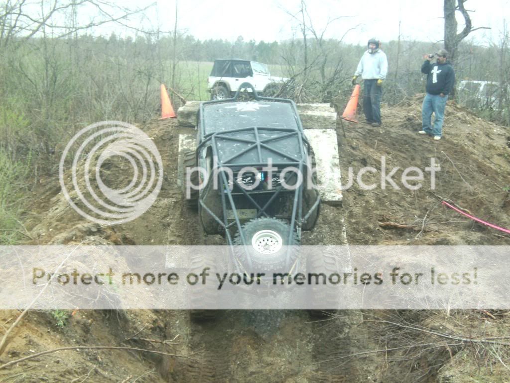

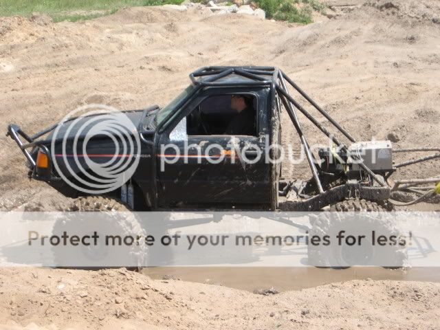

have you looked at greg's? (97trailrigDD)
greg's is my fav. Looks to be very effective, but isn't super bulky and ugly. I really like how it goes inside the fenders.
