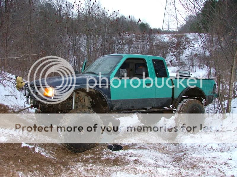

Alright, went wheeling yesterday, get to test the winch out a few times...and I finally found an issue(knew it would be eventually) but I poped my front drive shaft out, time for a long travel slip or just limit the droop, or both:D I was climbing a hill and I caught some air going up it, came down and heard flop flop flop...looked out and saw no tire spin, but it was an easy fix.
My truck broke...

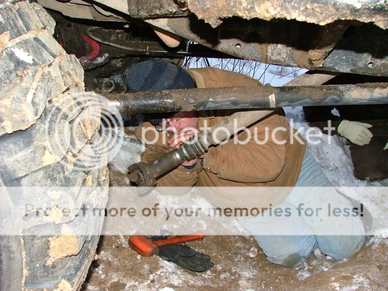

my buddy freezing, fixing it for me

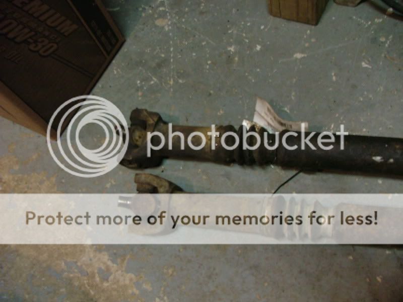

I have never checked how much engagement I have in my front shaft, it just never gave me any issues until now. But after seeing it apart I saw I had very little and since I pushed my axle forward about 1.5" I almost need to lengthen it too. Plan is to make a new one when I do the doubler so I just need something to work now. So I was in the garage and just happened to have a couple front shafts laying next to each other, one out a Ranger, the other out of and Explorer.
Kyle M's Ranger Rebuild

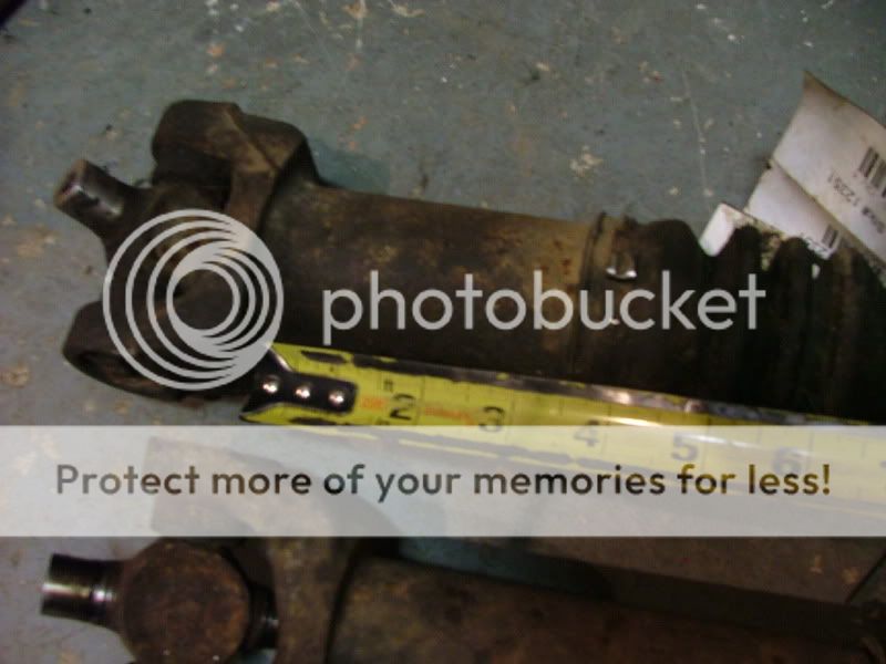

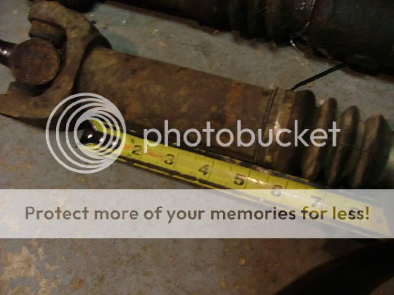

bottom one is the Explorer one, the top one is the Ranger one. Notice a difference between them?? I did...

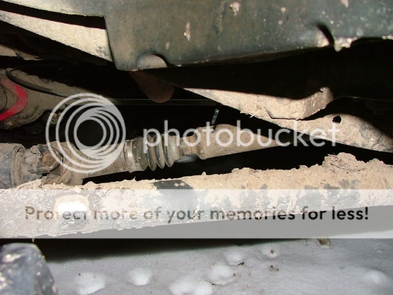

the explorer slip area is about 1.5" longer. So my plan is to swap the front slips around and hopefully I will extend my shaft about 1.5", which will give me more engagement and should be a good temp solution until I limit it and build a new shaft. Here is the shaft on my truck as it sits now
Swappin the female slips should help. Not knowing my drive shaft engagement at my suspension limits scares the shit out of me. I pushed mine to full bump to make sure it wasn't too long then let my axle hang by the limit straps to make sure it was still engaged.
Ahh, that was my buddy...I was warm! But, yeah, he was cold, bitched about it for an hour after!
Ahhh yes, the 2nd gen Expos had a shorter shaft and longer slip, which is kinda weird if you think about it. Hope that works for you!
