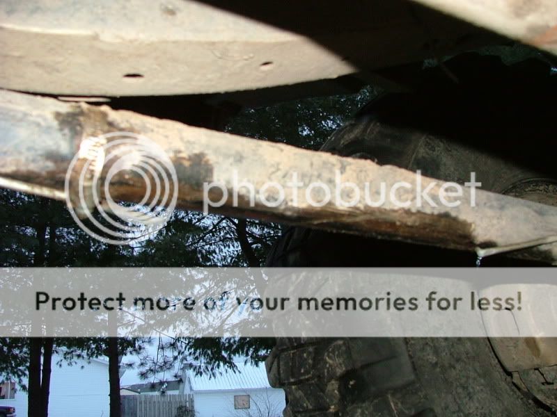

and I figured out my squeak, not sure how I made it driving around not noticing this...
Kyle M's Ranger Rebuild
My brake line running down the radius arm, split in 2, did it on some rocks. My brake was dragging since it wasn't connected anymore. Maybe I need to figure out something better for that, normally it runs on the inside towards the top of the arm, something must made it twist/rotate down..... Funny I didn't lose my brakes, least I had something going for me!
Yep, looks like you pinched the line shut, preventing any fluid loss until pressure was applied, if any loss at all...Ever thought of running it inside the arm, then have a fitting at each end so it's protected on the trail?? That's how I plan to do mine :icon_thumby:
SVT
No, not a bad idea. What about a small dia tube welded on the side with the brake line in it? Not sure I wanna drill holes in the arm.
Just be sure to put the tube on the top, or near the top of the arm.
Robert
Yeah I will, it was up there but the getto hose clamps didn't hold it like I wanted it too. The rocks will mess up some stuff.
you sure know how to tear shit up huh?
Actually, I was thinking of a 90* brakeline fitting that came through the arm, like a bulkhead fitting, on both ends, this way the brakeline is suspended inside the arm, and secured on both ends. Instead of inverted flare fittings you can run AN style fittings...
