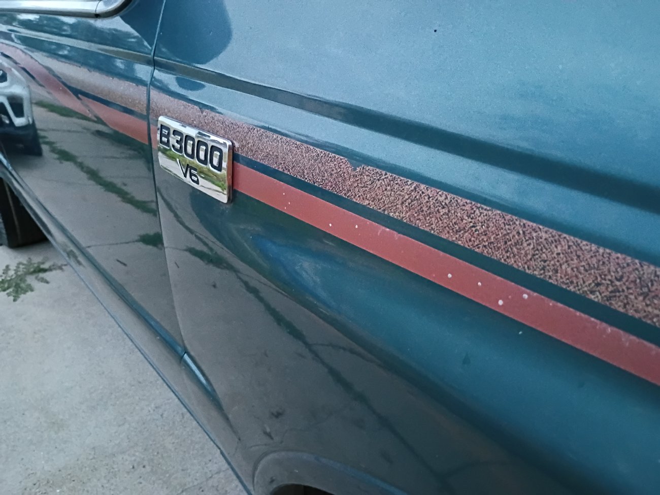

no rust you say.....

None outside the radiator!
But here's something for you.
I’m in the “Save” camp. Rusty ole ranger gave you good advice above.
I’d remove the lower radiator hose and pour water through the reservoir to flush it and see if it’s clogged. Might need another engine at that mileage but rust free is a unicorn.
ESPECIALLY if he's in upstate New York (Syracuse)!... land of heavy road-salt use...
