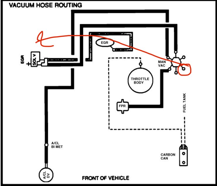

So I plugged the vacuum port and it seemed to run more smoothly, but when I started driving, the engine began to vibrate heavily and stutter. The PCV is hooked up and doesn’t seem to have any issues. I pulled the EGR and it seems to be working fine and has a good vacuum seal. The ICM is still my biggest concern. Could it be a head gasket problem? Attached is a diagram of my vacuum hose. The red writing represent a hose that was there, but it broke and I have no idea where it leads to. It’s not in my diagram. That is the port that I plugged.

You are missing the Vacuum reservoir(VRES) on that drawing, it was for the Vents in the cab, i.e. defrost, panel, floor air direction
But as long as the port is plugged it wouldn't cause a running issue, but you would just have Defrost in the cab, no panel or floor air direction
No probably not head gasket as that causes overheating as the first sign
Sure, ICM was a known issue and has many failure modes, not just heat
Wiring on ICM can also get brittle
