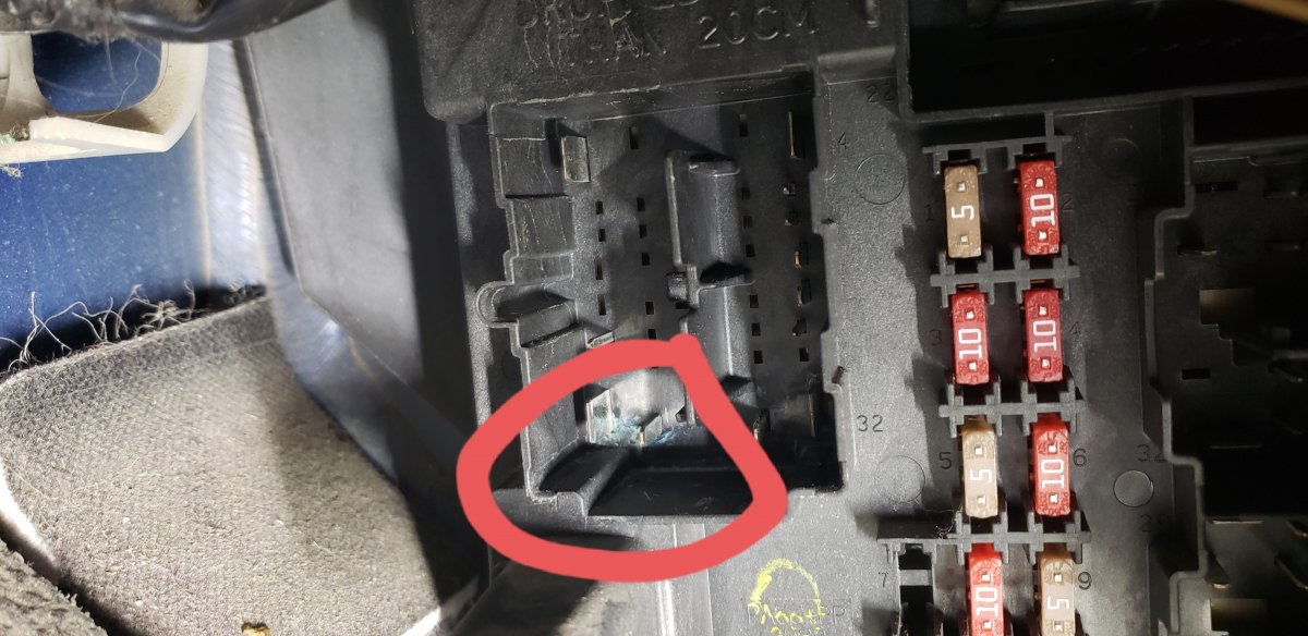

Got the connectors removed, found what looks like corrosion by the circled pin

Yes, that's corrosion, isopropyl alcohol and Q-tips
on both board and connector
maybe scotchbrite the metal pins
See if you can find out where the moisture came from, looks like it "pooled" at the bottom
Can just be condensation, most likely is
Make sure your AC is always working, charged, and use Defrost in winter, lol, that turns AC ON
AC DRIES the air in the cab so less condensation

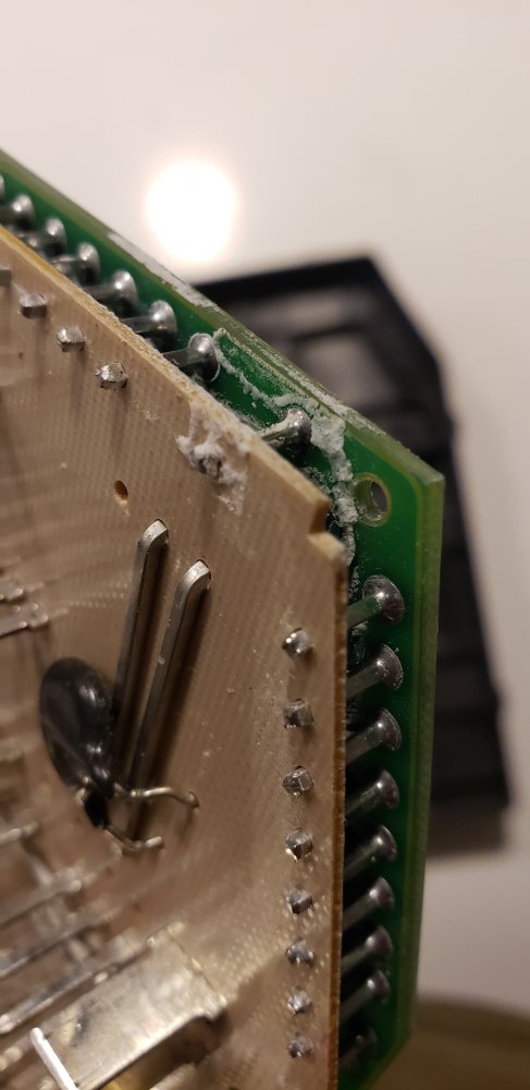

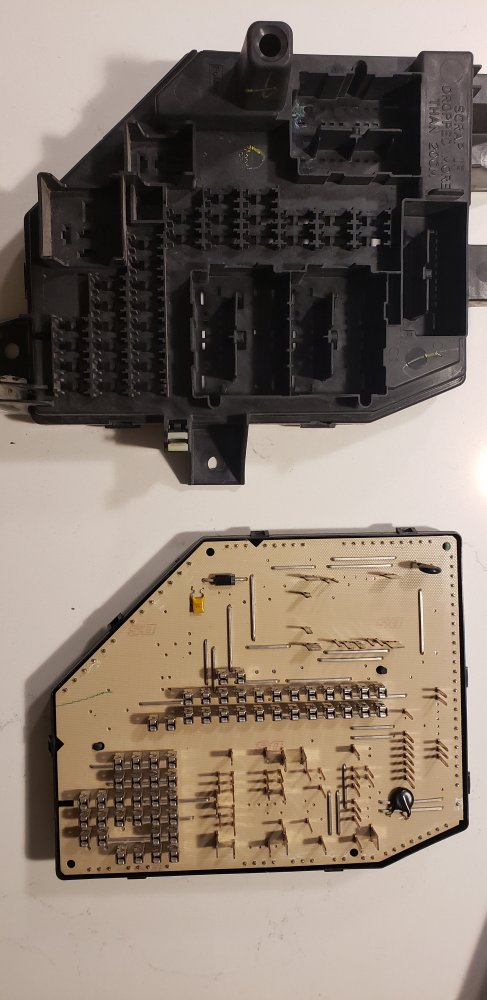

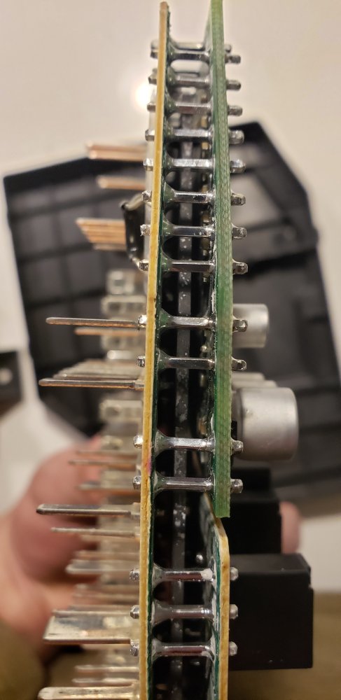

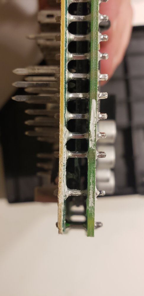

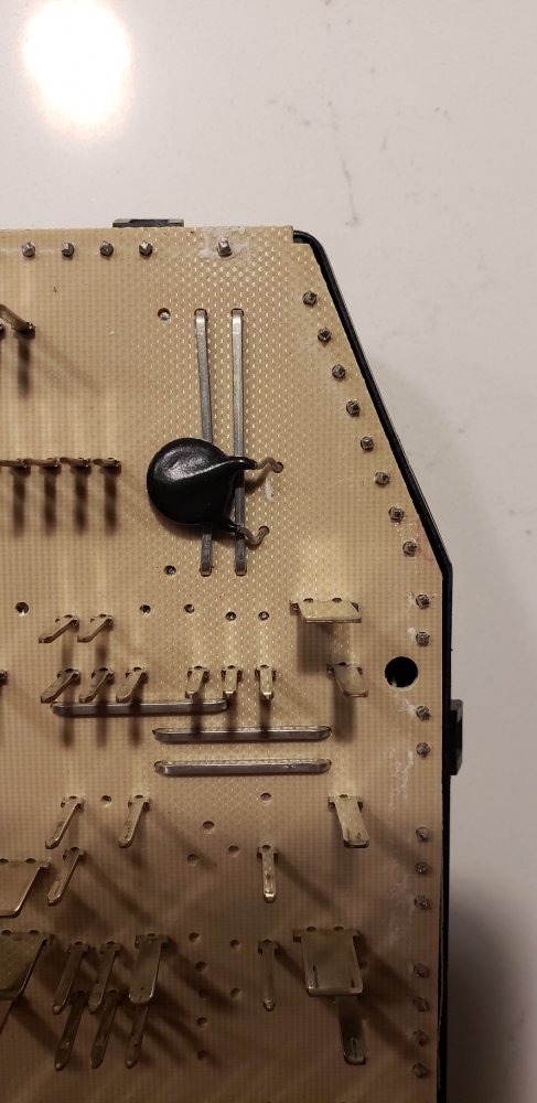

Well its not looking good moisture wise. I took the sjb out and it looks like theres corrosion between the layers. (Attached photos)
Any advice on getting what I cant reach with qtips out?

Yes, I think thats the problem
You can buy deoxidizer in a spray can, comes with a tube like WD-40 can, it can clean off corrosion residue without leaving minerals behind, corrosion is minerals(salts) that can conduct electricity causing shorts or lower the conductivity causing lost voltage
You need to spray it and let it drip out so you are not just transferring the salts to another part of the board
