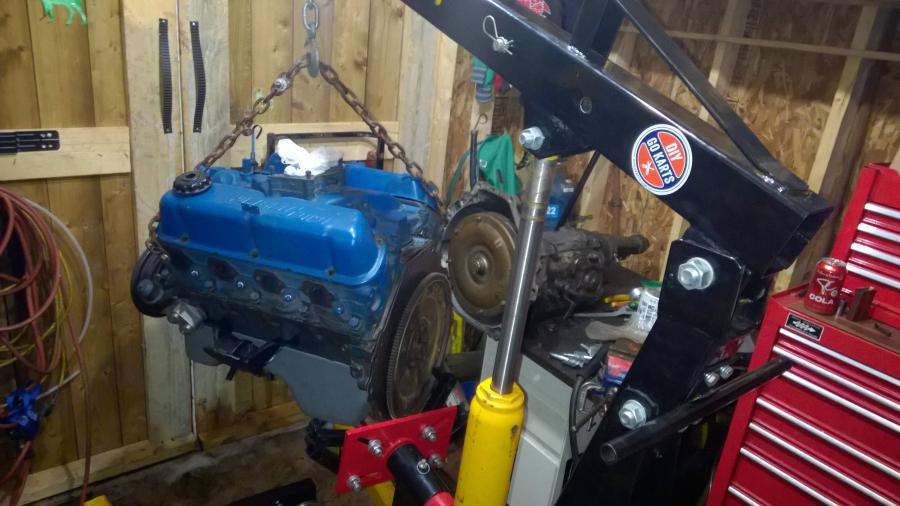

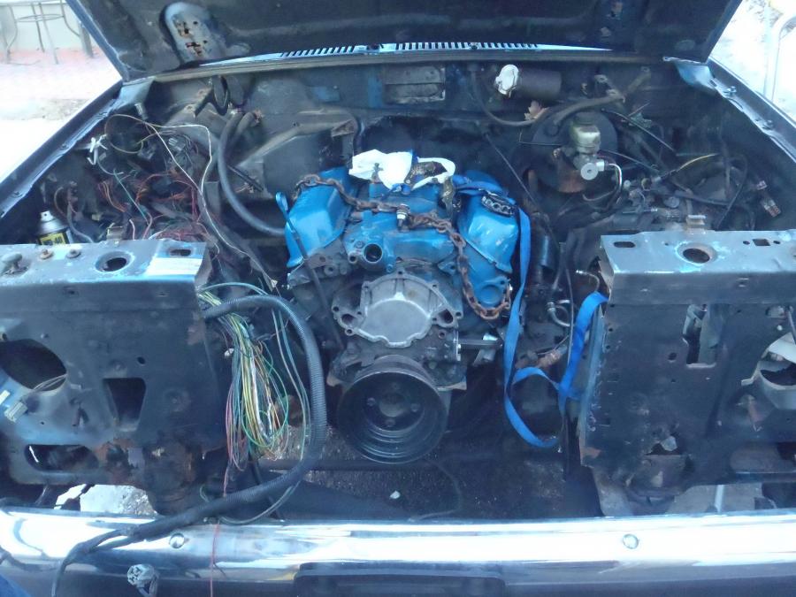

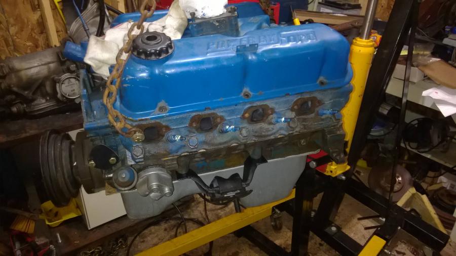

Got the motor prepped- oil pan, pickup, head gaskets, block-off plate for fuel pump, and oil filter relocation kit.

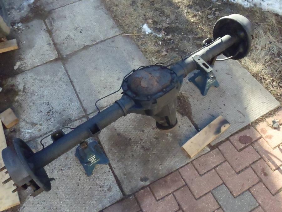

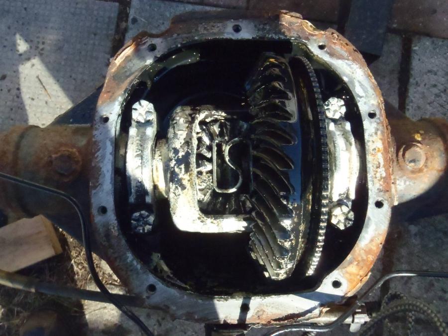

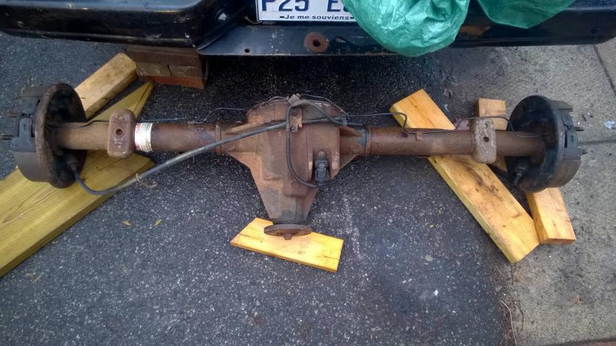

Also picked up an axle from an '06 ranger- 3.55 gears with LS diff, and 10" drum brakes. I havent taken the cover off yet to verify the LS and gear ratio, but its a good wrecking yard, so I trust it is what they say.

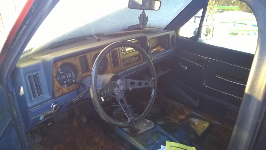

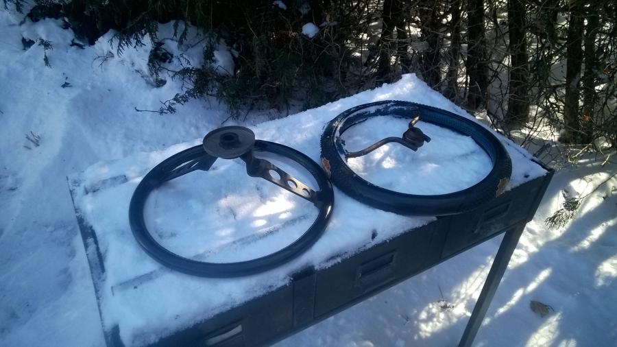

I also swapped in a steering wheel I got with the motor. Cut the hub and rewelded it from the stock one- man that was flimsy!

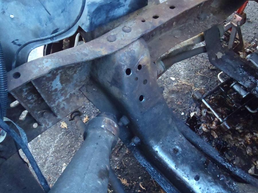

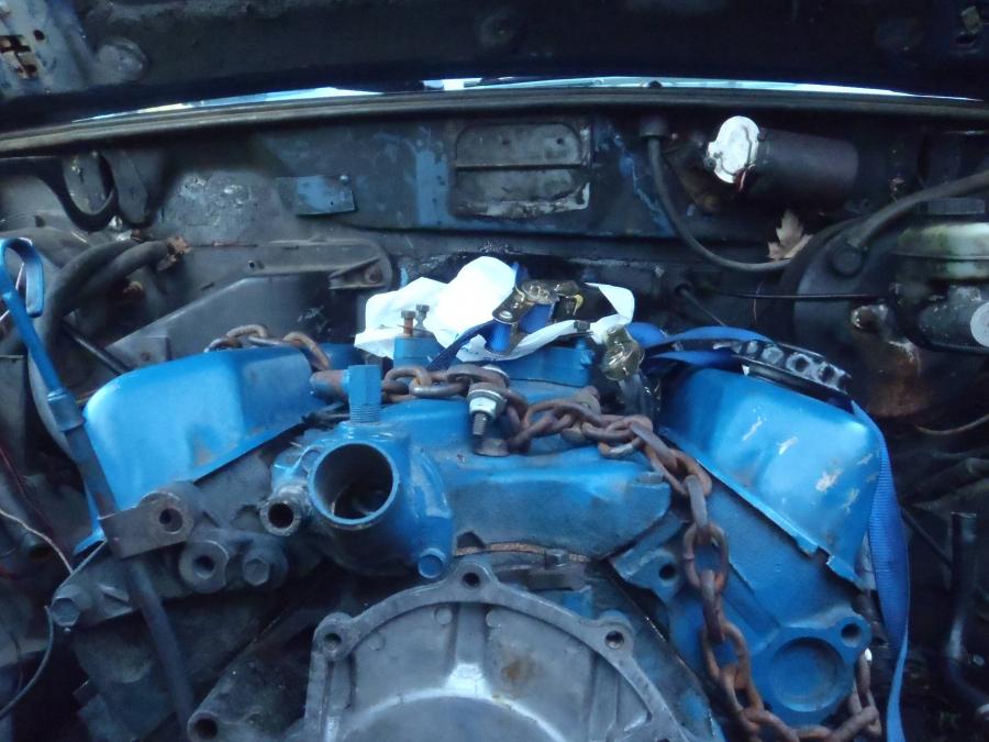

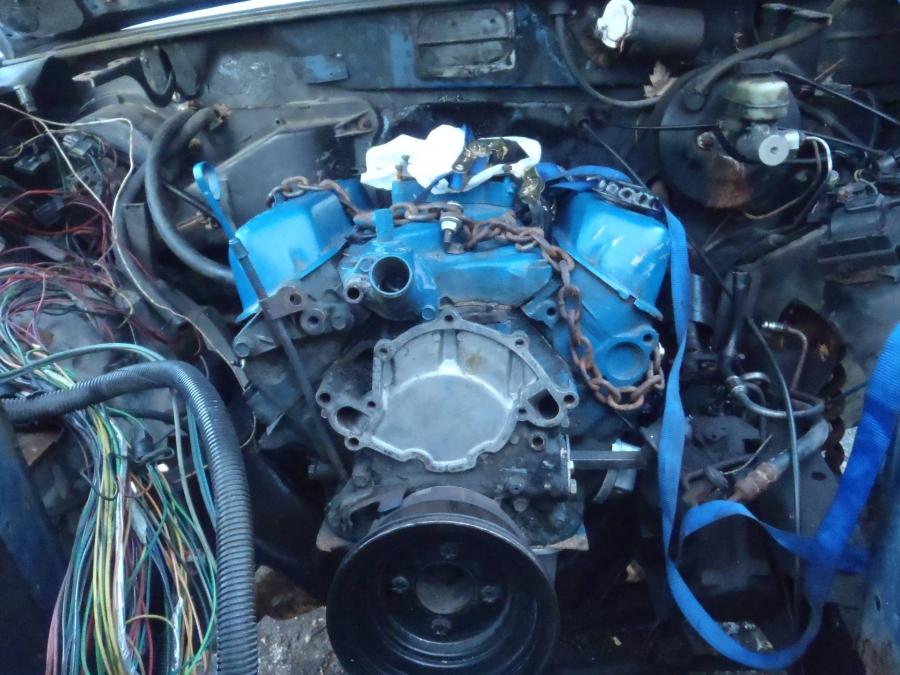

So I spent most of the day working on the truck, got a few things done and overall made some pretty decent progress. After managing to get the motor in using mustang convertible mounts, I definitely understand why someone would spend the $$ on conversion mounts. Drilling/ slotting the frame was a pain! And after all that, I'm going to have to shim the driver side up what looks like 3/8-1/2" to level it out.

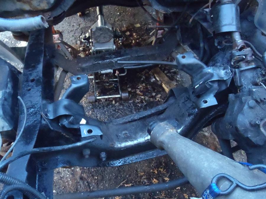

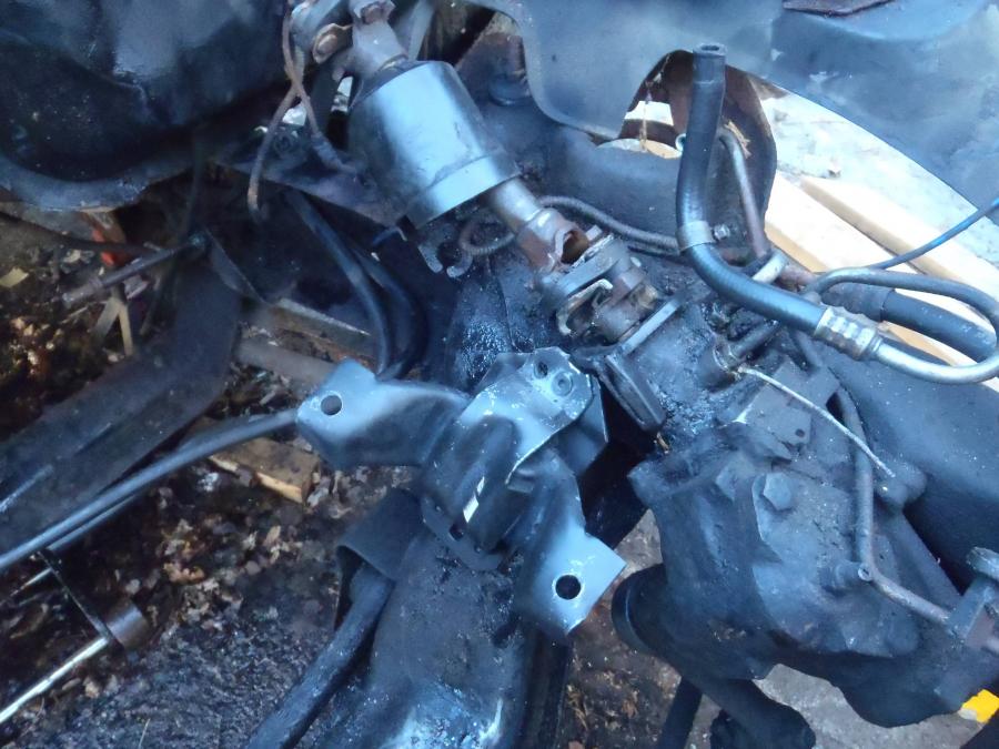

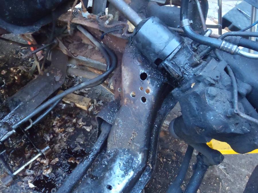

I had some trouble between the engine mount itself and the steering gearbox. Took some photos of it, not sure how other people have dealt with this, but I'm hopeful it wont be too much of an issue. I still haven't tightened the mount down yet, so I really don't know. The passenger side was much less dramatic, and I used the factory hole and enlarged it. Getting the nut on is a real PITA- I think I will have to unbolt the DS I beam and pull it out of the way for access.
I was hoping the trans mount would line up with the crossmember, but that didnt happen, so I will make a bracket to adapt the mount from the old A4LD to the tail of the C4.

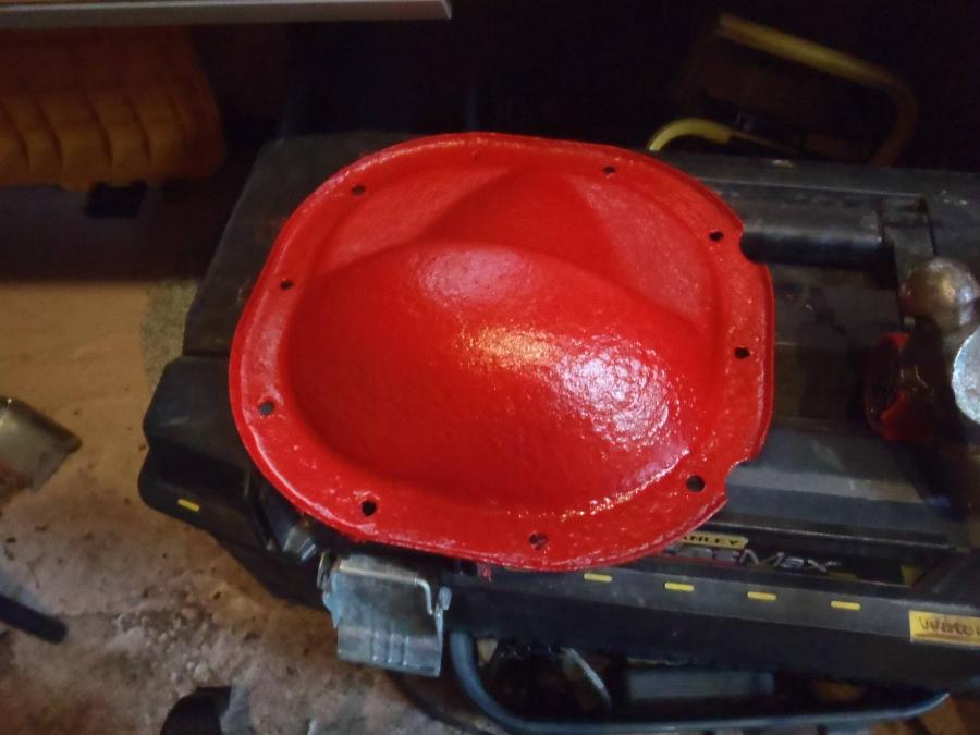

It was a nice enough day that I even painted the new axle and took the cover off to verify it is actually a LS diff. Diff cover was pretty soft and scaly, so I got another and cleaned and painted it.
I'll be back at it tomorrow, so hopefully more progress and another update!

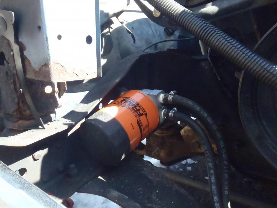

Got a little more progress done on the truck this weekend.

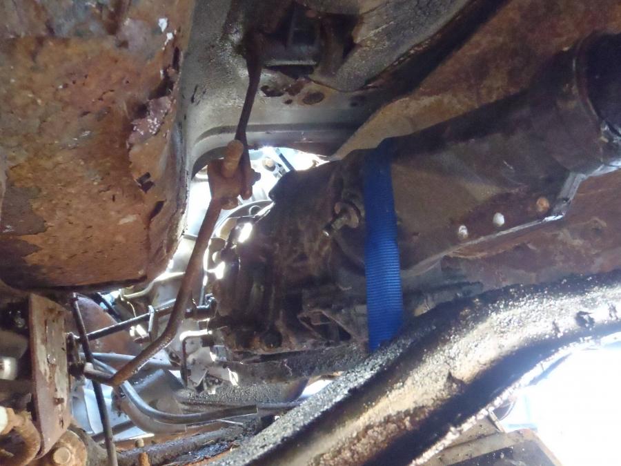

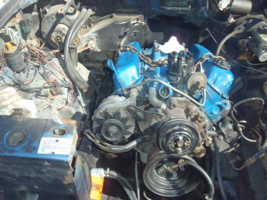

Leveled the motor out using washers b/w the motor and mounts. Had some clearance issues with the steering box, so had to shim it up substantially- pretty common I guess. Welded up an adapter bracket to support the tail of the transmission- just some 1/4" plate that bolts to the old trans mount and the holes on the tail of the C4.
I also started bolting on the water pump and alternator, got the transmission cooler lines attached, and mucked around with the exhaust that came with the motor. Mounted the oil filter remote kit to the pass side frame rail, just used an existing hole and 1/4" bolt w/ nylock- should hold. All in all pretty good progress.
The next thing I plan to tackle is the fuel lines. Ive heard I can use the stock in-tank fuel pump (low pressure) and just remove the high pressure pump from the mix. My thought is to run new rubber lines the whole way from the tank, add a filter, and run it up to the carb. I need to keep the evap system intact to meet emissions in Ontario, but can I lose the weird filter in the frame rails?
I was hoping to just ditch everything and make the system simple, wrap up the wires for the high pressure pump, really dont want to deal with the plastic fuel lines and connections. Was going to keep the stock fuel inertia switch intact for safety.
Is this the right way forward?:icon_confused: I know a lot of people run inline pumps and regulators, but since I have an '86 I would rather just use the stock stuff and save that $$ for other parts (B&M shifter!).

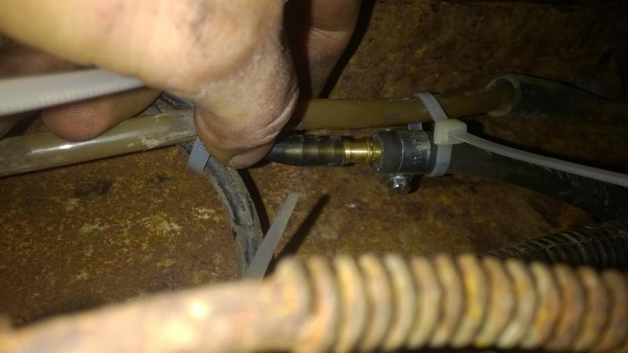

Fuel lines

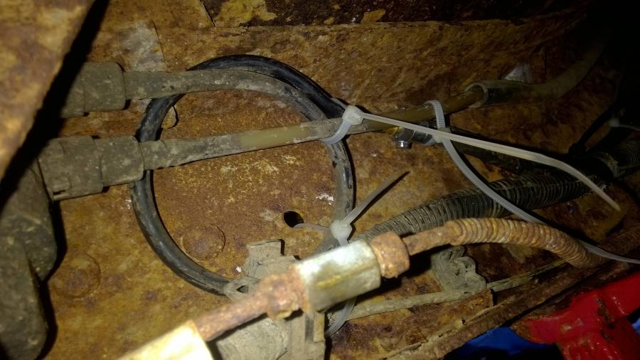

Spliced into the fuel lines today. Decided to splice after the fuel filter, just pulled the high pressure pump out, soaked the plastic fuel line in warm water, and slipped the hose over a barbed union. Then ran some 1/4" rubber line up into the engine bay. Zip-tied it along the frame rail to keep it away from the exhaust. The union only went in up to three barbs (3/4 aint bad), but it was so snug, I still feel pretty good about it. No clamps small enough though- might have to order some or just power up the fuel pump and cross my fingers.
I was thinking of running another filter inline in the engine bay. Whats with that weird plastic housing fuel filter? I guess thats where the fuel return line runs to?
Anyway, thanks for the response recutright- I was a little worried that the 1/4" lines wouldnt cut it.
Snapped some pics while I was under there. heading to junkyard tomorrow to try and find a driveshaft.
