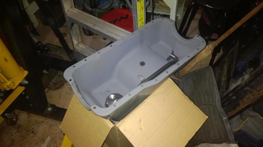

Did you get a new oil pickup?
I guess one could always modify the pan to accept a dipstick...
Yes, same exact kit....I think I paid 180 from summit. Free shipping. When u put the new pick up on it, ull need to make sure u pull the right cap bolt and make sure to torq it back to spec...I think it's 85 ft lbs. Then, the gasket can be a pain but take ya time n it'll seat properly. Ull get it.
Moose, That Is The Kit I used. I'm in a very similar situation as u. My block uses the front timing cover for oil dipstick and the pan does not have a provision for it. I left my front dipstick as is and since it's a fresh build I figured as long as oil looks clean and in the front sump, it should be ok. I do have to trim my original dipstick as it now bottoms out on the front sump. Just make sure u got 5 qts in that mojamma and call it good. If there is another way for us to get the rear sump dipstick, I'm all ears.
Order a pan for a '79 Mustang 5.0. That kit only has the dent in the side to kinda locate it, everything else is for the later block mounted setup.
When I was going to build a '78 302 for mine I ordered that kit and sent it back when I saw someone was too generous with what it would fit.

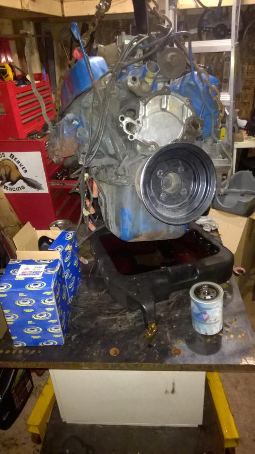

Got the oil pickup today, so i decided to drain the oil and get ready to swap the pans.

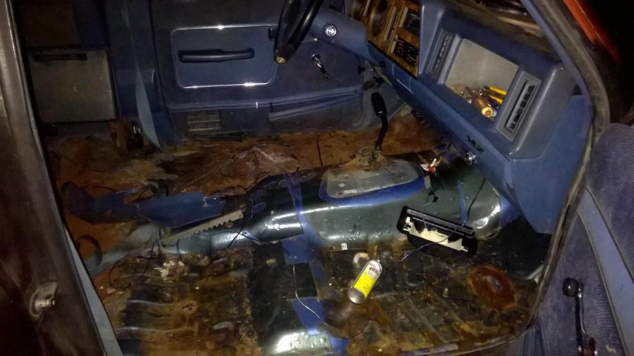

Ripped out the carped this past weekend, and discovered a bunch of rust. Just need to order a relocation kit and some gaskets, then should be ready to drop in.

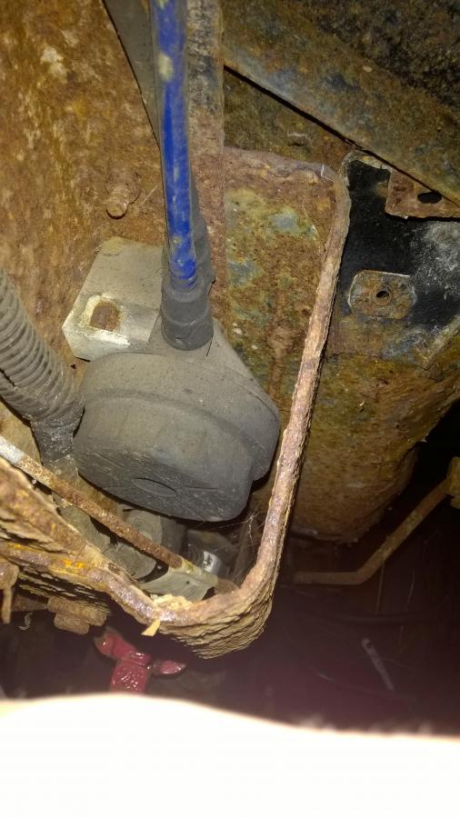

fuel pump
Im guessing the silver cylindrical object is the FP.
Looks pretty scaly under there, eh?

Ah man...that looks like mine all scorched up from the snow n salt life. As long as it's not rot, I think you'll be ok.
