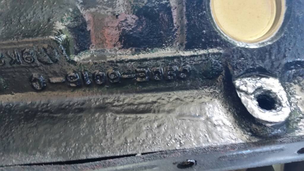

Moose, remove the starter and the cast stamping is above that.....here's a pic of mine
pryme... can't see that photo.
Starter is off, so casting number should be there on the right(pass) side? Do I need to pull the heads? Manifolds?
Yes, it's on the bottom of the block, like you need to look up when the starter is out. Headers need to be off too. Heads can stay on.
Great! Thanks. I am picking up the oil pan tonight, then will post a pic of the casting code.

Engine block code
Found the engine block code, looks like:
D10E-6015-AA
Will get pic up in a minute.
Is this a '71 motor... or do all 70's motor bear this code?
I was told it was a '74 from the guy I bought it off of.
EDIT: I went back out, the second line of the casting has a semi-spherical protrusion followed by "1F1"
That block casting number was used from 70-74. Above those numbers would be the casting date (a number, letter and two more numbers)it was poured (I don't see them in picture). The heads were just about all the same from '68' thru '76', same valve sizes and combustion chambers. The big difference was in the deeply dished pistons used '73-76' that dropped compression one point. Further was the deck was raised ,023" resulting in a 8:1 compression. The crankshaft also had its timing retarded a couple degrees. The new oil pan you ordered better have access for the dip stick, yours in now in the front cover and won't work. 79 Stangs had the one you need.

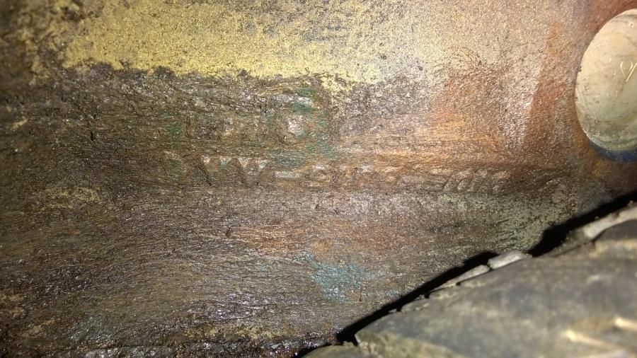

Picture of date code. May 1, 1971?
More like 1 June 71 but that means it not the heavily smoged motor. Dave
