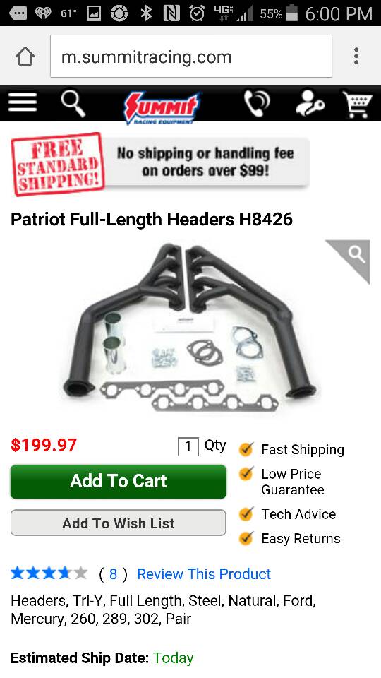

getting some more out of the engine, the carb will def help..Letting it breath well exhaust wise will help max it out with out going over budget here since u said ur going with some flows. Header clearance may be an issue but I've read that some of the older stock 302 manifolds worked. If they don't, grab some patriot long tubes:

These so far have cleared everywhere for my build. If u have the 157 th bell housing then they "should " work for u.

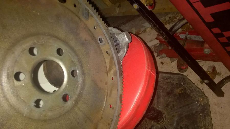

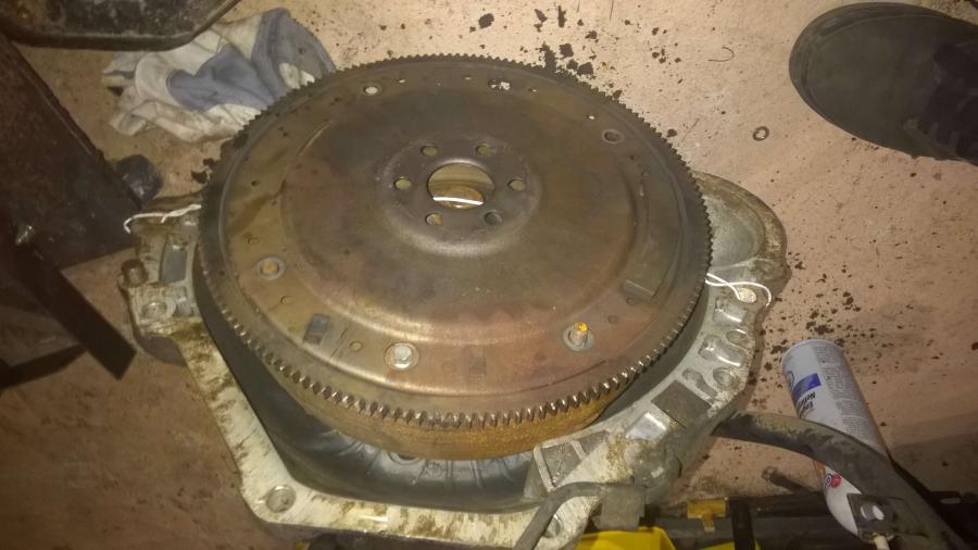

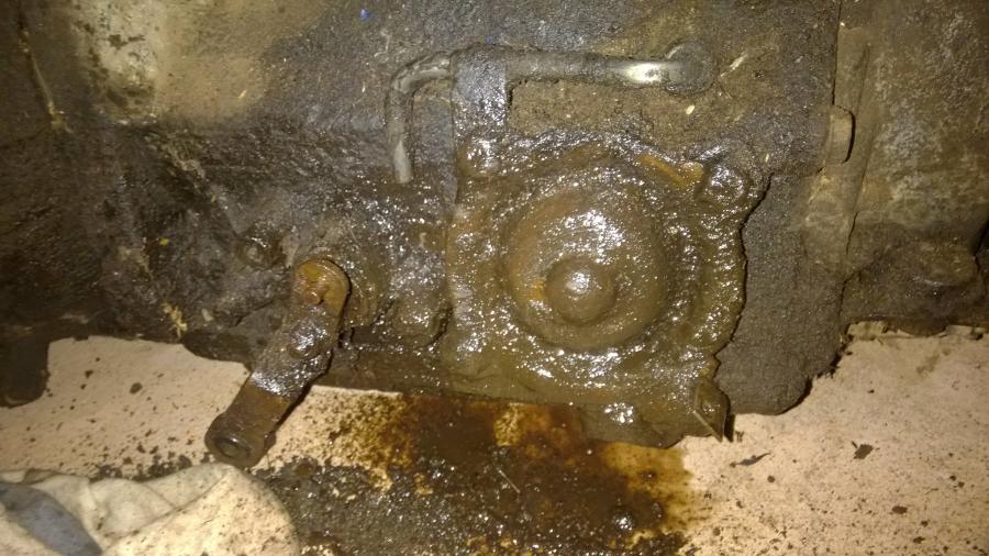

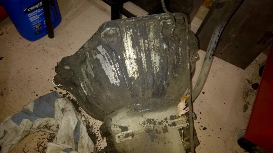

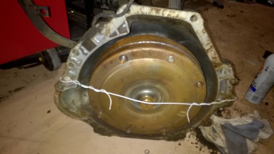

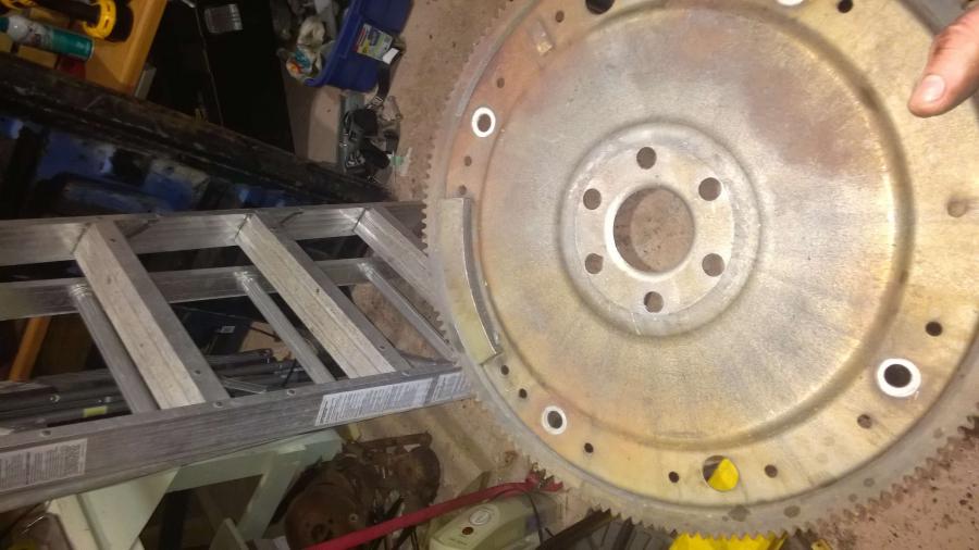

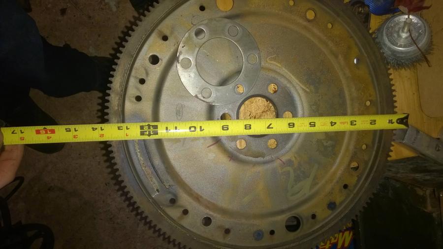

Took some pictures of the transmission. Doesnt appear to have a tag on it, but I was in work clothes so not going to get too crazy with the engine-brite. Measured the flexplate- hope I dont have to count it!

Moose, thanks for posting the pics. Looks to be the 157 th bell housing on the c4. It appears it may be missing some side linkage, not sure but looks alil diff than mine. Does it fill through the case or pan? I am not sure on the flex plate measurement. The lil ring is the reinforcement plate ford recommends. Goes on the outside of the flexplate to help reduce stress on flexplate.
Edit, I see it's a casefill. Think ur good there man. [emoji106]

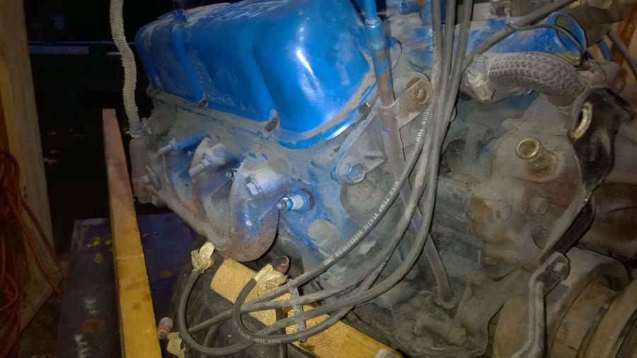

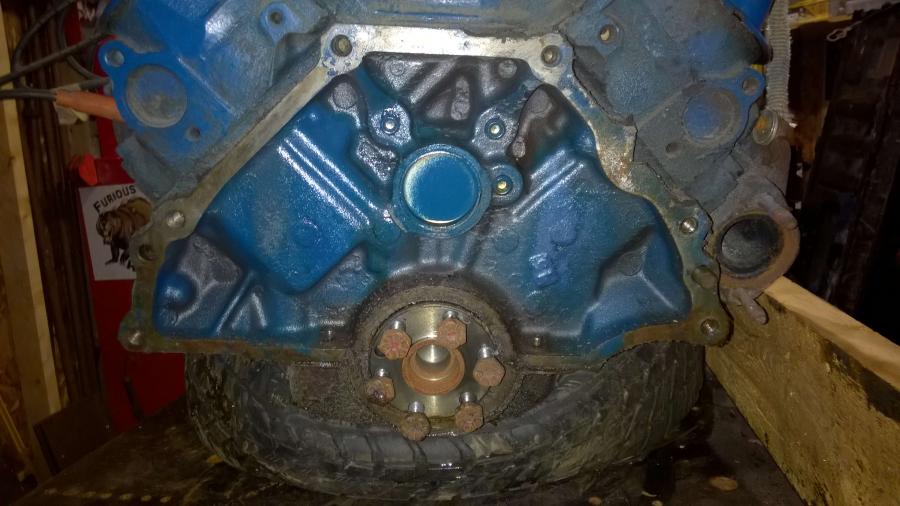

Heres what im working with in the engine department.

Heads up, if ur engine has a front sump pan on it like mine did, assuming since u ordered up the dual sump, check to make sure it comes with a new pick up, you'll need it so the pump picks up oil from the deep side.

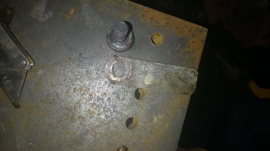

Found the tag! On the other side, not sure how i missed it. Will try to decode later. Also just test-fitted the fleplate to converter, and flexplate to starter. Starter pinion fit, but I'm not 100% on it. i would assume if thats what the guy had on it, then they would be matched. Oh well.

Trans might be a 68? C8? Does the flex plate clear all around? If so should be good. I've heard u can't use a stock starter with thr 157 th. Get a high torq mini to solve thst issue
Identifying my engine
Okay- so Ive been working on this and that, trying to find parts, and trying to identify my engine specs.

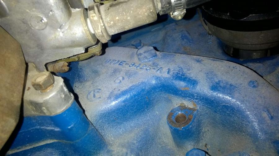

Here is what I have so far- Exhaust manifolds (D0AE-9481-L) 1970
Intake- (D10E-9425-AA) 1971
Carb- (D2AF HA) 1972, 2 bl
Found a stamping on the back of the block (not cast) with 2F103815 (serial number)

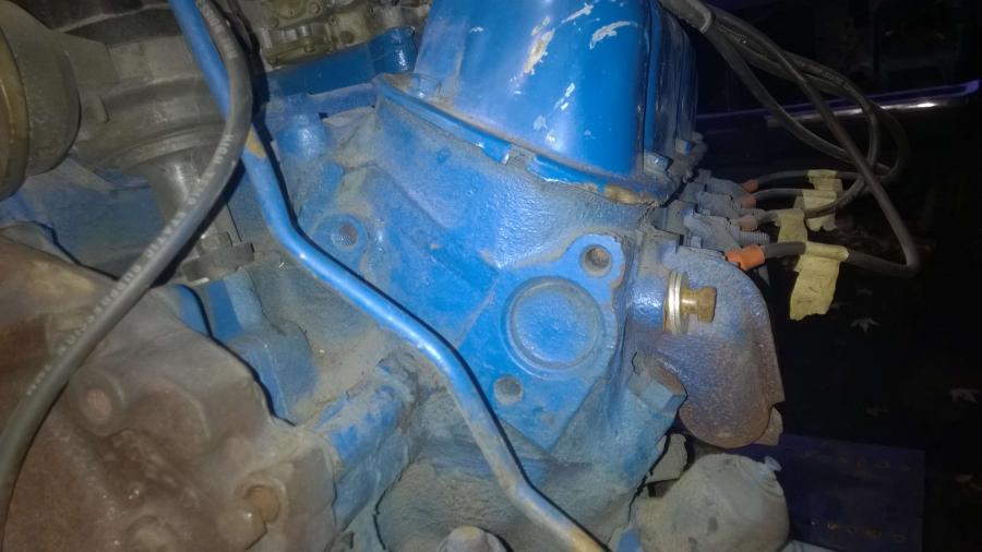

Thinking this engine is a mix of different parts. Where is the engine casting number? Couldnt see it easily (maybe the way I have it on the bench).
essentially all 302 are similar. its really the heads that sets them apart. the casting for them is under the intake flange. so you would have to pull a head to see what you have. 69-73? are the most desirable (except for the new roller 5.0s) to hot rodders because they have higher compression pistons.
Moose, remove the starter and the cast stamping is above that.....here's a pic of mine
