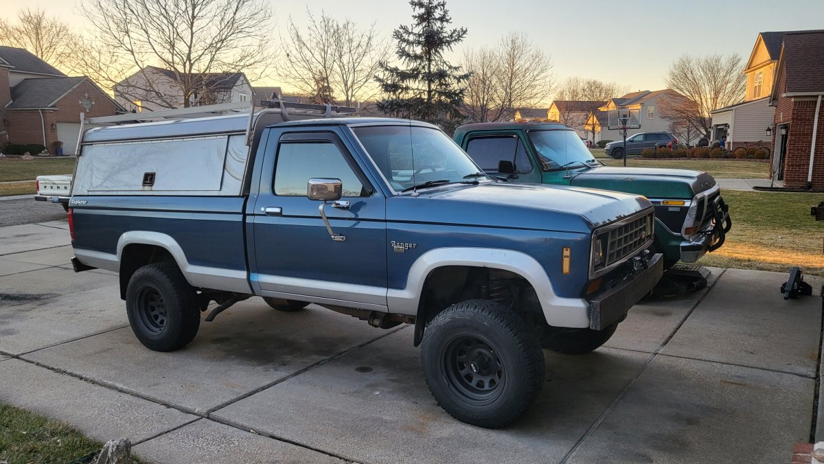

Heres a pic of pile of shit in question.
  • im desperate enough to make my own thread. 1988 ford 2.9 nightmare, need help getting it to run.
