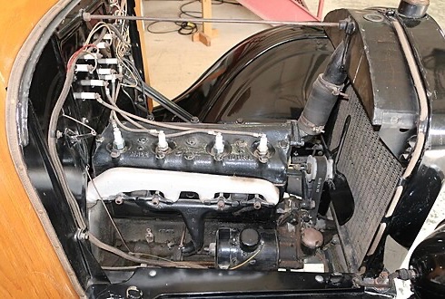

Flathead ford from a model tt ford truck. 201 c.i.d.
Now that would be a sight!
