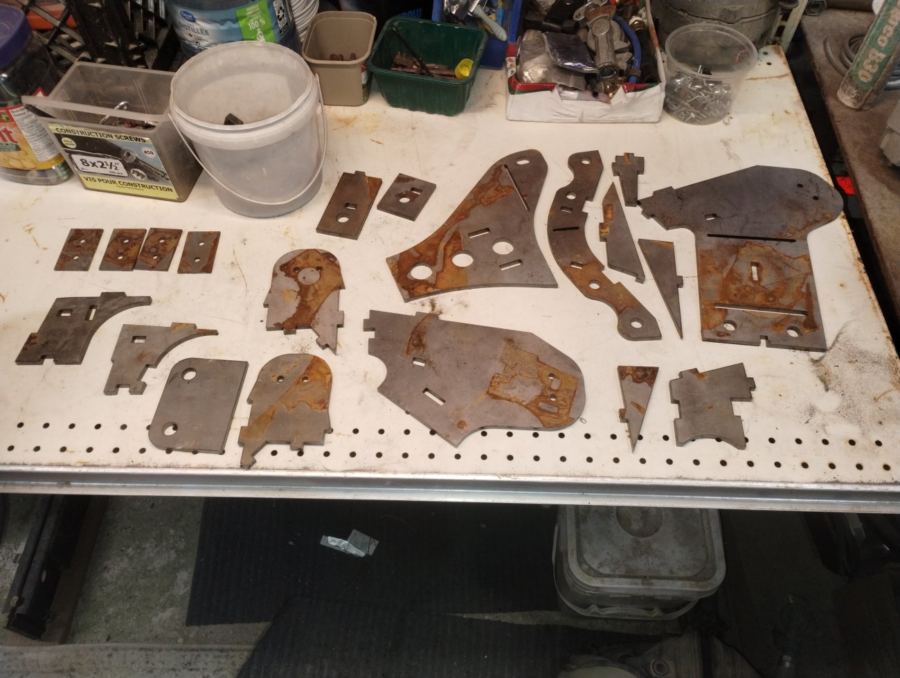

I read every post but somehow I am not seeing what you want cut on a plasma table?
My brother-in-law has a plasma table (he turned an invention into a business and has been going crazy with the work, hired a machinist and still barely keeps up)... I bet he would consider doing something like this en mass if there was at least a tiny profit in it for him (he would of course have to cover the machinist's time, etc).

Its a weld it yourself kit for putting in d-35 or d-44 TTB beams into your ranger.
What kind of demand is there for this... "2 kits today, and 5 more maybe"... crank out 50 or a 100 and sell em wholesale to Jim who then would be the retailer?
The only two decent kits you can get for a 1983-1997 Ford Ranger is the James Duff and Skyjacker kit. I wouldn't be surprised if Skyjacker doesn't eventually drop their kit. Rough Country and BDS sells a kit, but they use a plate to drop the bracket above the differential for the passenger beam. I don't recommend those. We could end up in a position of no real options.

Ya, that's not the set I worked on with him. Joels an engineer. I like how he notched them to fit together as you weld them. Makes them easier to position and weld. The only thing I don't like is that one of those pieces needs to be bent in a press.
Damn, those pieces have to be 15-16 years old.
Press from Harbor Freight and press brake from SWAG and that becomes a simple task.
If you wanted to bring them by, I can slam them into CAD for cutting and make some assembly drawings. (Not wanting to take away from Joel, but 15 years later...)
