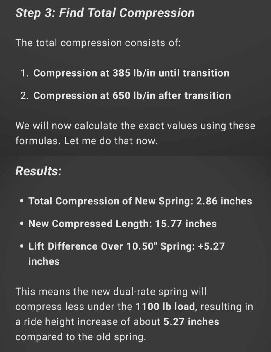

I asked ChatGPT;
# Given values
initial_length = 18.625 # inches
soft_rate = 385 # lb/in
stiff_rate = 650 # lb/in
applied_force = 1100 # lbs
compressed_length_old = 10.50 # inches
# Step 1: Find transition force (force at which soft rate bottoms out)
# Assume transition force is approximately when soft rate section fully compresses.
# Transition force = soft_rate * compression until transition.
# To estimate, we'll assume a reasonable transition point.
# Let’s assume transition compression happens around a third of total compression.
# We'll refine this if needed.
transition_force = soft_rate * (initial_length / 3)
# Step 2: Compute compression in soft and stiff rate sections
if applied_force <= transition_force:
# The force is within the soft rate range only
total_compression = applied_force / soft_rate
else:
# First, compress fully at soft rate
soft_compression = transition_force / soft_rate
# Remaining force for stiff rate section
remaining_force = applied_force - transition_force
# Compression in stiff rate section
stiff_compression = remaining_force / stiff_rate
# Total compression
total_compression = soft_compression + stiff_compression
# Step 3: Find new compressed length
new_compressed_length = initial_length - total_compression
# Step 4: Find lift difference compared to old compressed length
lift_difference = new_compressed_length - compressed_length_old
total_compression, new_compressed_length, lift_difference.
if only that actually happened.
