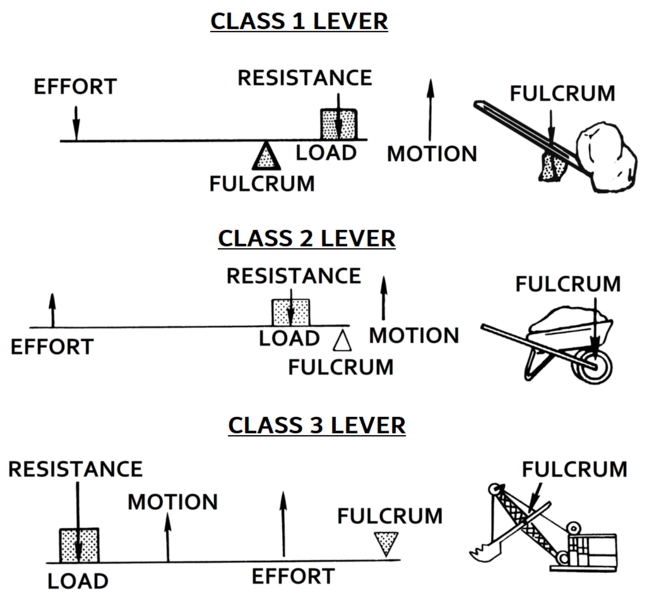

The TTB would be considered a Class 2 Lever:
Resistance = Coil Spring
Fulcrum = TTB Pivot Axis
Effort = Weight of the Vehicle on Wheel (it pushing the wheel upward into the fender)

(emphasis mine)Wikipedia said:A lever is a simple machine consisting of a beam or rigid rod pivoted at a fixed hinge, or fulcrum. A lever is a rigid body capable of rotating on a point on itself. On the basis of the locations of fulcrum, load, and effort, the lever is divided into three types. It is one of the six simple machines identified by Renaissance scientists. A lever amplifies an input force to provide a greater output force, which is said to provide leverage, which is mechanical advantage gained in the system, equal to the ratio of the output force to the input force. As such, the lever is a mechanical advantage device, trading off force against movement.
Wikipedia said:Class II – Resistance (or load) is located between the effort and the fulcrum: The effort is applied on one side of the resistance and the fulcrum is located on the other side, e.g. a wheelbarrow, a nutcracker, a bottle opener, a wrench, and the brake pedal of a car. Since the load arm is smaller than the effort arm, the lever's mechanical advantage is always greater than 1. It is also called a force multiplier lever.
