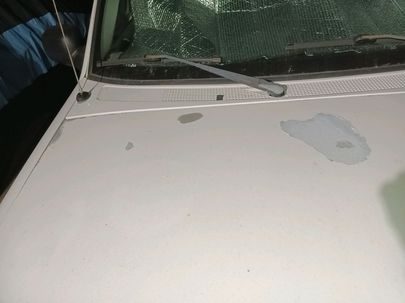

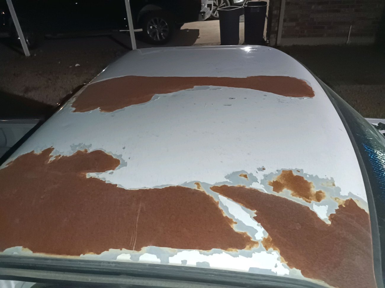

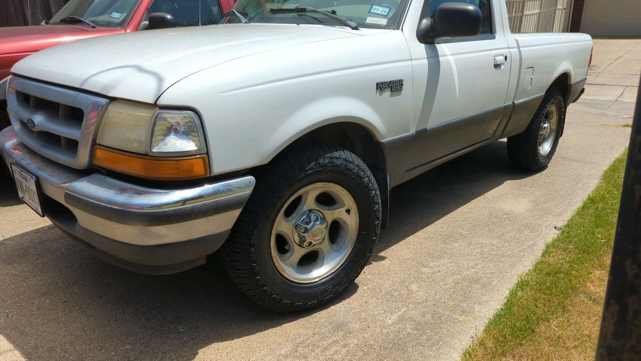

A shop quoted $800 to paint just the hood and roof of this 98 Ranger. That's just not feasible. Am more more interested in DIY solution. I don't have a problem to sand and paint. Is there a spray can manufacturer who makes color matched paints? If not what are your ideas on how you can go about to get this painted. I am prepping the truck for sale shortly.

View attachment 139143View attachment 139144
Everyone knows I’m a rustoleum nut.
What would the truck be worth with a cheap paint job? I’m assuming the 800 would throw you down instead of bringing you up
Sanding it isn’t all that hard. sanding it to get a mirror finish can take a lot of time. No joke, I’ve painted a couple of my trucks with rustoleum with a foam roller out of the can. After red primer, you thin down the rustoleum about 1/3 mineral spirits, and you roll it on on a 65° day when it’s not sunny. That lets it spread out without running. Then two coats of full strength, all four hours apart.
For that white truck, you can try just doing white on the hood and on the roof, but it’s probably going to look different. But it will look 1000% better than it does now.
The other thing you might do is do the hood and the roof in a complementary color. If the interior is red, maybe use red, use blue for blue, you get the idea.
Then put some pinstripes on the truck (dirt cheap pinstripes). The pinstripe pulls your eye, instead of the eye going to defects in the paint.
Almost no matter how carefully you do the rustoleum you will end up with a little bit of orange peel, but I get nothing but compliments

you’re also talking about $30 versus $800, and I know you’ll get the 30 bucks back easy
With the rustoleum, you can do a final sand with a 100 grit and the paint will fill. Wet sanding you’ve got to go down to 2500 with block sanding. Fortunately, white is very forgiving.
And a thought on the complementary color. Restoleum has about 12 standard colors. If you want a lighter version of one of the colors like the red or the blue, just buy a can of white and blend it yourself.

As for how to fix it. Either spend the money and pay someone to do it, or get out the rattle cans. I'll agree with what Rick said if you want a cheaper fix, though I'd probably spend a little extra for color matched top-coat spray cans, instead of generic rustoleum colors. I probably wouldn't try that on a metallic like the silver on dad's truck or my '99's metallic gray (Medium Platnum Metallic?), but a solid like white shouldn't be too bad to get nice.

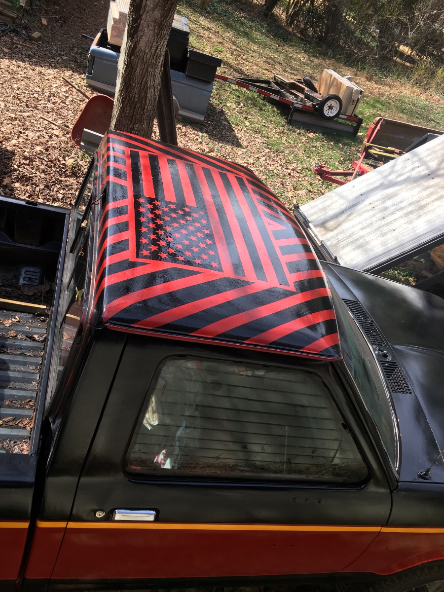

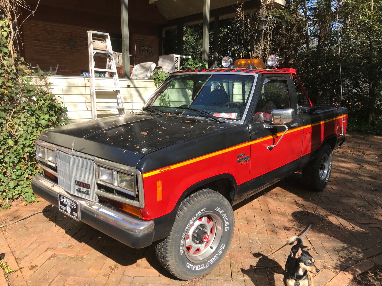

As truck is a 2 tone color scheme, is a black roof ridicoulous idea, especially with bedliner paint? I plan to bedliner spray the bed.
How to fix peeling hood & roof top paint
Definitely seen some nice two tone Rangers with same color on rocker and above upper body line. That is including top of fenders, hood, top of doors, top of bed, etc. Not sure about roof only on a Ranger, it doesn't have the hard separation that other trucks rocking roof only have.
Is the lower color black, is it bedliner too? Black and white with black roof would be unusual, but might not look bad. Not sure about black bed liner though. Never seen that combo, and usually the bedliner is down on the rocker portion, not on the roof.

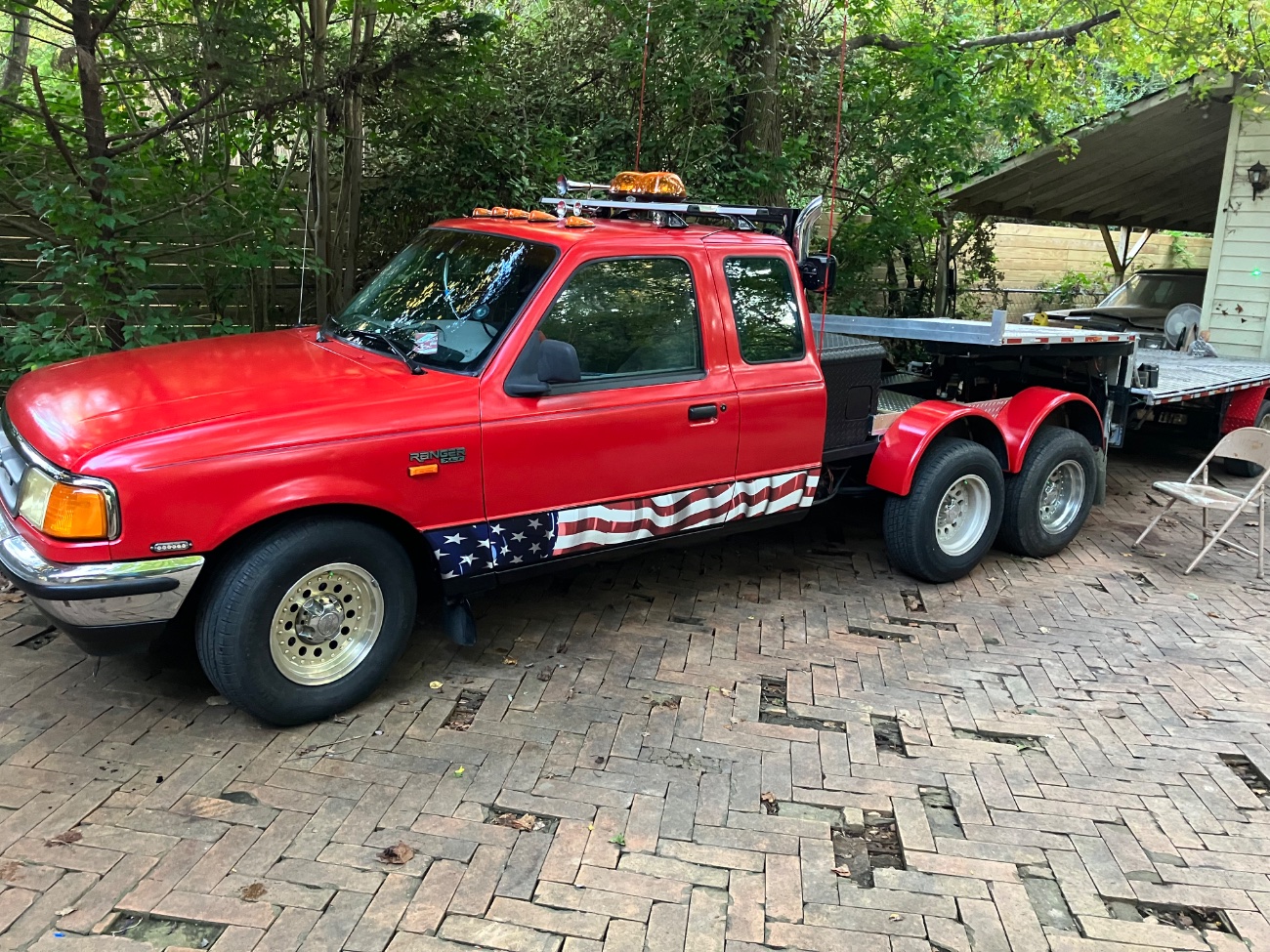

A little bit of masking tape and you can do something that looks like it did it on purpose, and not just to cover up the rusty spots. I did have a stencil for the flag parts, but everything else was pretty much just eyeball measure and some masking tape.

Advanced auto and napa make color match paint in spray can form. Which I'm sure you must 1 have one locally. Theres alot of diy videos on YouTube to help on paint and body which will help u make a decision on which way to go. It's not difficult but time consuming. I guess it all depends how much you want to save yourself and how much is your time Worth.
@svtcards
Thanx for sharing that idea. A local Napa store will color match it, and will put it in a 12oz rattle can for $25.49 or a Pint for $68. Followed by 2-3 cans of 2k clear coat. Or does any one have a different suggestion on clear coat?

That roof top is awesome, I love it! Thanx for sharing, definitely got my imagination juices flowing.
@JoshT The lower is just paint, it wasn't a real black but a couple of shades removed.

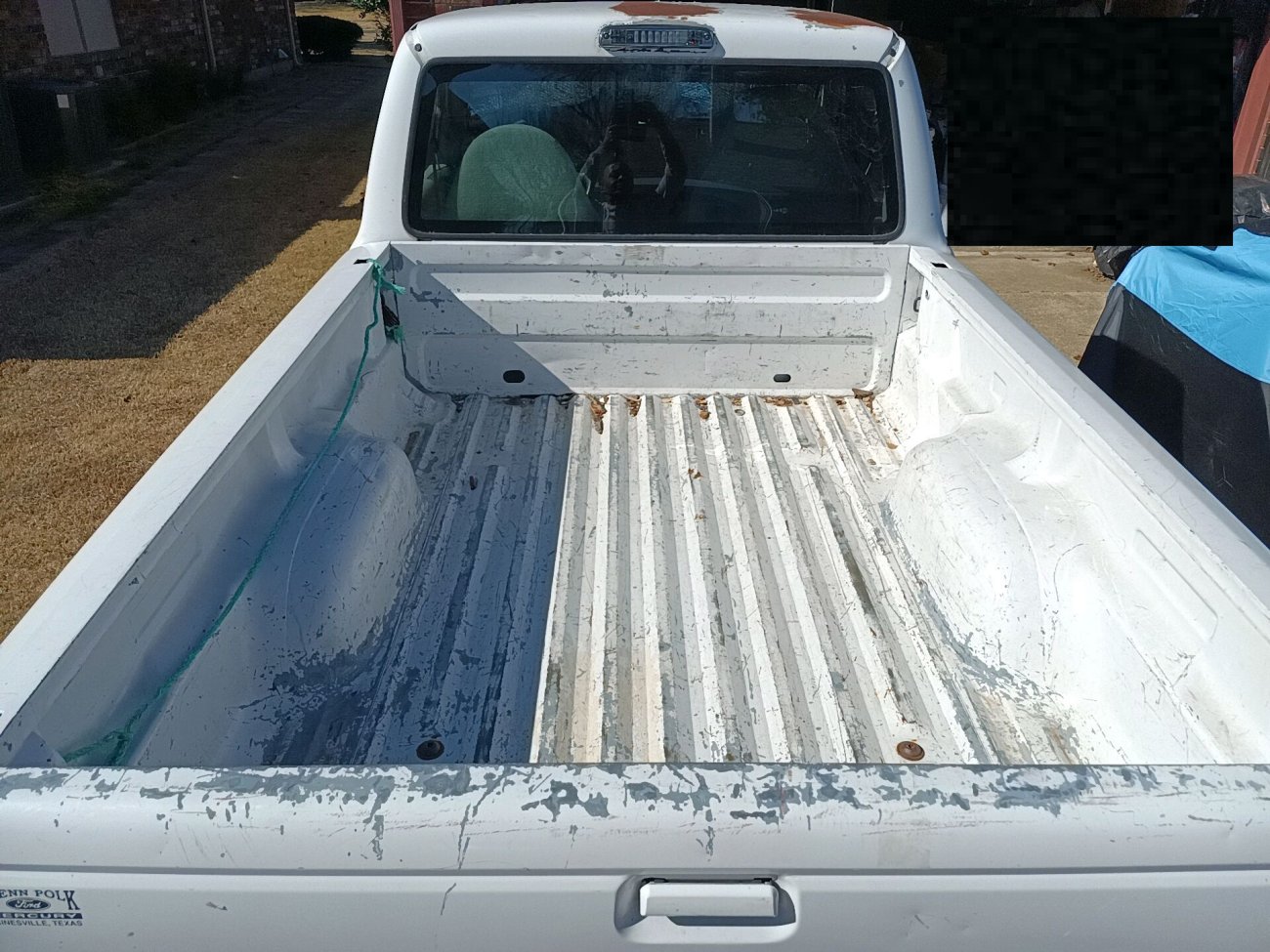

I want to give some TLC to the bed, basically the entire inside plus top lip of the tailgate. Questions are...
1-

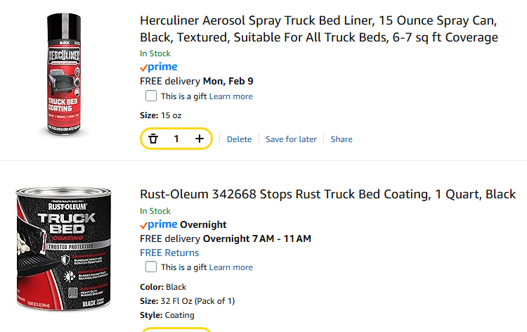

How many spray cans of bedliner will this bed take?
2-
Alt. is the roll on type. It's a quart. How many of this does the ranger bed need? This is a STD cab 6ft bed.
I used the spray on stuff on a set of steel wheels. By them time I got enough coverage to mostly hide the rust, I'd used 8 cans on 4 wheels. Woulda been just a as cheap to get better wheels.
I talked to my boss who does bedliner a lot. He said primer and 3 bottles. The bottles look like quart size. The pic is old stock that comes in a gallon can.
