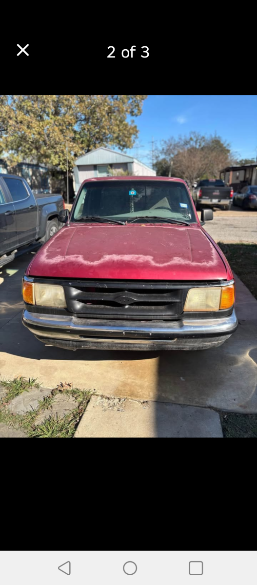

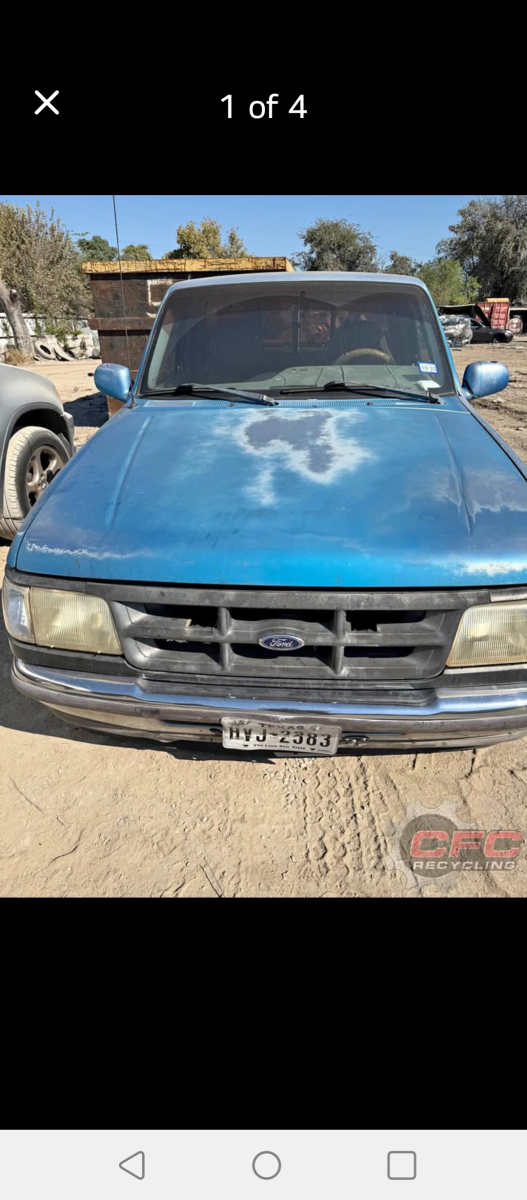

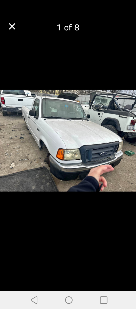

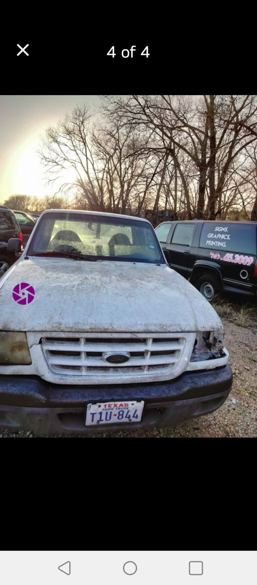

The chrome is delaminated a little bit but it's gross enough that a better replacement from $80 to $150 at JY is worth it. Question now is are these bumpers the same for 1995 to 1998 and/or 1998 to 2004?
I have found a 1994, 1995, 2003, 2005. I plan to hit the JY on Friday. Just in case these is all they have it will be good to know if these do fit my 1998
1994

1995

2003

Is anyone able to confirm which or if the bumper years above can fit on my 98 Ranger?

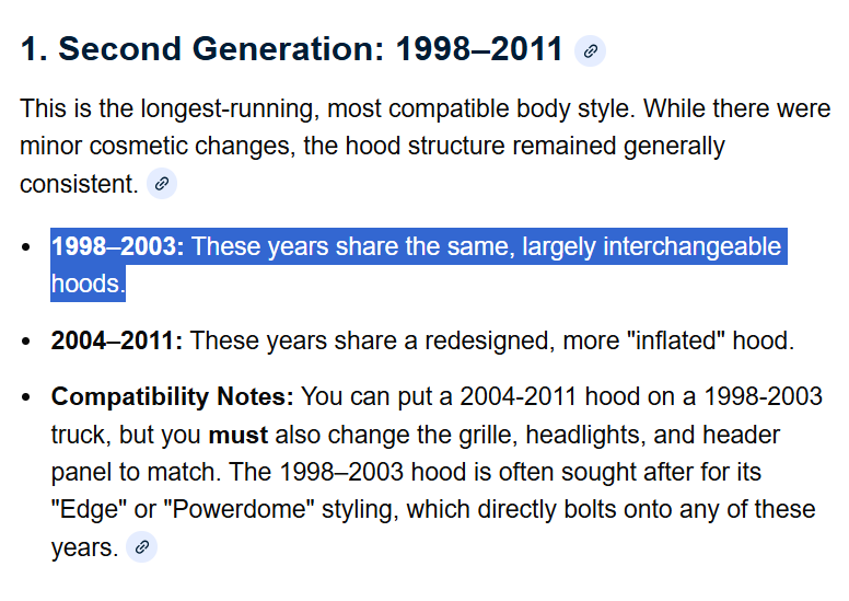

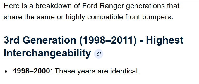

HOODS
How to fix peeling hood & roof top paint
  • How to fix peeling hood & roof top paint

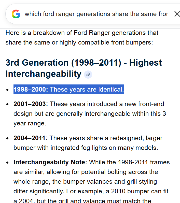

So, it looks like only a 98 to 2000 bumper will fit it. Is that your conclusion too?
If you’re asking, if later model bumpers will fit, I don’t know the pieces and parts well enough to answer that. But put the question out again, there are some of these guys you know the details a whole lot better than I do.
Yes. I will keep it simple and stick with those years to eliminate wrong fit, returns, etc. when I head to JY sometime this week.

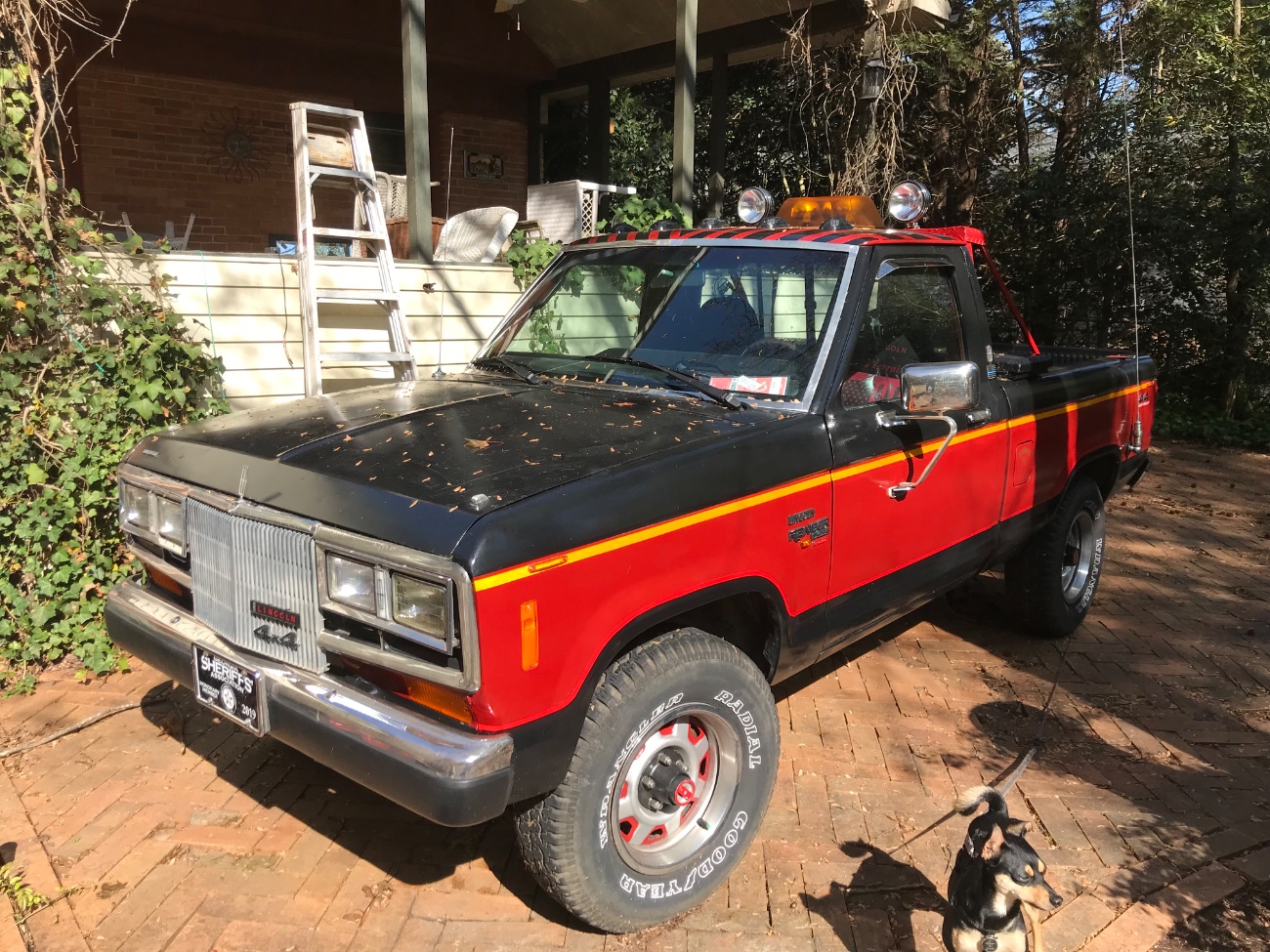

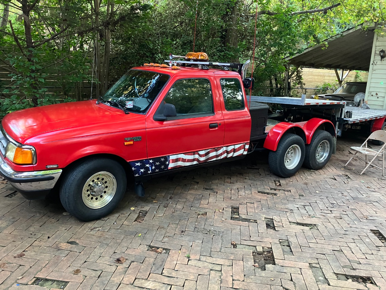

Sanding it isn’t all that hard. sanding it to get a mirror finish can take a lot of time. No joke, I’ve painted a couple of my trucks with rustoleum with a foam roller out of the can. After red primer, you thin down the rustoleum about 1/3 mineral spirits, and you roll it on on a 65° day when it’s not sunny. That lets it spread out without running. Then two coats of full strength, all four hours apart.
For that white truck, you can try just doing white on the hood and on the roof, but it’s probably going to look different. But it will look 1000% better than it does now.
The other thing you might do is do the hood and the roof in a complementary color. If the interior is red, maybe use red, use blue for blue, you get the idea.
Then put some pinstripes on the truck (dirt cheap pinstripes). The pinstripe pulls your eye, instead of the eye going to defects in the paint.
Almost no matter how carefully you do the rustoleum you will end up with a little bit of orange peel, but I get nothing but compliments
View attachment 139145View attachment 139146
You can see how the pin stripe graphics pull your eye off the flat surface of the paint
you’re also talking about $30 versus $800, and I know you’ll get the 30 bucks back easy
With the rustoleum, you can do a final sand with a 100 grit and the paint will fill. Wet sanding you’ve got to go down to 2500 with block sanding. Fortunately, white is very forgiving.
And a thought on the complementary color. Restoleum has about 12 standard colors. If you want a lighter version of one of the colors like the red or the blue, just buy a can of white and blend it yourself.
my two cents, I hope it helps
I'm assuming you build these trucks just for the reaction? Im not sure "noting but compliments" is the correct statement for those two truck. The pinstripes do noting to distract from the paint. Dirt-cheap pin stripes are exactly that.
All I get are smiles and offers. I’m happy with that.
There’s always a few guys who criticize this or criticize that, and typically, when I ask them what they built, I get blank stares, and zero answers. I’m not knocking for a second the guys who put blood sweat and tears in to make show quality trucks, that’s fantastic. I think the whole beauty of the hobby is anybody can do whatever they want, it’s all good.

Since it didn't really get answered...
The 93-97 bumpers won't work on your truck. They may physically bolt onto the frame horns, but IIRC they will interefere with the grill and/or headlights.
The 98-11 bumpers will physically bolt onto your truck and fit around your grill and headlights but they may not perfectly match the contour. I've seen it suggested that the later grills may not only be taller, they may dip down more in the center as well, that would leav a larger gap below the grill when those bumpers are installed on an older truck. I haven't seen that myself and to my eyes it does not appear to be an accurate claim, but I haven't tried it either. T
Another note is that the later models from that 98-11 range have more components that need to be swapped on. I think it was in 08 that they moved from having a steel bumper structure with a plastic valence atached to it, to being a plastic bumper cover with an impact bar hidden below like most cars have. You can install the newer bumper cover style on your truck, but you also need to get the impact bar and support structure that goes with it.

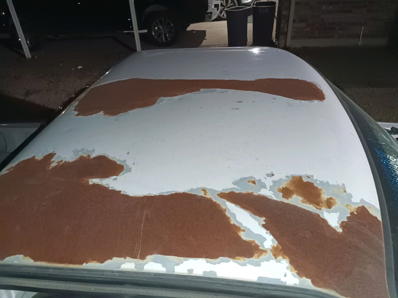

A shop quoted $800 to paint just the hood and roof of this 98 Ranger. That's just not feasible. Am more more interested in DIY solution. I don't have a problem to sand and paint. Is there a spray can manufacturer who makes color matched paints? If not what are your ideas on how you can go about to get this painted. I am prepping the truck for sale shortly.
If I was a potential customer looking at the truck; obviously cost makes a difference too, but a little faded paint or rust, not rot, isn't a huge turn off. Above a certain price point, trying to DIY a paint job with a roller or little paint experience may turn more people away than it would help sell the truck, especially seeing the bed rails with peeling paint too.
Trying to hide issues can cause more red flags than just being upfront. Its an almost 30 year old truck, paint fade is common.
