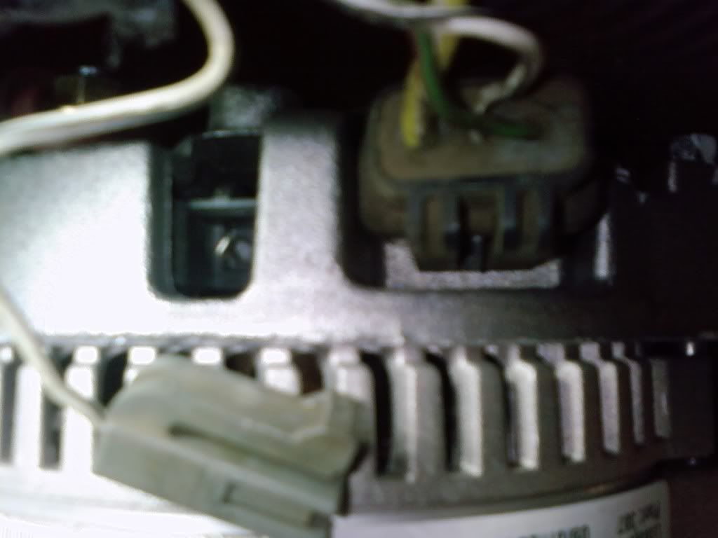

Steps 1: Remove the stator wire by gently prying the plastic tab and pulling the plug.
If the connector is corroded clean it by scratching it up with a pick. DO NOT spread the terminal of the connector more than it already is, that is what caused the trouble in the first place.
How to: Fix intermittent charging from alternators with separate stator wire
Steps 2:
Take the needle nose pliers and put a gentle and very slight twist on the pin sticking out of the alternator.
Put a dab of Di-electric grease in the connector and plug it back in.
Done!
