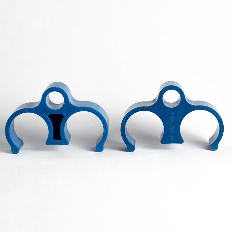

My "factory" lines came with a clip in the middle that I assumed was meant to attach to the coil spring. It looks something like this:
How have y'all mounted your front extended brake lines?
Of course it doesn't fit around the spring...
