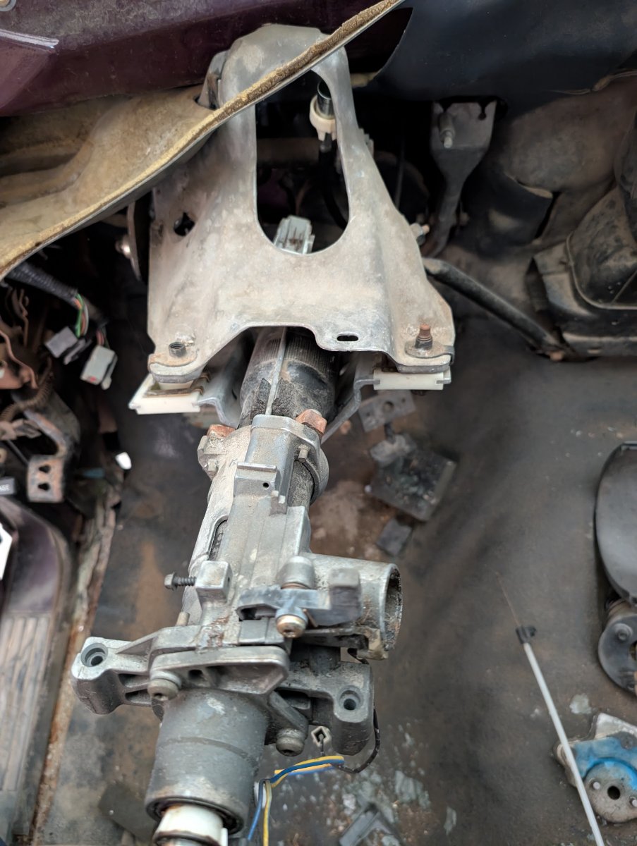

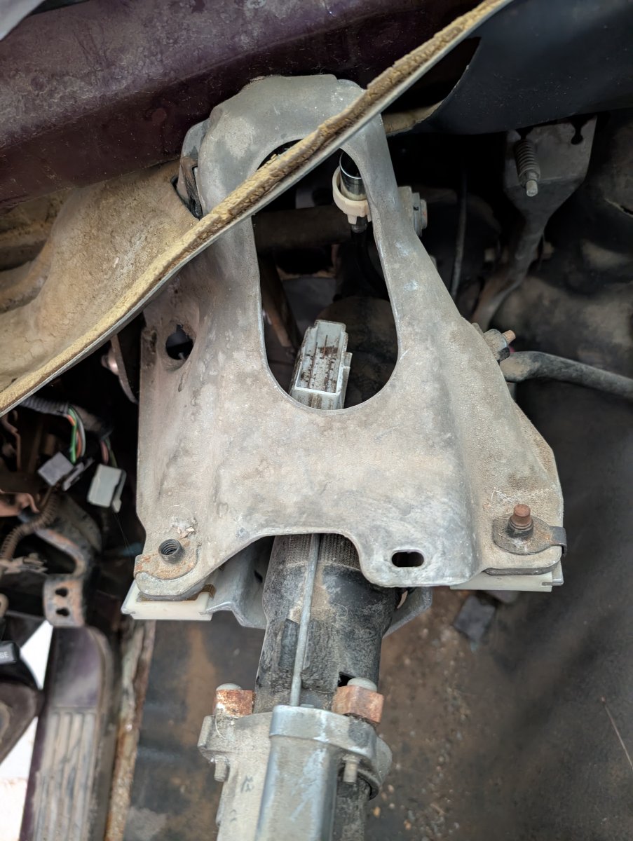

I don't have anything handy. If I go over to my house tomorrow, I'll take pictures. I jave 3 steering columns standing in my living room at the moment. But, it's not complicated. You should be able to see and get your hands on the switch. It is on top of the column, just behind where the ears are for the column mounting bolts.
These pics are of a 93 ranger. You can see the rod running down the top of the column to a recepticle. That is the actual switch location.

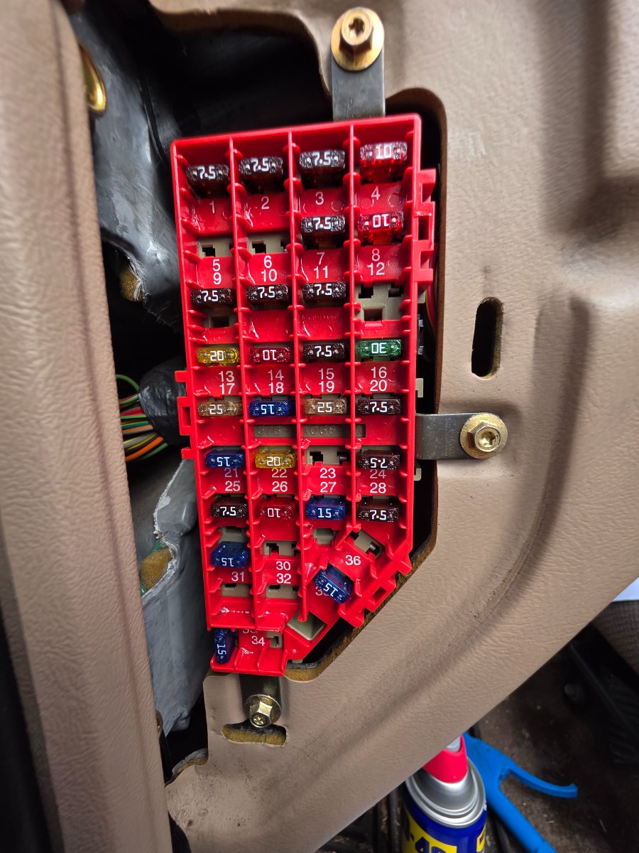

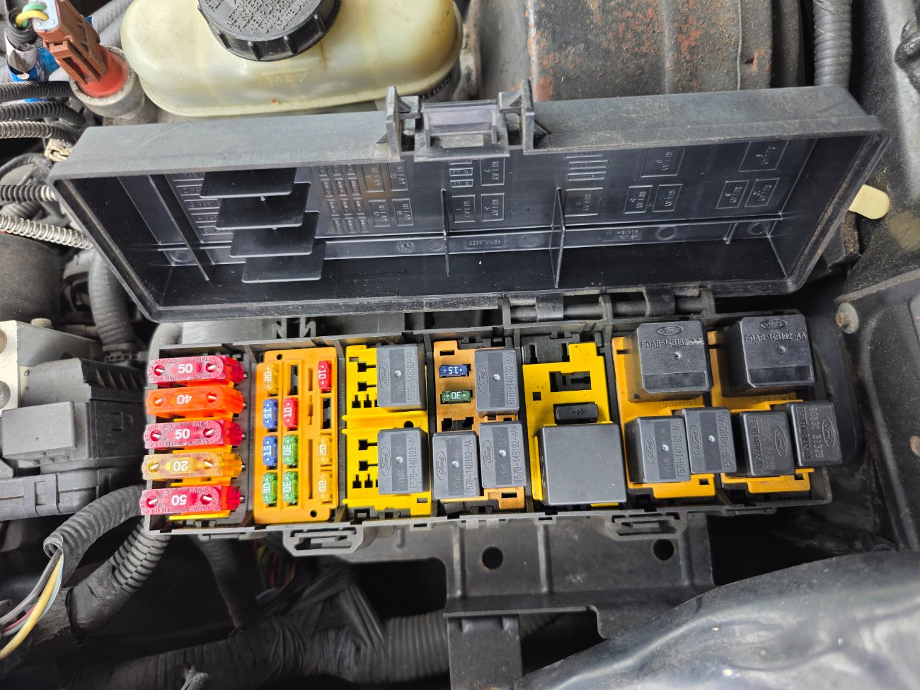

I worked on the Ranger today. The THEFT light was doing its fast flashing dance ending with code 16.
Removed and cleaned every fuse and relay in both the Cabin Fuse box and the under the hood Power Control Box. As I removed each one I shot a little WD40 into the slot and blew it out with compressed air.
I did the Power Control Box first. Tested afterwards and the THEFT light went out as it should. Ranger started right up.
Went ahead and did the in cabin fuse box too.
Attached are photos of what my boxes looked like before I started. They are a bit different from the diagrams I've seen on the web. But match exactly the 1999 Workshop manual electrical diagrams.
Thanks for everybody's help!
